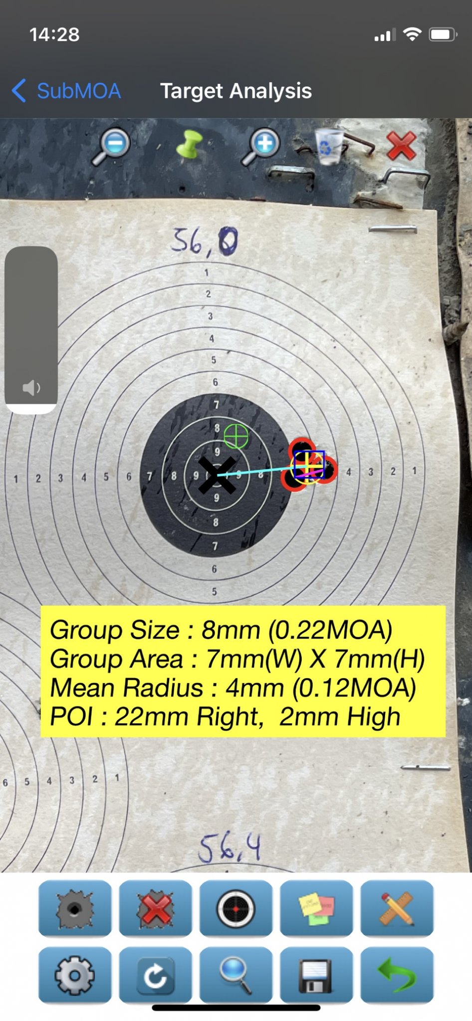

Did a seating depth test to see what my rifle liked with brake instead of suppressor, had some POI shift to the right, but found a load it really liked.

243 Winchester? What does the 56 and 56.4 on your target represent?
I am used to seeing powder charge written like that. But it obviously shouldn't be powder charge weight. :ROFLMAO::ROFLMAO::ROFLMAO:
