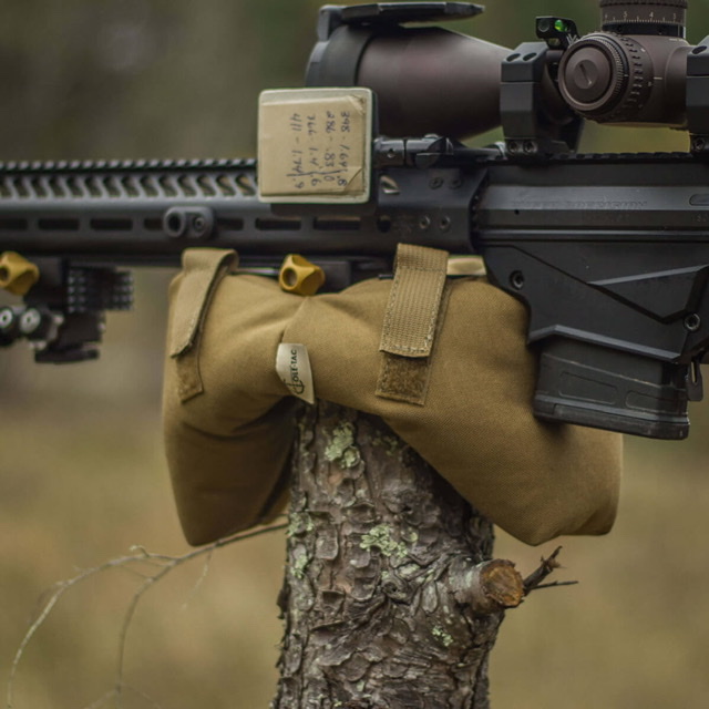

Can anyone also provide feedback on this Cole-Tac Trap Bag?
It looks very versatile and around half the price of the game changer. I can see it being useful as a front and rear bag (from the feedback I’ve seen) as well as barricades.
what would be the downside of picking this?

I'd strongly suggest a Game Changer (GC) over this. I have an earlier version of the bag with its "backbone" setup and find that the GC with my Gray Ops mini-plate is more versatile (and yes, more expensive). Cole-TAC makes good stuff and supports the sport, but, at this stage of your journey, there are better choices.
Earlier posts suggest the Game Changer "Shmedium" with heavy sand fill. While I don't dispute the rationale behind it - I've played with one enough to choose - I prefer the standard GC with whatever its default fill was when I got it three+ years ago. While one of my buddies loves his waxed Schmedium, at least one other got one and quickly sold it because the wax surface held too much dirt for him.
It comes down to individual preference. You're going to try different bits of gear. Some you'll keep. Others you'll sell. I will say this: for me, rifles have come and gone over the four years since I started this silliness, but the GC is still my go-to for at least 95% of rear-support duties, despite my having several bags now (two purchased, others off prize tables, plus the ones I've borrowed to try and returned).
