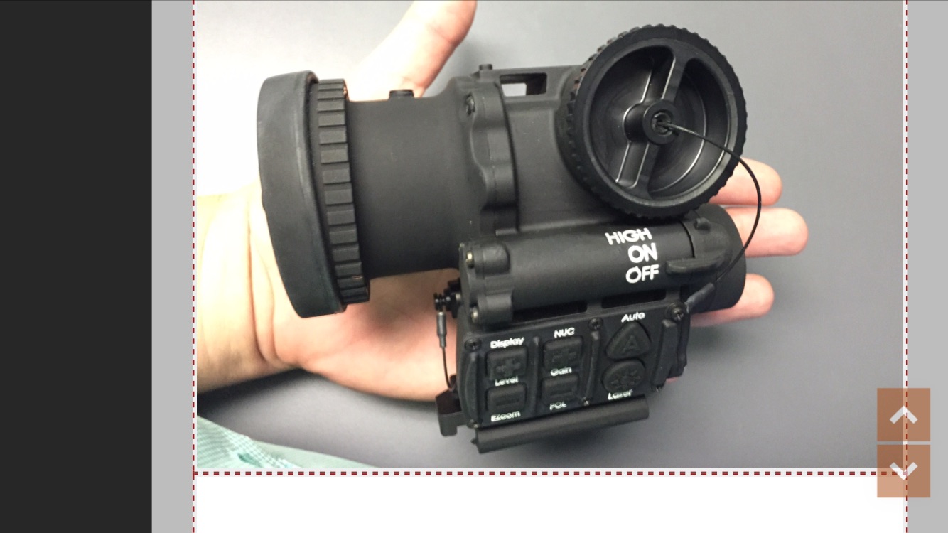

Buy a used t50 for $3000. Can be used clip on or rifle scope and recoil rated up to 50.
What scopes can this be used in front of? Does it have to be a 1x or red dot type optic? Or can it be used in front of variables?
This was supposed to be a response to the post above about the T50, I didn't get it to quote for some reason.
So to start off I purchased a Pulsar Quantum XQ30V for scanning. I got a good price on it and after plenty of video watching and research I think it will work well for my needs. I have my eye on the Pulsar Apex XQ38 or possibly the Trail XQ38 but not sure if the Trail offers anything for me since I don't really have a desire to record and will use it infrequently enough to get by just fine with batteries. I am going to search for higher end used thermals for a bit first then search out a deal on one of the above mentioned.
I used a t50 in front of a nightforce 2-10 for a couple years. It works great and has a quick start up time. You can push it to 400yrds if conditions were perfect but I think 200yrds and in is where its most comfortable

But the t50 for $3k is not a bad deal, just understand that you won't get much magnification out of it and if you day scope minimum magnification is over 4x then the image might be a bit fuzzy.

How good are these or are they kind of meh? And where are they for 3k? I thought the T50 was one of the 'better' milspec thermals?
Sounds like this would be ideal for the 3x ACOG.
In my research is seems the T50 was mostly made for the ACOG.
They pop up for 3-4k from time to time. They are the best clip on in that price range.
Yeah I'd be in for a T50 that is correctly culminated (not the LEO trade in ones with issues) for 2500-3k.
You have any more info on the LE trades ins with issues. How do you identify them and what are the issues.
I don't but I'm sure someone on here does.
I was basically told to beware of them as they only work at 1x and have problems at anything past that. How do readily ID them, I haven't found that out yet.
