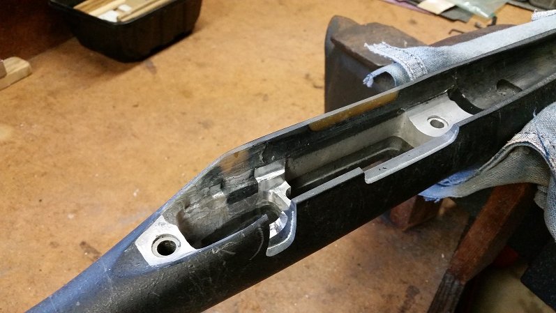

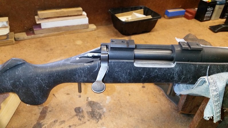

Here is something similar. I filled in the bolt notch on a LH HS Precision stock and recut a right hand bolt notch and loading port.
