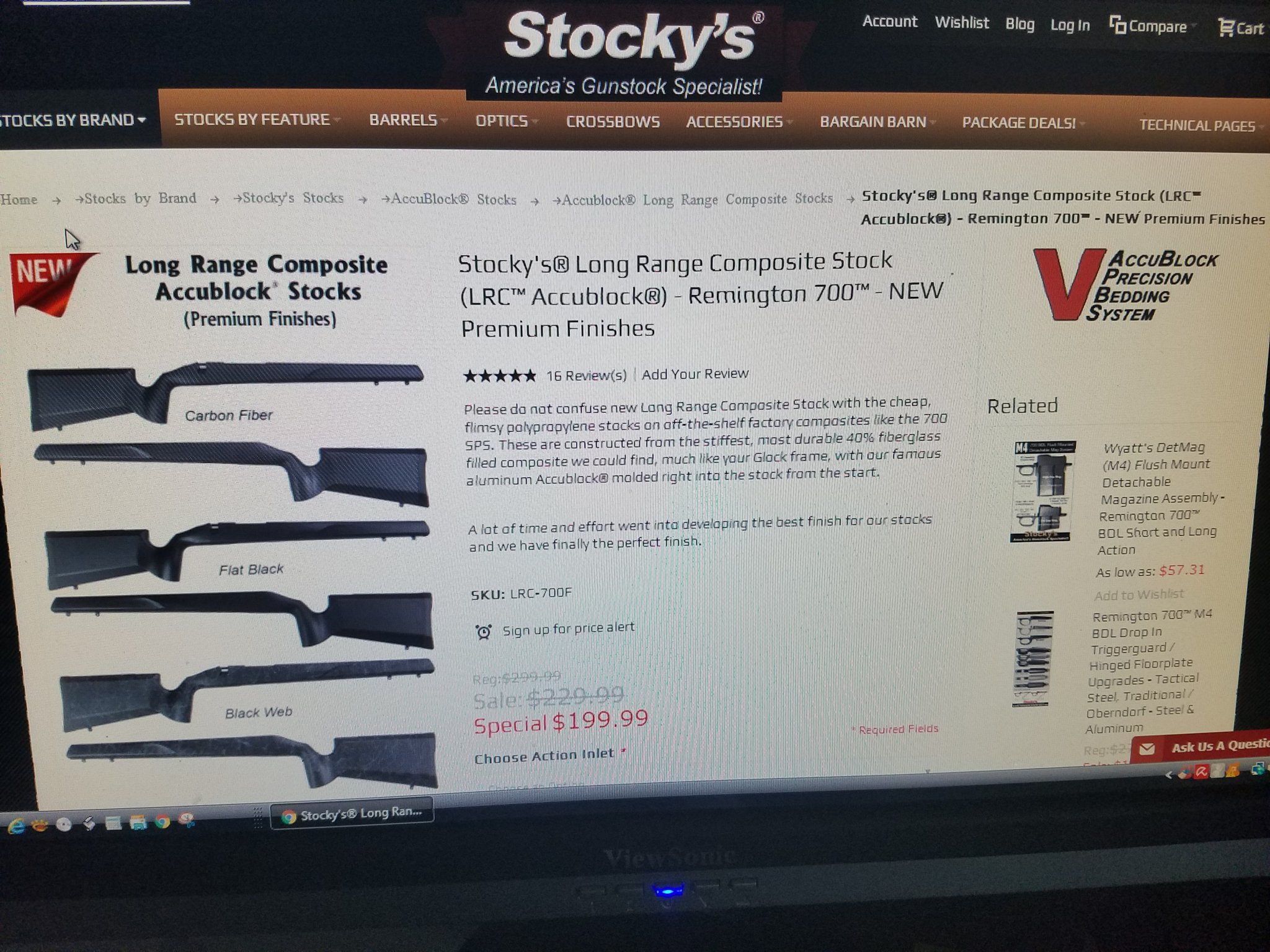

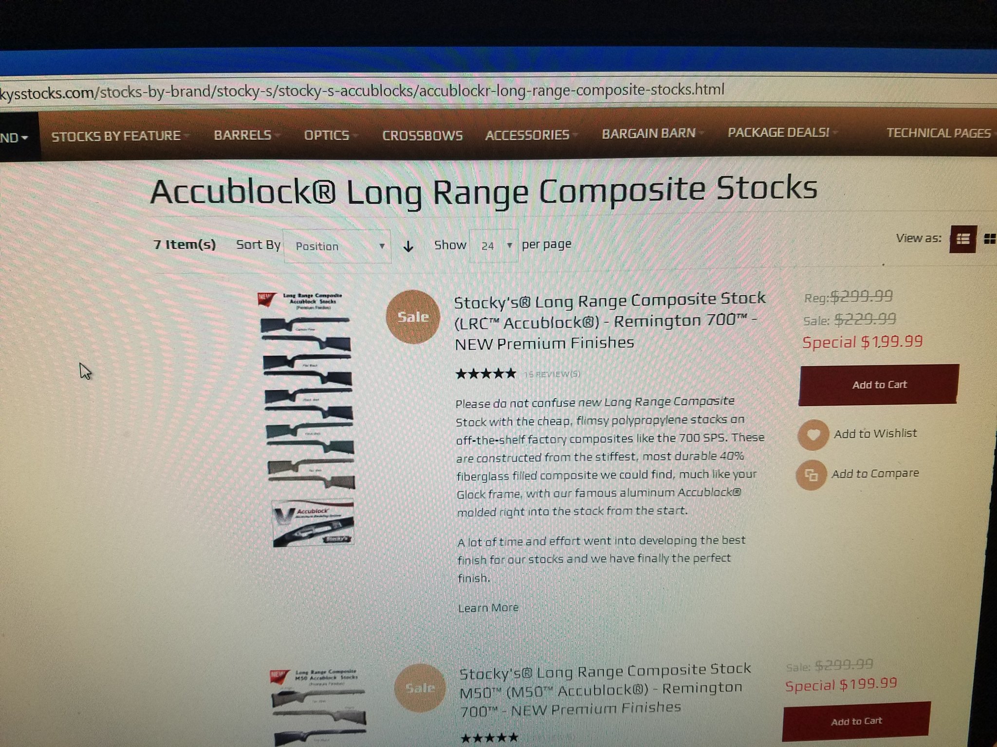

I can not speak from experience but have you looked at stocky stocks? They make their own now and are comparable.

Stocky's are a decent Stock for the price point. No bells n whistles, but easy enough to correct any LOP or Cheek Weld issues if you happen to have either problem.

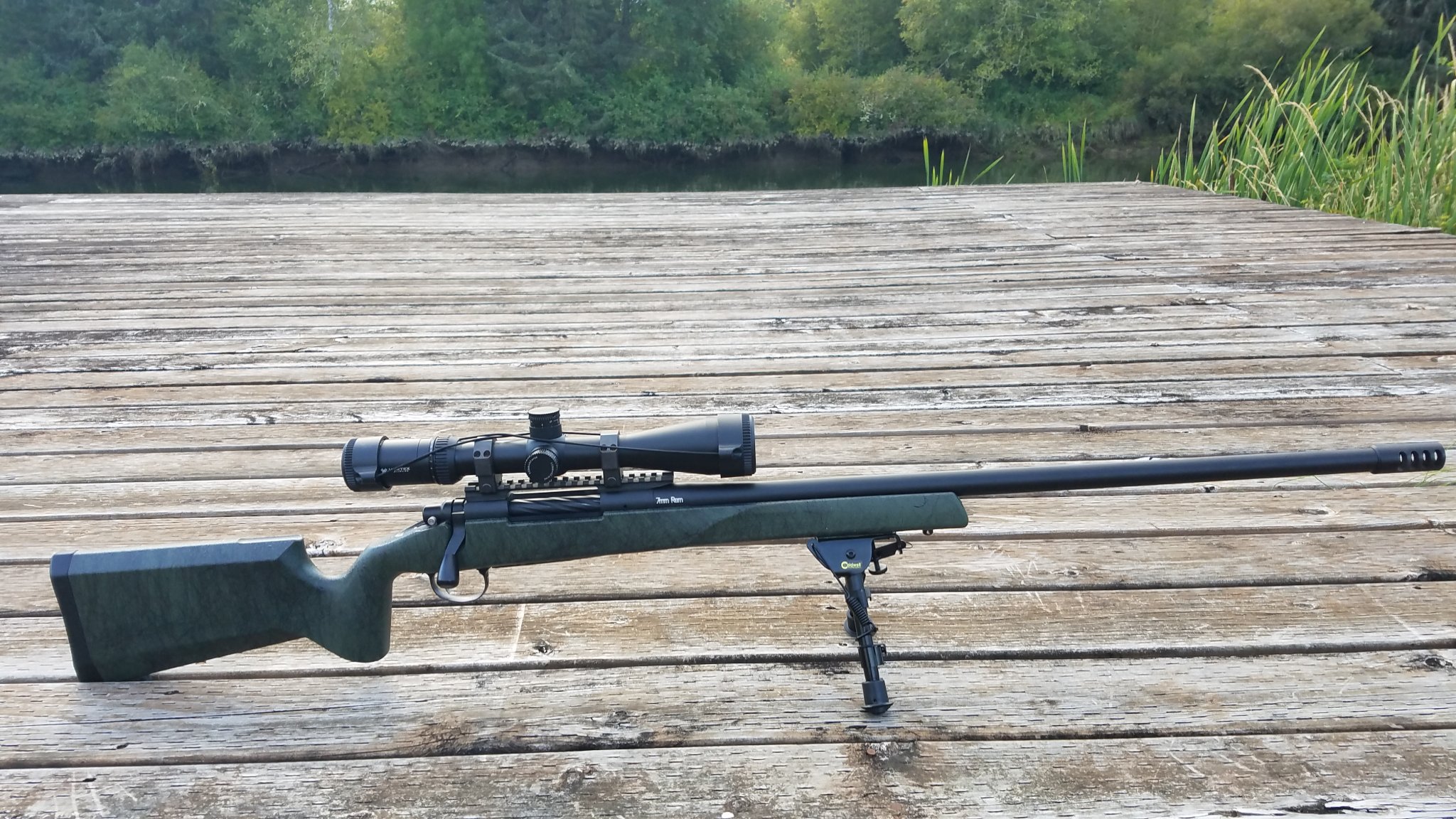

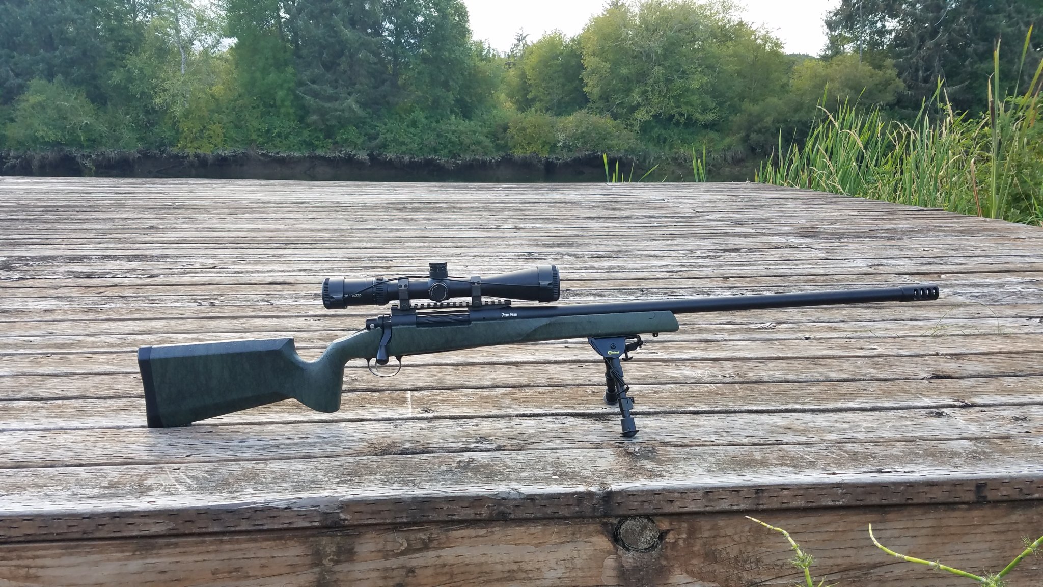

Nice rifle. May I ask what stock brand and model that is. Kind of looks like a Bell & Carlson, McMillan, or Manners, in a style that I like. That grip works well for me too, from what I have sampled.
Phil
Here you are. Check out Stocky's website. They may have what you're looking for without breaking the bank.
No worry. Thanks for your suggestions. Scarcity of stocks for Howa is no surprise, but better than it used to be. B&C, Manners, McMillan, MDT, XLR, KRG, etc., all make stocks or chassis systems, but often times with limitations on models, colors, and magazines. They also seem to be lower end or high end, with not much in the $600 range. If B&C made the Target/Competition stock ($395) with adjustable LOP (spacers) and sold it for $500 or, I'd be all over that.

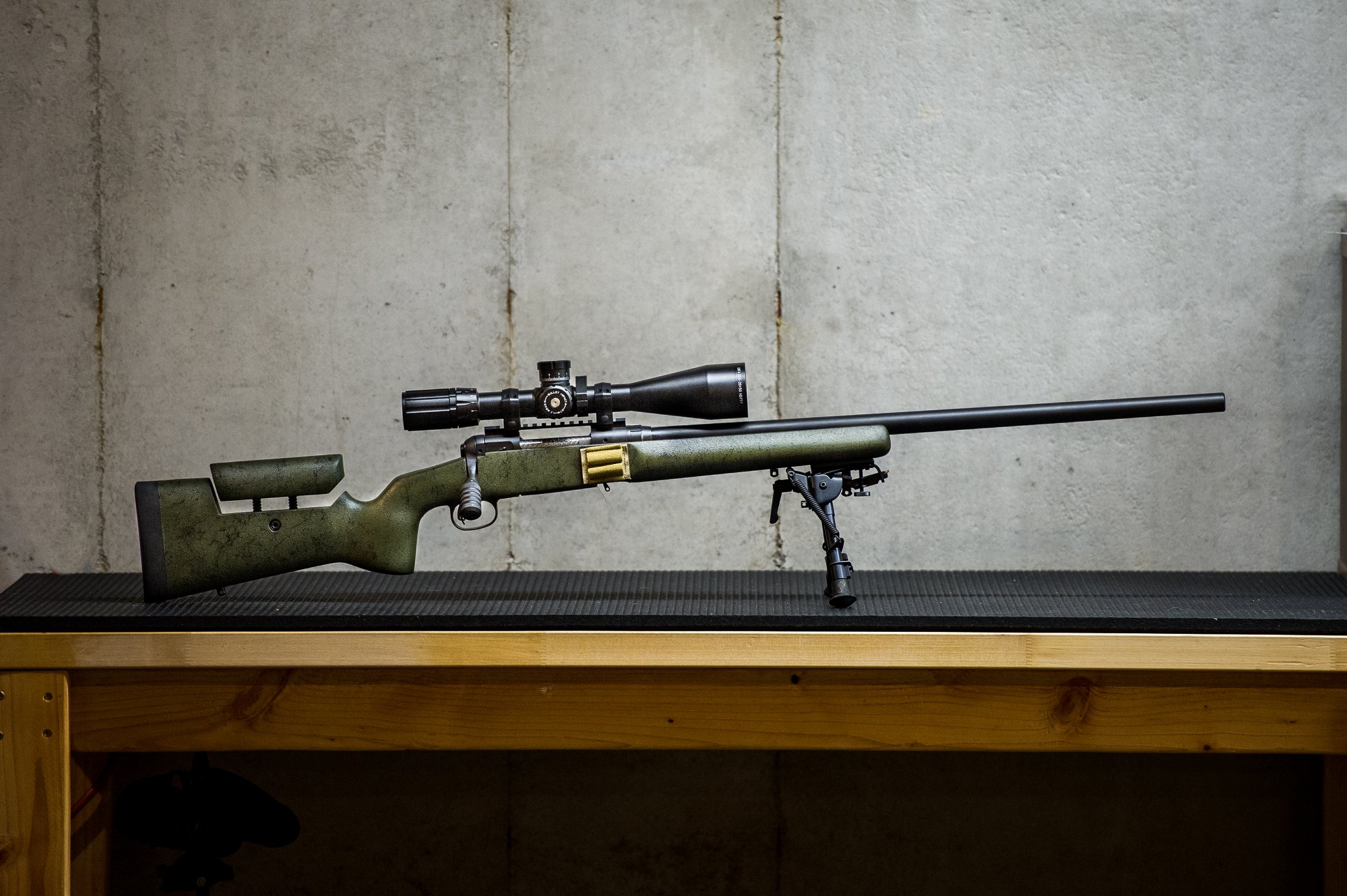

I had that b&c stock on a 20" Howa varmint contour barreled action. It is a very nice stock, no it's not a manners or mcm, but it's also 400+ cheaper. Not sure where 308 pirate is going, but I've not saw any fitment or qc issues with b&c. I did skim bed the bedding block, but probably didn't need to. I used the metal bdl howa bottom metal and it dropped right in and fit tight.
I have one on my 223 Savage.
Dropped right in, no modifications or inlet changes at all. I dont know what contour savage uses on their heavy barreled stuff but If I recall correctly its right around .900 at the muzzle, its a fairly straight taper contour.
Its a GREAT buy at $395. I dont know that you can get anything that rivals it for the price.
Full aluminum bedding block, great fit and finish, and an adjustable cheekpiece.
It is quite a bit lighter than my Manners are.
It has the same general shape as my T2A does but definitely feels different in both weight and the grip.
For any budget builds this will definitely be my go to stock though. Absolutely zero complaints with the stock at all.

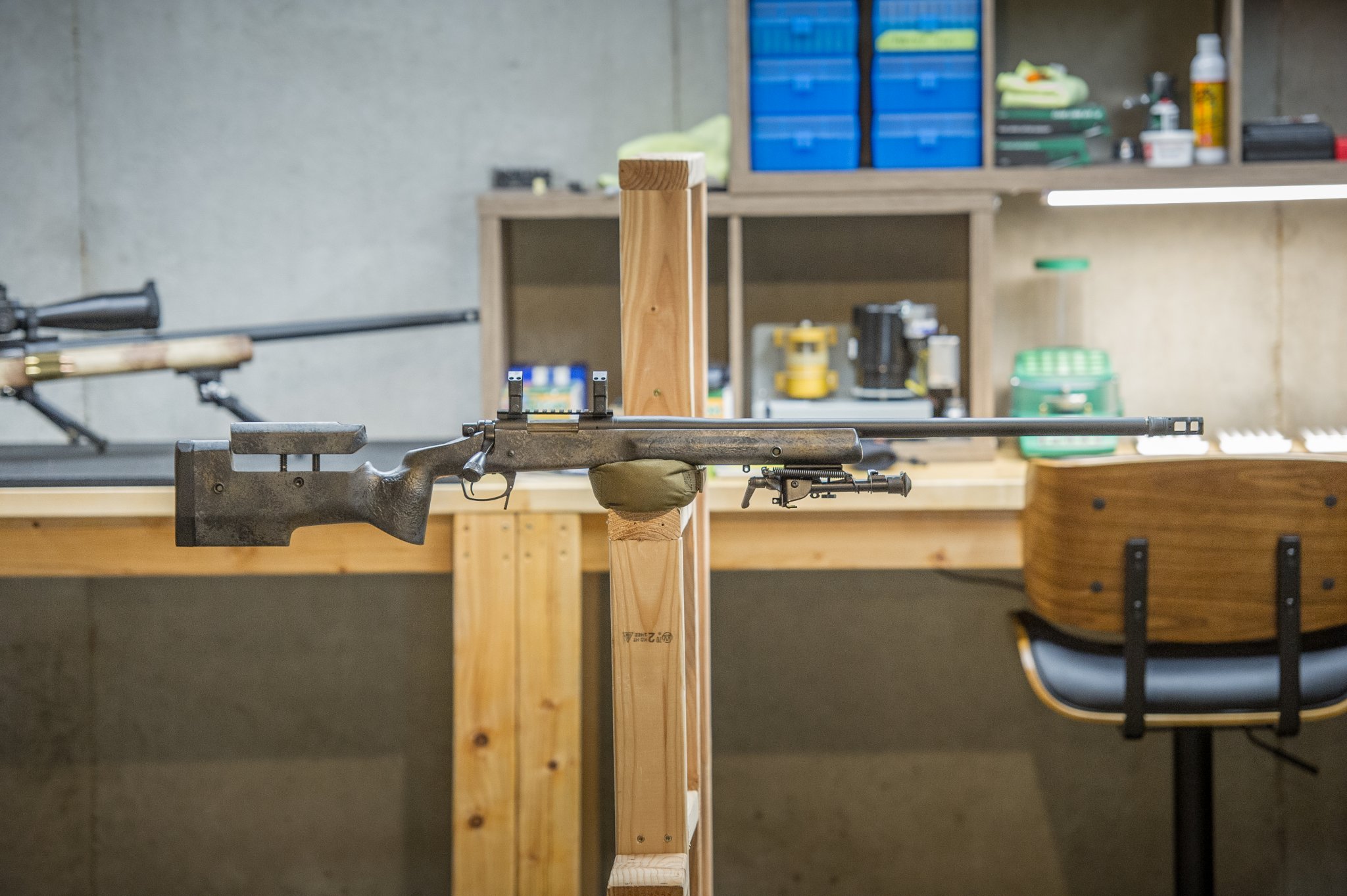

I have a Shilen S7 heavy varmint profile on my B&C comp stock and there is plenty of room, you should not have to do any relieving. I really like the stock for the money. Got a good deal on some PTG bottom metal that was blemished and haven’t looked back. I have several B&Cs and for the money, I really like them. I installed flush cups and a seekins rail and made it even more versatile.
Reactions: Classyredneck00
Thanks for the barrel fitment tip...I appreciate that. That barrel looks plenty hefty, and doubt I will have any issues.
