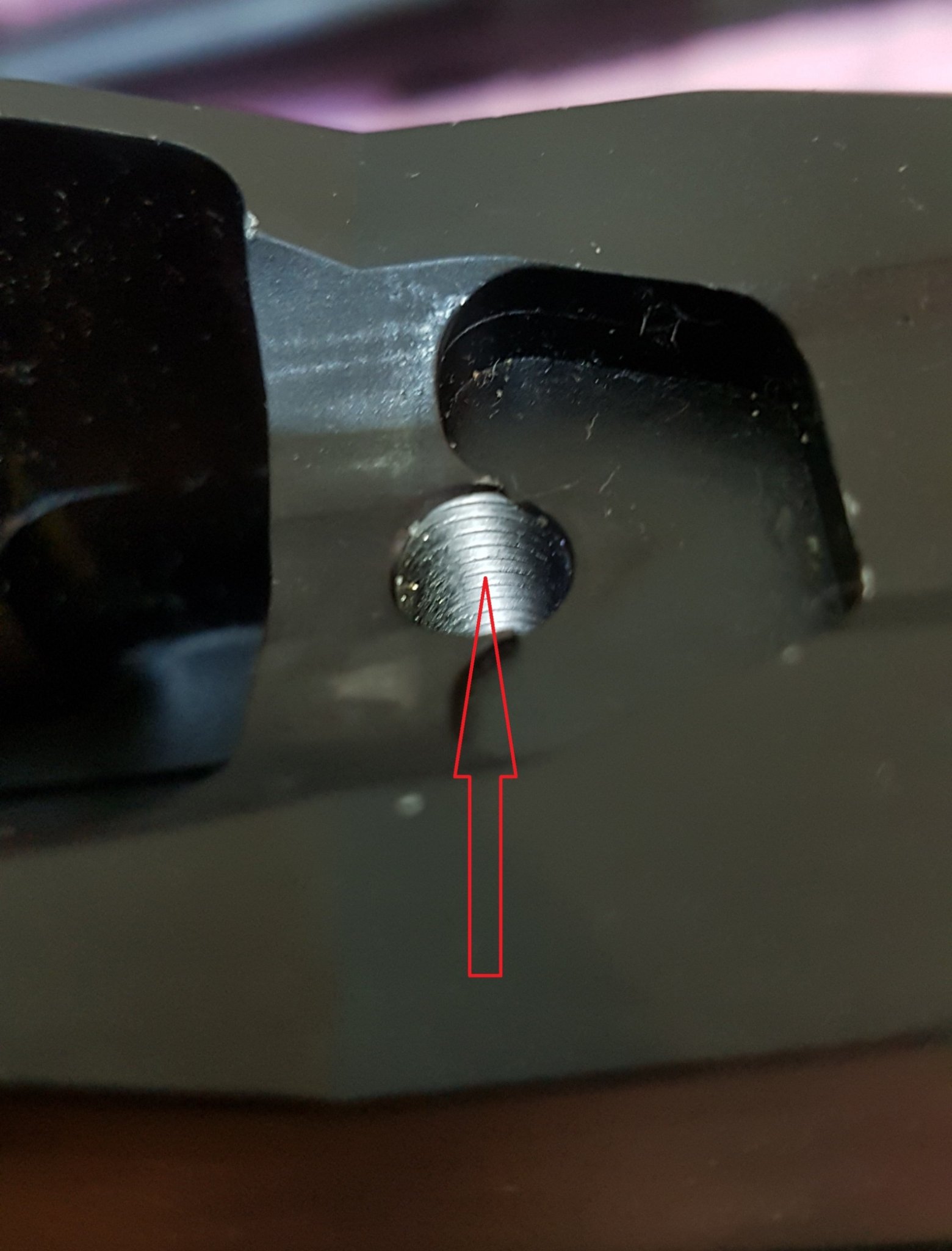

I use the chassis "XLR element".
Bent receiver "jumped" in the bed chassis, and the rear screw touched the wall of the hole.
Now the receiver is in the chassis steady.

But action screws shouldn't be contacting the hole through the chassis, no different than making sure they have clearance through pillars.

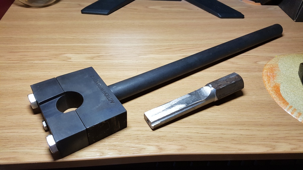

Thanks for the reply and attention!
If not difficult, look here:
it was bend:
so after correction:
what do you say?
I'm at a loss as to figure out how this could happen unless the action wrench's torque was somehow applied at the bridge of the receiver. What sort of tool did you build to bend it back?
I think that the gunsmith used aktion wrench of poor quality or just did wrong.
To turn it back, I used a Wheeler action wrench #2 to clamp the front of the receiver, and a self-made internal action wrench to turn the back of the receiver.

Thanks for the reply. It makes more sense now. It makes sense how it happened. It doesn't make sense that a "gunsmith" would handle an action in that manner in the first place. Thanks for sharing.
