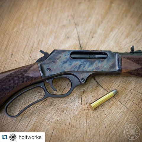

Henry is making some pretty cool 45-70's these days. I can't tell for sure what kind of accuracy to expect but from what I've seen out of their big boy rifles I'd say 200 yards is not out the question
