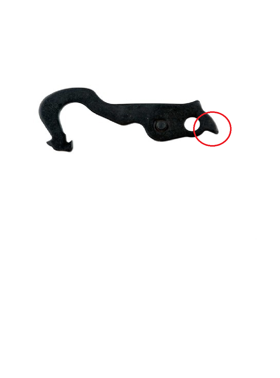

Here are the possible problems -
Your hammer pin is bent or out of spec. If it was bent or out of spec, the hammer would not rotate completely smoothly either. As well as make the hammer sit ever so slightly crooked which prevents it from working with the plunger.
Your hammer is either broken or was machined improperly. The portion circled in red is what interfaces with the shell release plunger. When you press the trigger the hammer drops/rotates and that lever portion/hook (circled in red) is what pushes against the rear ledge of the plunger (the side where the plunger spring sits) which compresses the plunger spring, retracts the plunger allowing the lifter to drop into place.

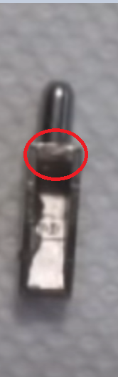

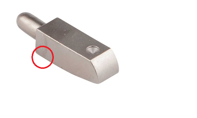

Because you can manually hit the shell release plunger which releases a shell and drops the lifter without any binding I'm assuming, it's also possible the plunger itself is out of spec. The rear ledge either being damaged, too short in height or thickness and the hammer lever/hook is just pivoting above the plunger or inside the recess without ever making contact or not making enough contact.
