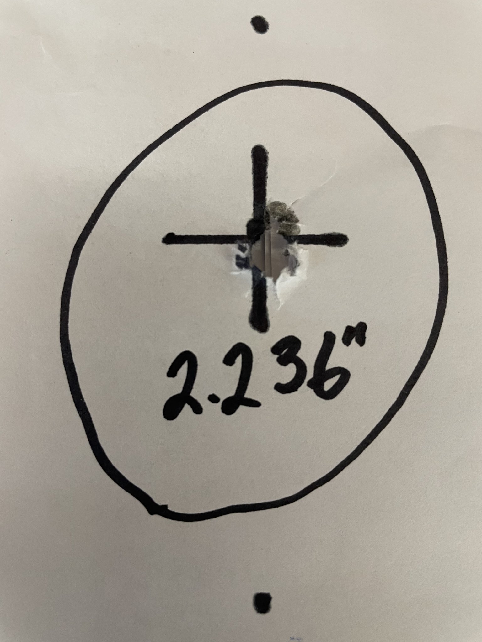

    Shot this with Franchi ME with adjusted Remington 180gr CBTO 2.236” last Sunday. Chamber measured 2.243” with Hornady Comparitor.
