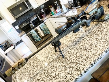

I recently received my new Bergara b14 HMR In 6.5 creed and I've received a ton of questions from people about it, but haven't seen much on the web outside of shot show coverage. So here's my rifle, and I'd be glad to answer any questions.
A couple observations....
The stock, though it is very reminiscent of a manners etc, is no where near as beefy, you can flex the fore end without a ton of effort. But it is quite comfortable and the adjustments are easy and solid. I probably won't change the stock until I rebarrel it and need to make room for a barrel nut.
The front sling studs are a little farther apart than most, about 3.2" and will require an Accushot BT17 rail (waiting on mine) to mount an atlas bipod or any other pic mounted bipod.
i put a timney 517 in it, with zero issues. They say the stock trigger can only adjust down to 2.8 but it felt really good to me out of the box, crisp with no creep. If I didn't already have the 517, I would have let it be.

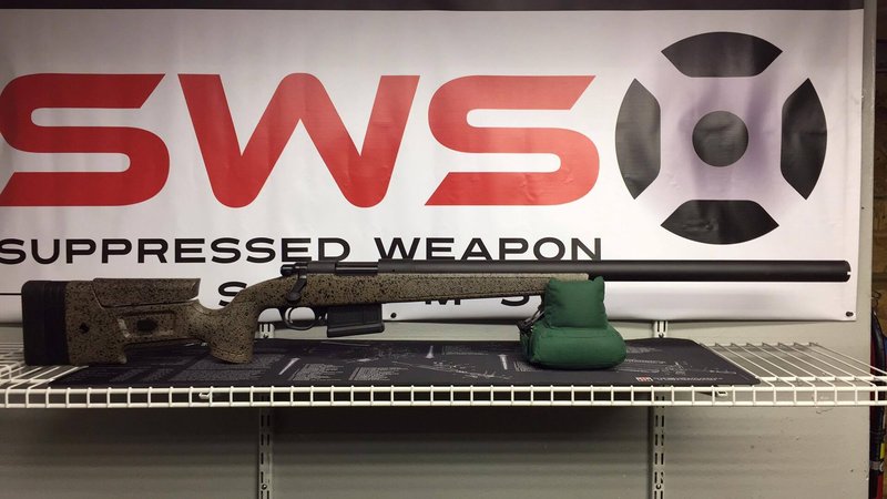

I also picked one of these up... currently fitting one of our MISB barrels "1.25" to it.... I'll have it at NRAAM.

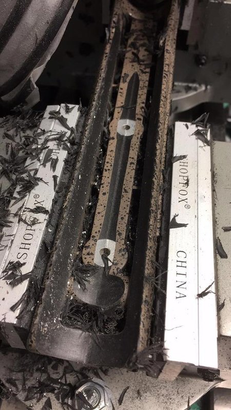

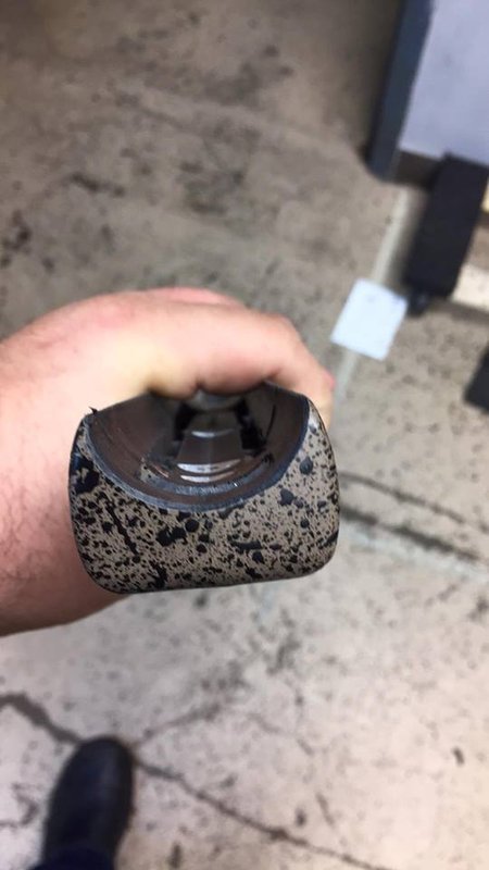

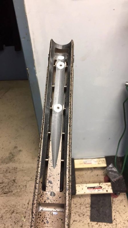

i assume you had to inlet the stock for that, how was that being polymer and all?
We were more concerned about digging into the flushmounts and aluminum. But it turned out pretty well. Still has some finishing work to be done. I'll post finished pictures when I have them.

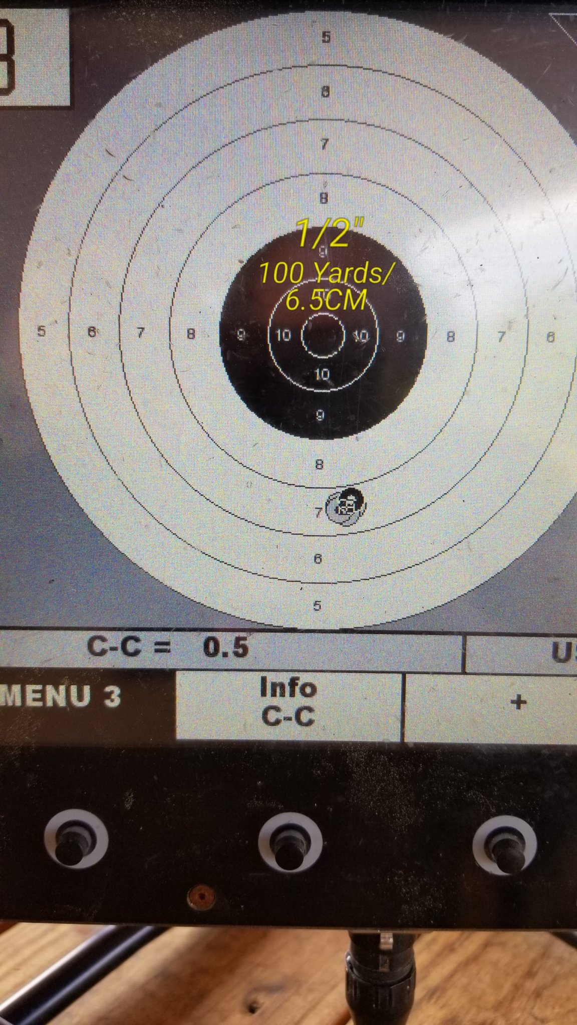

Someone asked for how the groups looked on paper. They look like this at the CMP range in Talladega.
