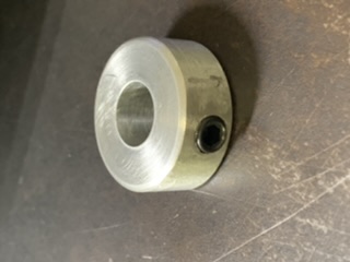

    Hey guys! I know this is a dumb question and I can get all my measurements when I get home but kind of want to hit Granger on the way home. Does anyone know what the cheek riser rod diameter is on a Bergara B14R? Want to make a zero stop so when I pull the cheek riser off I’m not messing with trying to set the height again when I put it back on. Thanks in advance and yes I know I’m a dumb ass for asking!🤣🤣🤣
    I made this because I was bored…

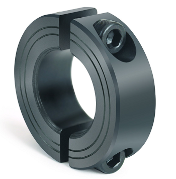

    I also ordered a few 10MM split collar couplers for shits and giggles.

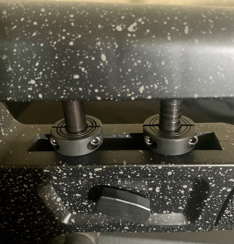

    All done. I ended up using the Climax 10mm Split Collars smooth side down. Very pleased for $25.00...
    As a side perk they help with side to side wobble with the cheek rest up high like I have it. I'll be doing this to my MDT ACC as well!
