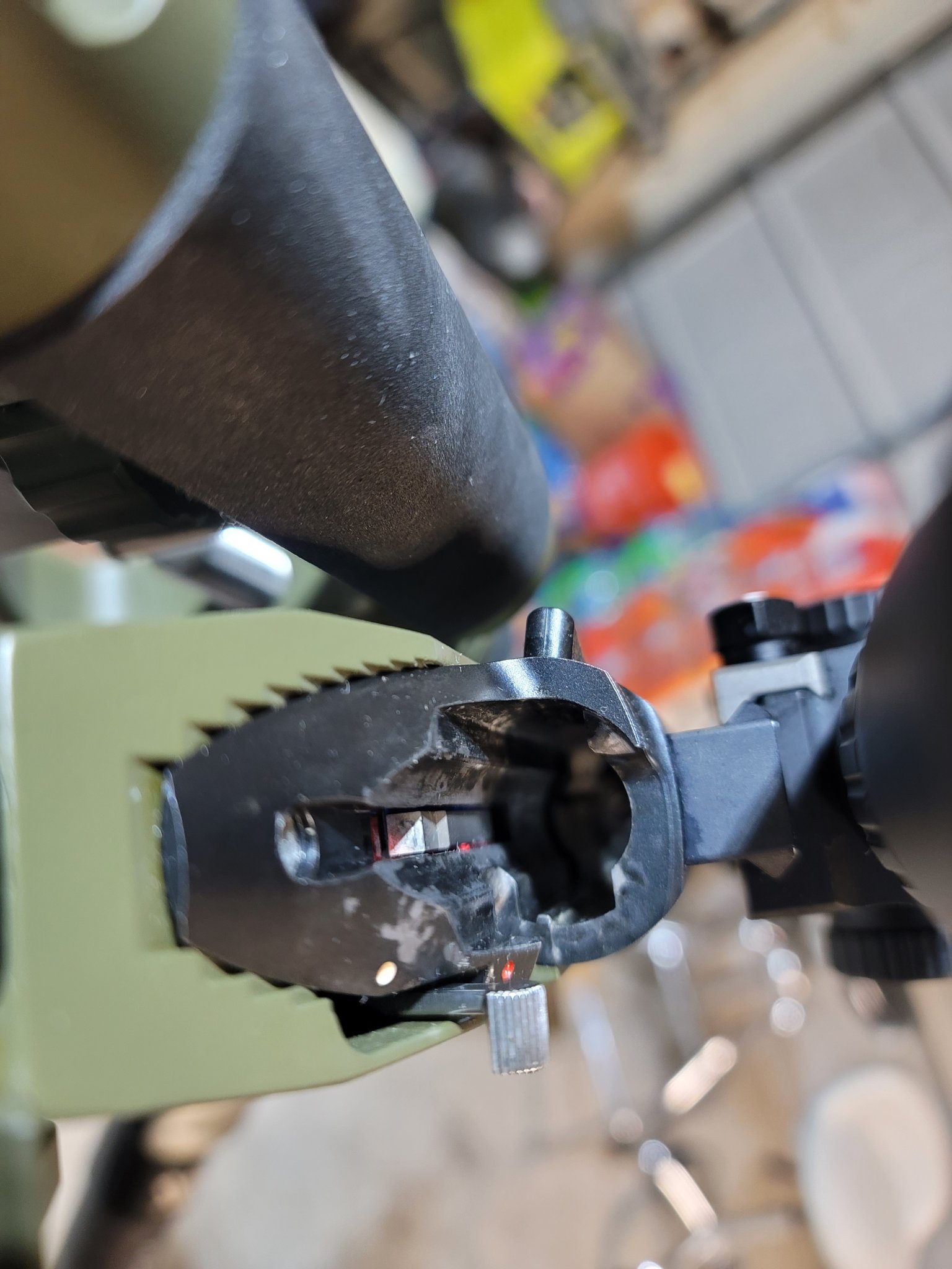

im having issues with my bergara b14r. The first round is always a flyer. I tried several different ammo lapua,sk, eley and their varient. I just got the bore scope and took some pictures. I sent it to bergara a few years back and they said they re crown it but the flyer is still there. Do you guys think this could be the problem?

Are you getting the flyer from both a clean bore? Does it happen with a bore that's freshly fouled by previous shots?
If it happens when the bore is clean and unfouled, that's not unusual. If it happens after the bore has had rounds go through and allowed to sit for a time, that's not unusual either. If it happens when the bore is freshly fouled by previous shots, then there would be a problem.
First shots through a clean bore are usually faster than those that follow. The impact is usually high. With fouling that's had time to dry, a similar thing happens.
As a clean bore becomes fouled and evenly lubricated with successive rounds, POI should be as it should be within the limits of the ammo being used.

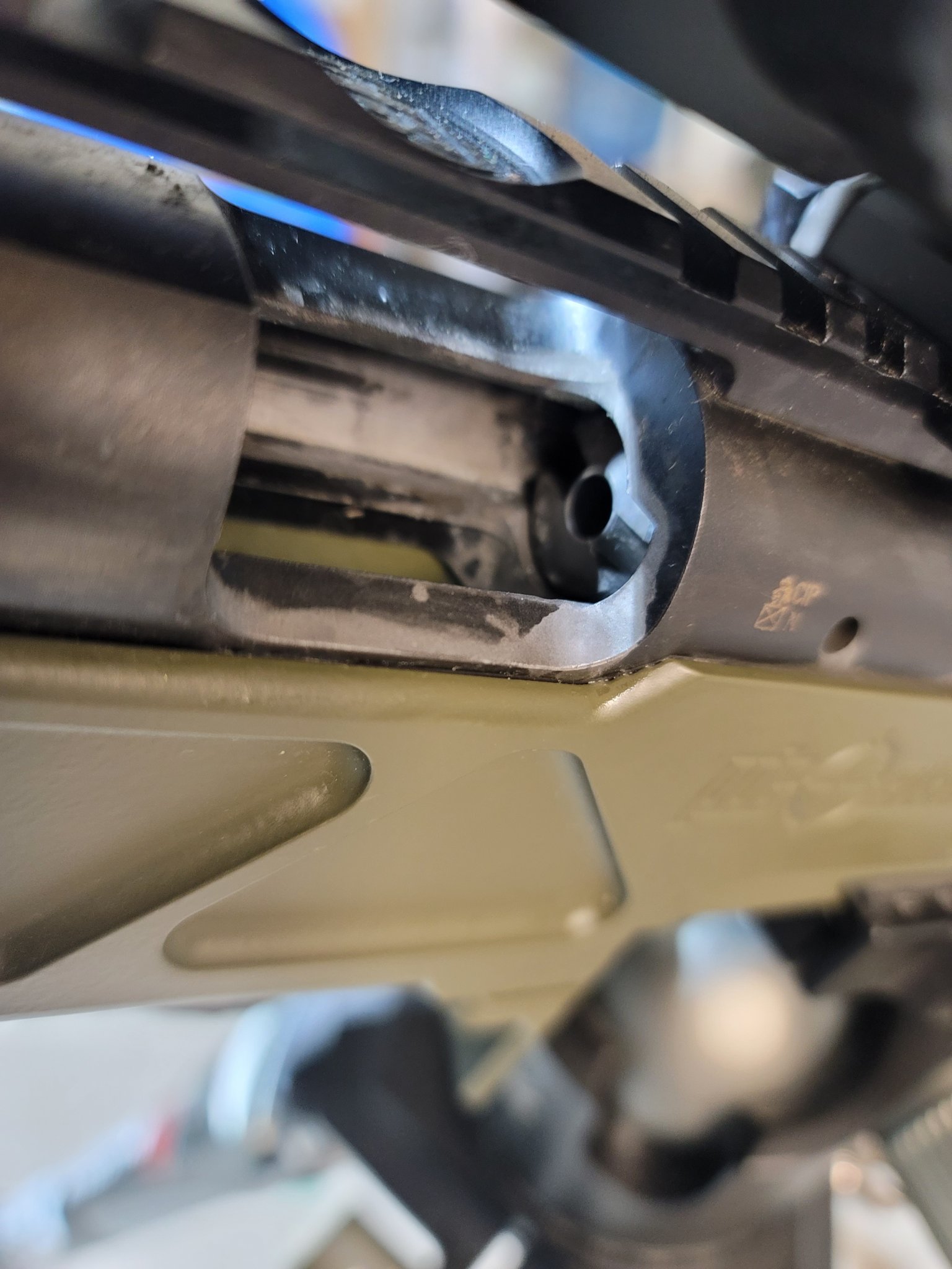

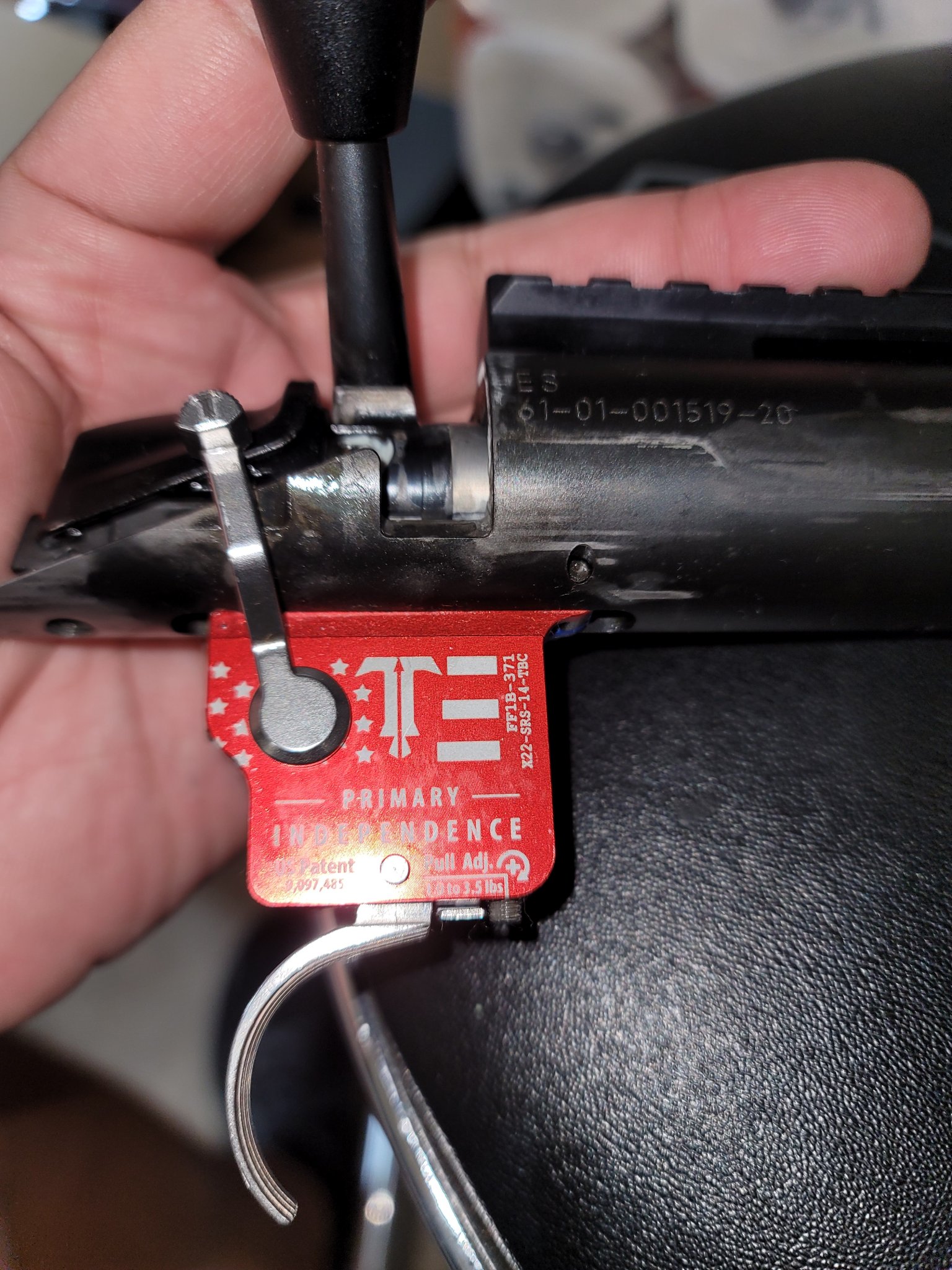

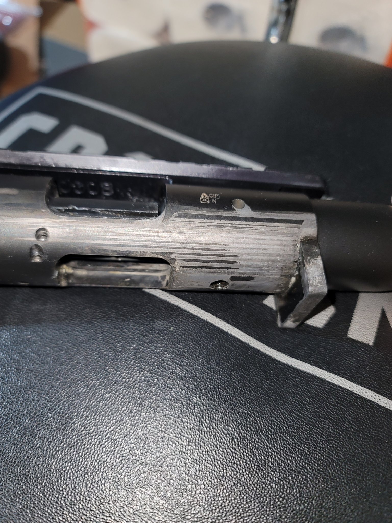

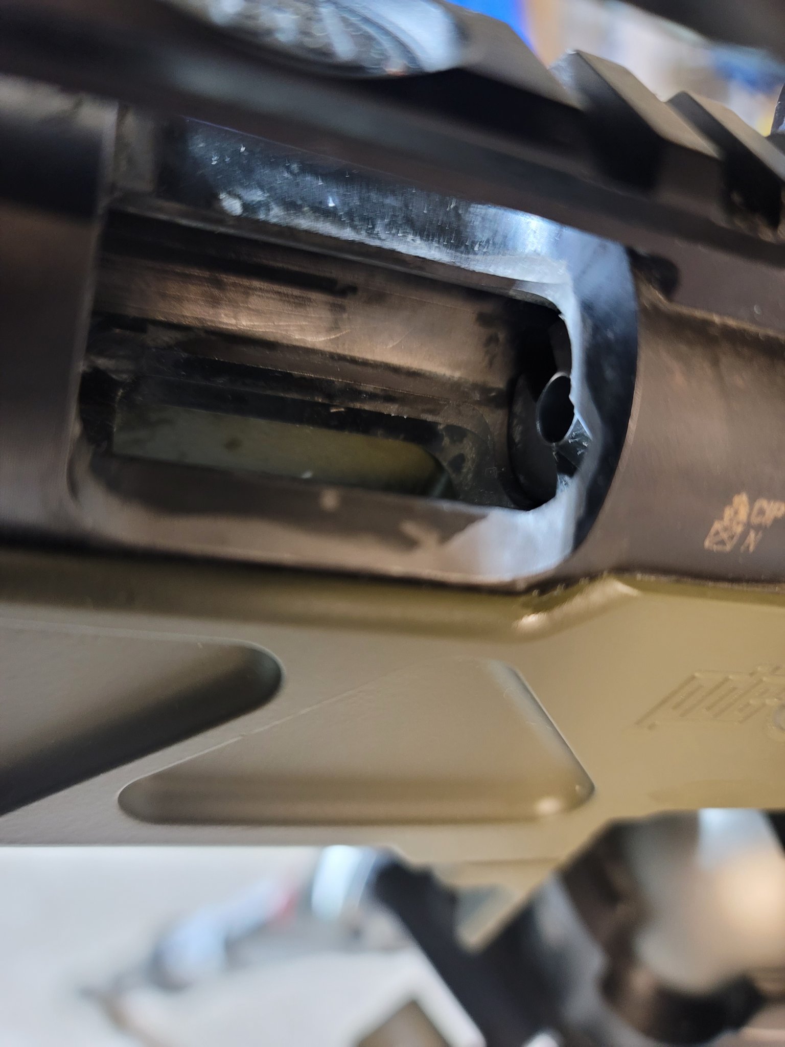

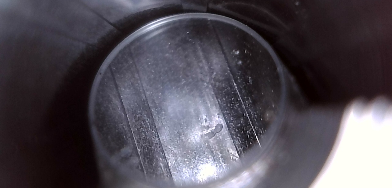

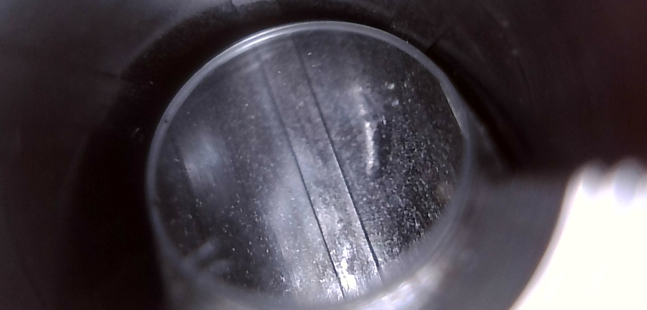

To make things worse. I just finished cleaning with CLR and it ruined the paint inside the receiver. This cant get worse. I didint know CLR could do thet.

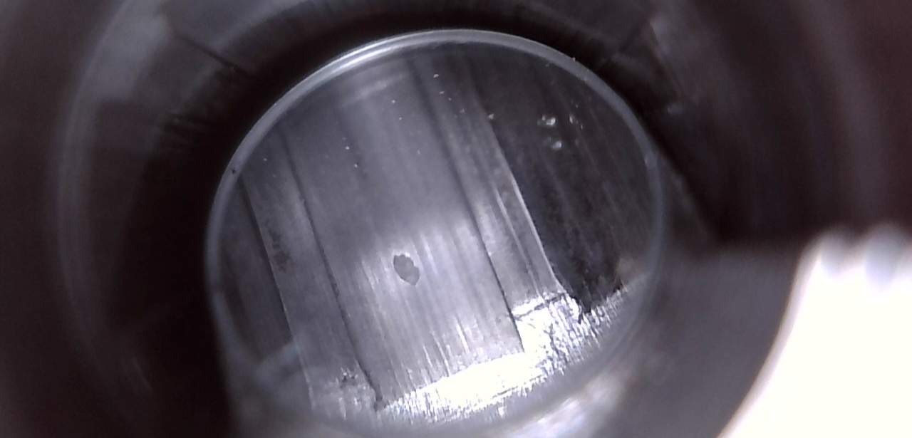

Carbon ring forms right where the bullet leaves the brass. Reason for a first round flyer is the carbon is hard and after the first round it softens so that subsequent rounds shoot normal. Then when you let the rifle cool the carbon ring hardens again.
It's hard to get rid of unless you're focused on cleaning that out. You need boretech c4 cleaner to do it. Rimfire blend won't work. Soak the ring for 15 min then nylon brush it.

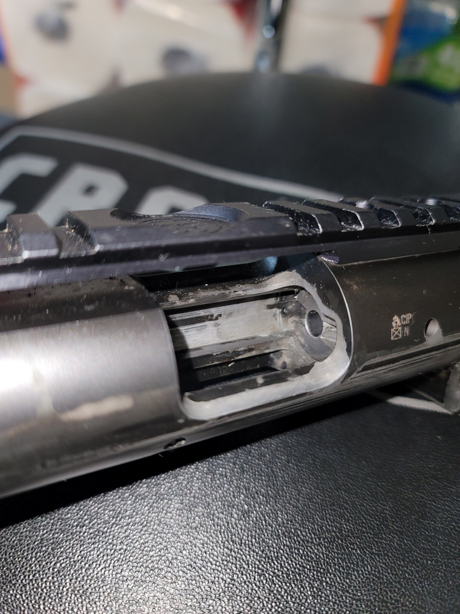

I ran clr thru it and ran some ioso bore cleaner. I didint see a carbon ring but still cleaned it. The problem now is that the clr are the bluing off the receiver. It sucks
HAHAHA!
CLR is designed to remove Calcium, Lime and Rust.
Bluing IS rust.
It's rare that you can just touch up the de-blued parts and make it not noticeable. You will need to CLR the entire piece and rust blue it again. It's not real difficult to do.
Or you can prep it and paint it or powdercoat (Cerakote) it.

Yes. I just finished stripping it down just need to remove from barrel and then re blue it but thnking of rebarrel it.

I have run into this issue with other rifles with detachable magazines. Does the first-round flyer occur with different magazines?
Some people will agree or disagree, but I've observed magazine pressure against the bottom of the bolt shift POI on a lot of semi-automatic rifles and a few bolt action rifles over the years. If you have more than one magazine, it's worth experimenting.
A few rimfire benchrest shooters at my club are very knowledgeable about barrel cleaning, much more knowledgeable than me. The top shooters do not clean the entire length of their barrels unless they change ammunition. One of the top shooters advised me to pick up a plastic 6mm brush to clean the chamber as needed and not clean too much forward of the chamber. He told me that unless a carbon ring is affecting accuracy, I should not clean the barrel.
I did notice that after thoroughly cleaning the barrel on my Savage MKII, I have to fire 30 to 40 rounds before the groups shrink back to what I normally see.
The problem persist with magazine or sigle feed. I heard it was barrel break in. This barrel has 2k rounds most sk rifle match but also eley and lapua. I tried everithing. I cleaned with CLR to remove all carbon and the finish ruined.

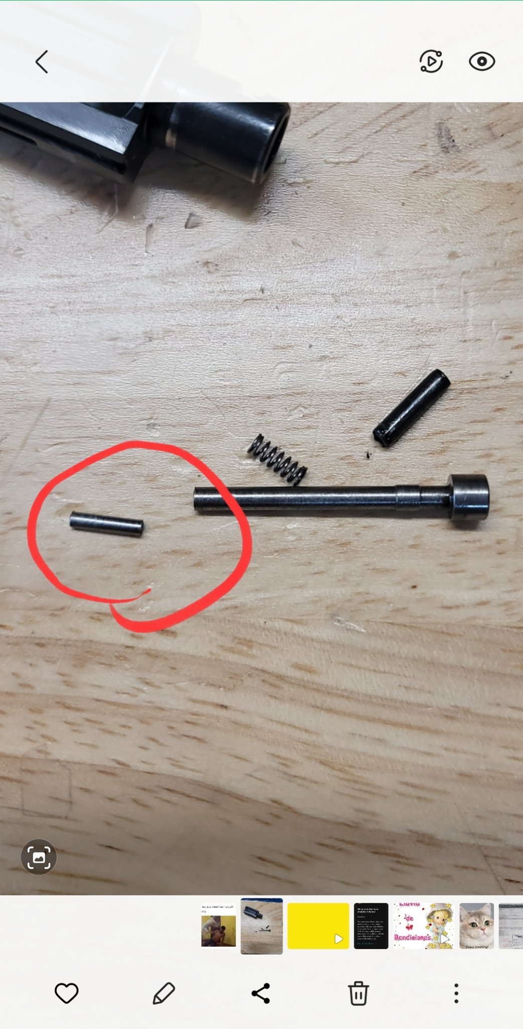

I havent gotten the firing pin back from bregara as soon as it gets here im going to test it out

The firing pin was broken and now i thoroughly clean the barrel and i got rid of the first round flyer
