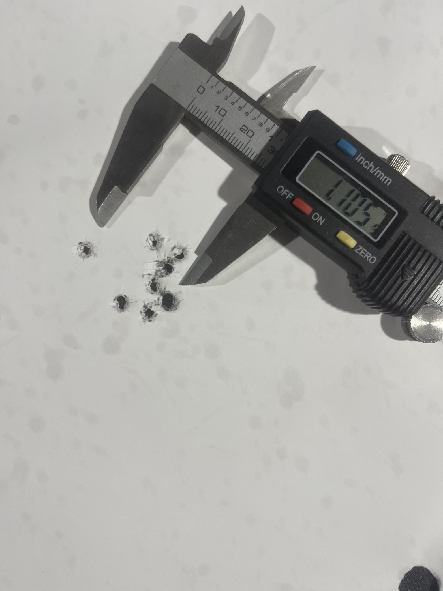

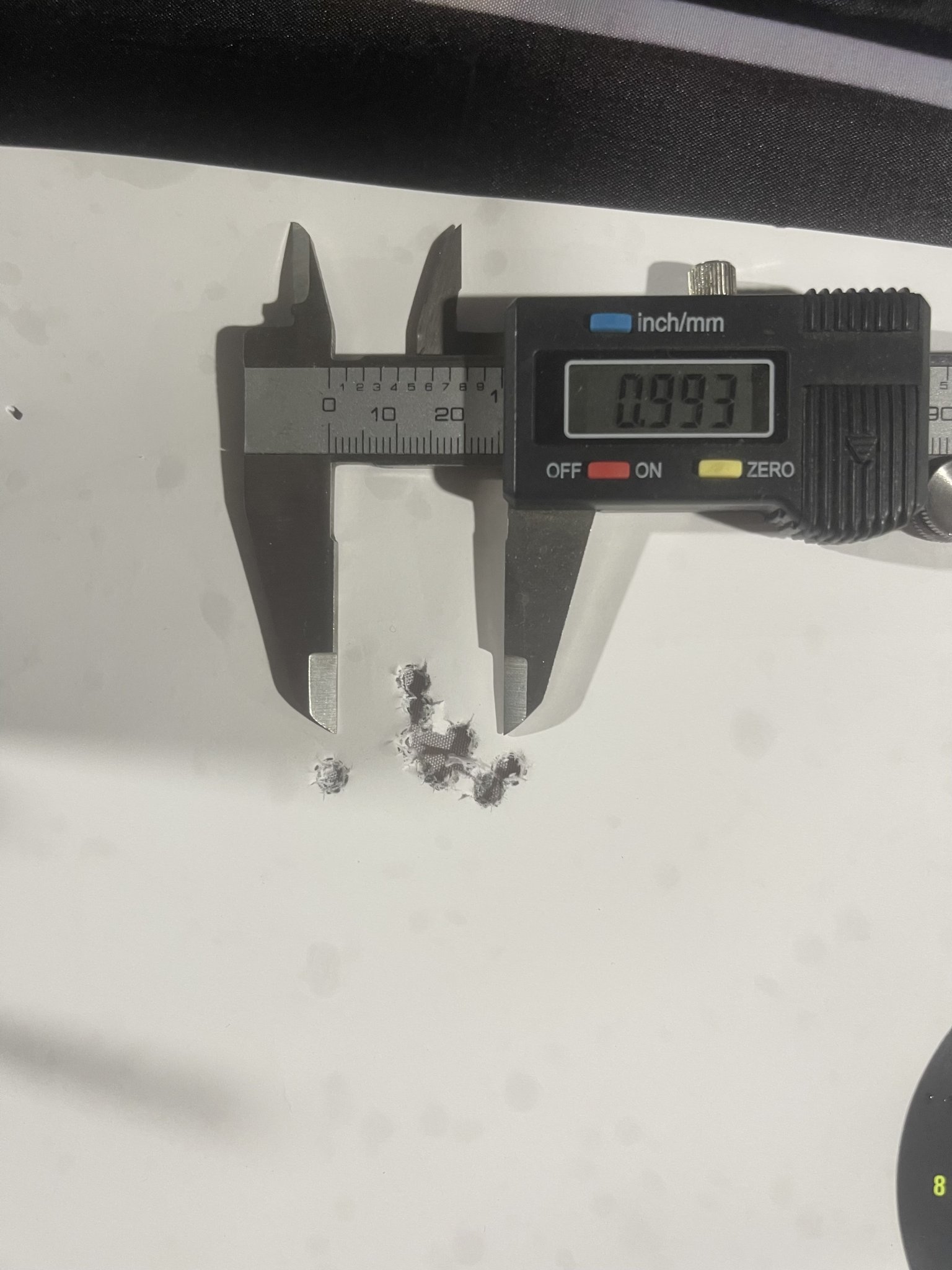

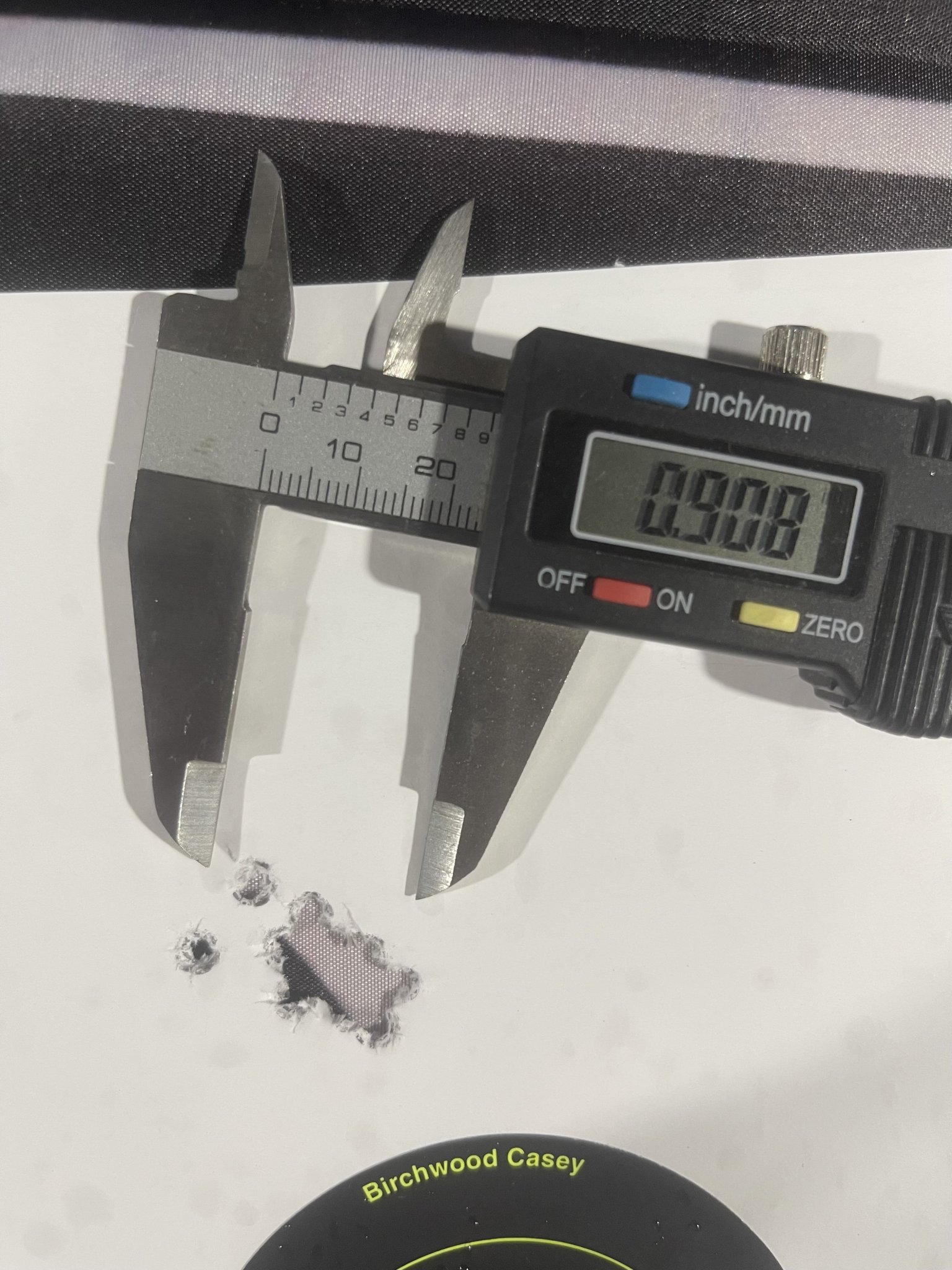

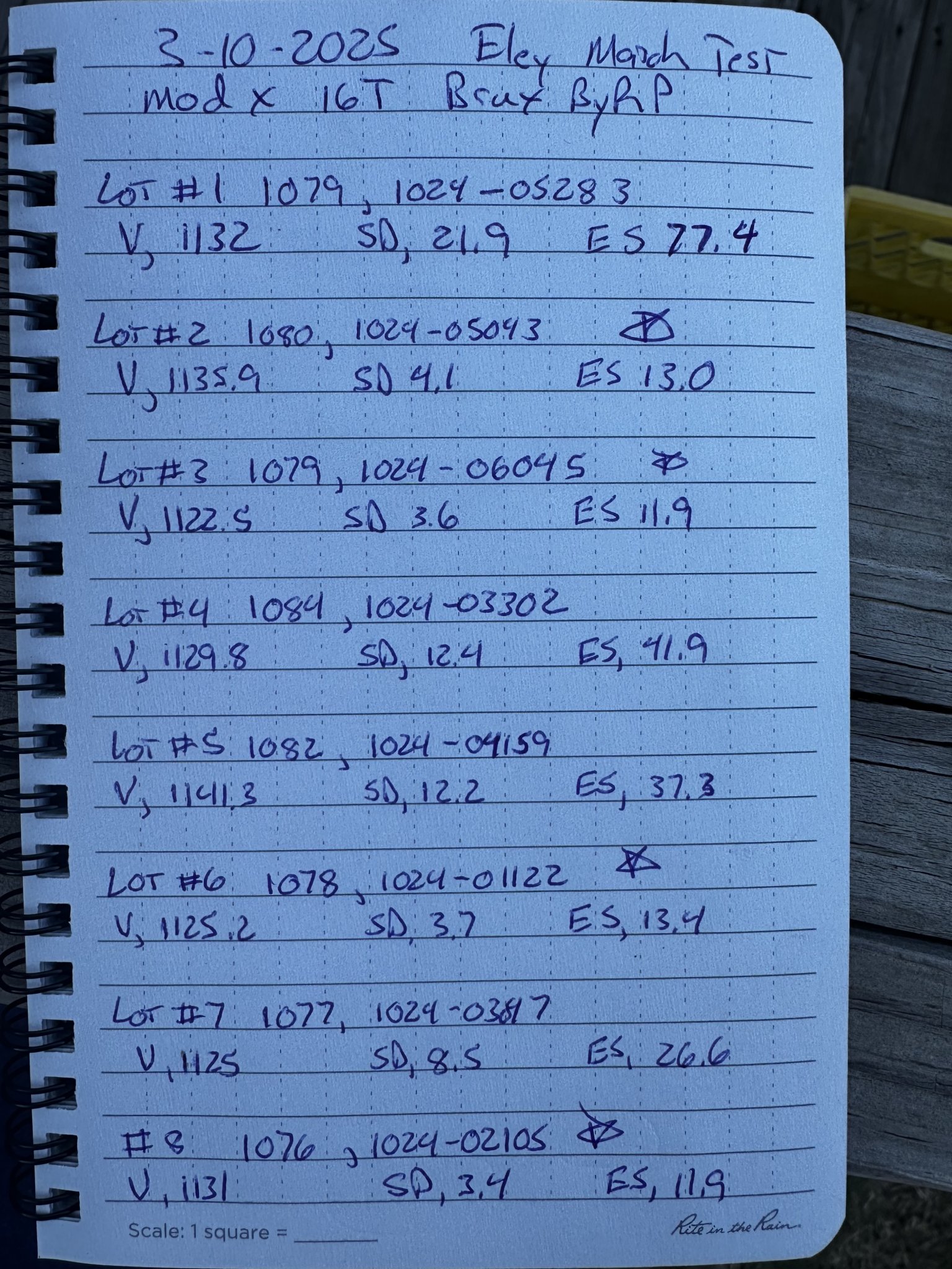

I prefer to lot test Eley match. I will order 10-12 lots of 2 boxes each. This lets me test for shot strings after I narrow the lots down. Then I'll typically order 2 more boxes and I will test 100 rounds from 50y to 300y on steel and paper 50y to 200y. 5 - 10 shot groups and record the whole shot string.
Attached you will see the new lots I am testing. These groups are all 10 shots at 50y. 25" 16T Brux barrel on a ModX Build. Every barrel will typically like a different ammo. Good ammo is typically always good ammo.

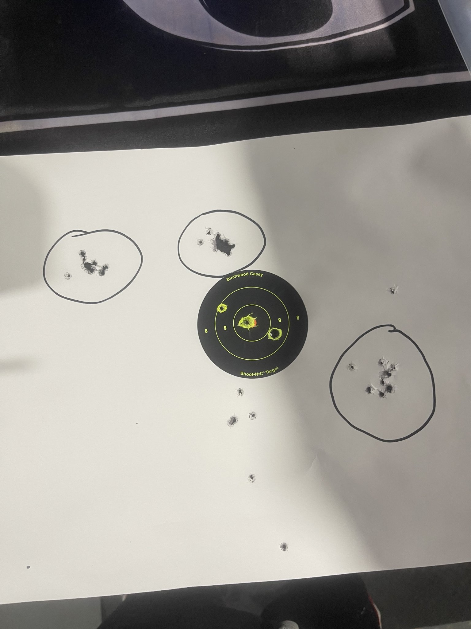

On paper? When I see this shooting steel it usually nicked the edge and the target barely moves if it all. The only other time I had similar was using a Harrel's AR Tuner brake on my T1x. It would build up a pretty nasty cone of fouling and eventually some of it would hang down in the bullets path.
