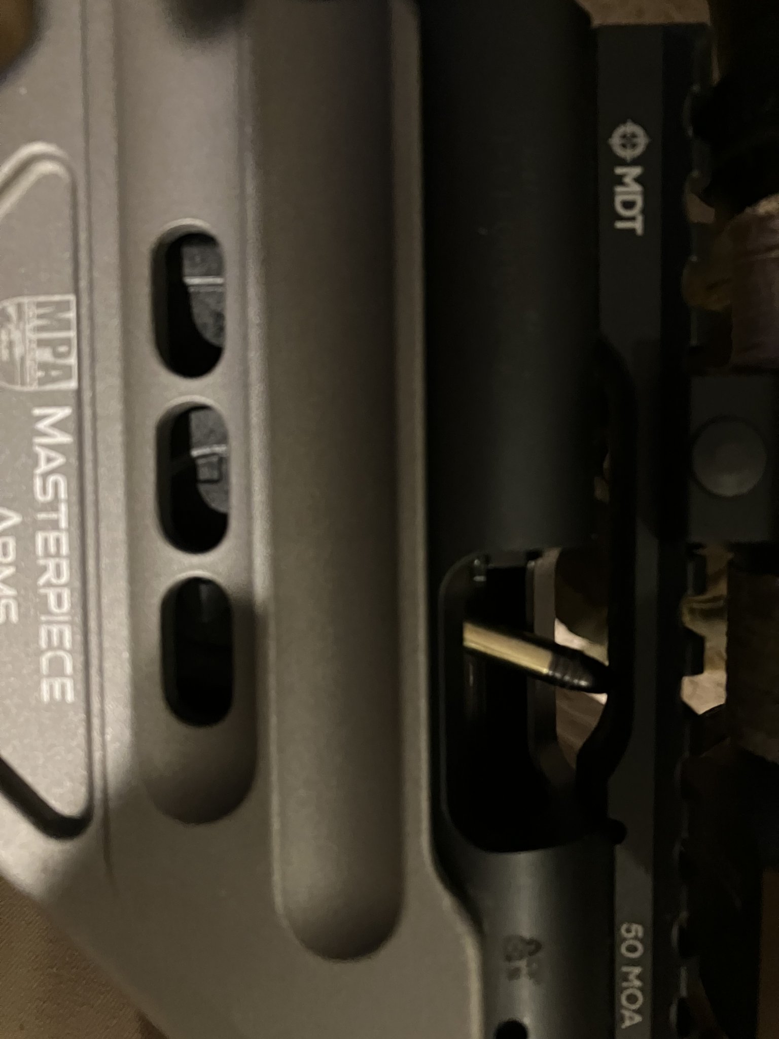

Shot a match this weekend. The rifle is accurate and shot well until a mag change stage.
Every other round would jam and the bullet presentation would look like this:
shot some more after the match to diagnose and was running into the same problem with the same mag.

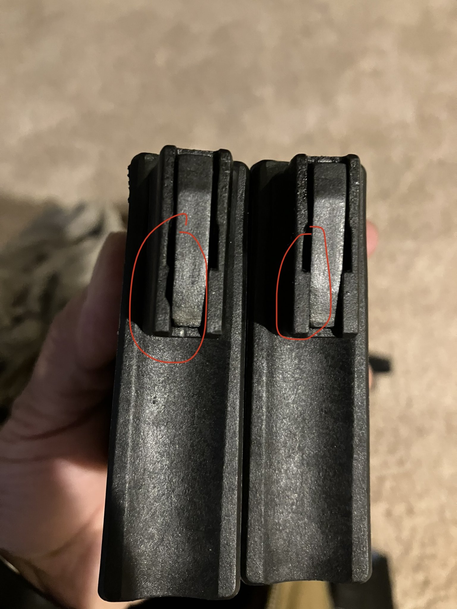

Upon closer inspection I saw this:
The left mag has a chip on the left feed lip ear.
I have less than 1,000 rounds through this rifle and this is 1 of 3 mags. I’ve never dropped it.
I hypothesize that the slick bolt may have rode forward during a hasty mag change and the feed lips may have hit the bottom of the unlocked bolt.

Rubber band is because it self feeds a round if you tip the rifle down forward, it is annoying.

Mag is broken.
Replace magazine.
If you want to put a dab of jb weld and file to fit it should hold. I wouldn't be using it in matches anymore though.
For what it's worth, I have 10 mags, all have been dropped plenty of times in gravel, dirt, and concrete. I haven't managed to break one yet.

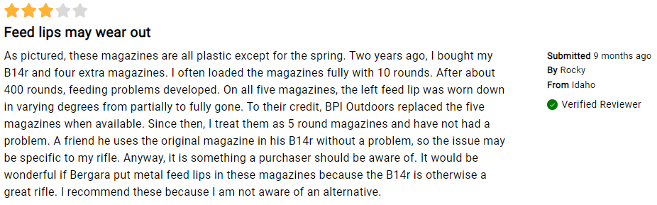

Looks like others have had similar issues with B14r magazines and the left feed lip chipping or wearing.
