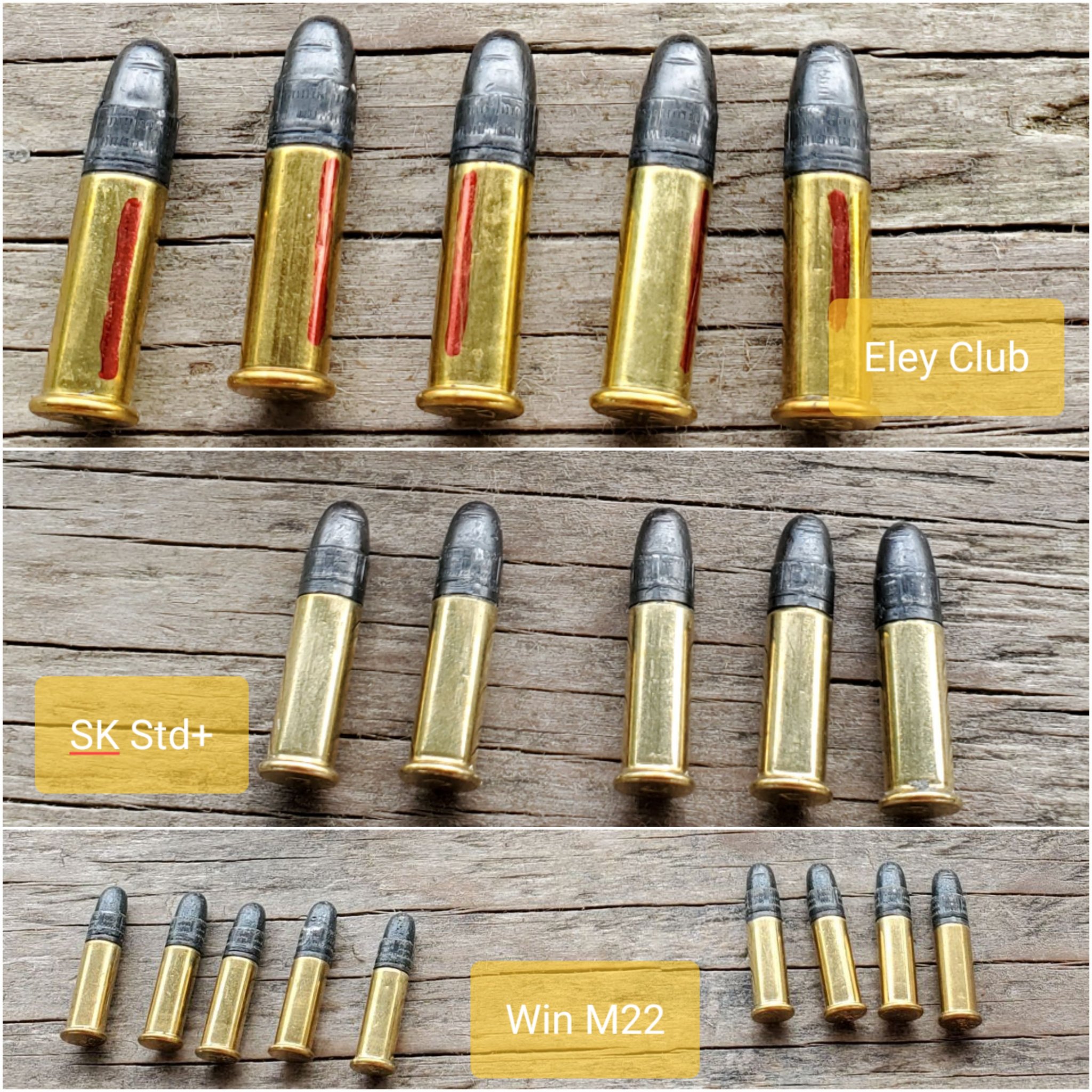

My Bergara BMR is damaging the projectile tip and perhaps the driving band when feeding from the magazine. It happens with all 4 magazines and multiple ammo types. It most assuredly is negatively affecting accuracy. Any suggestions on how to fix this? I did the trigger mod with great satisfaction, but if I have to send it to the Mothership, will they undo my trigger job? This will be cross posted.
It appears the round is hitting the top of the chamber when it is entering I suggest looking/feeling for a sharper than normal edge at the chamber 12 o'clock position. There should be an edge break at that location. Regardless, you should contact Bergara, show them the photos and ask what is causing this and how to fix it.
