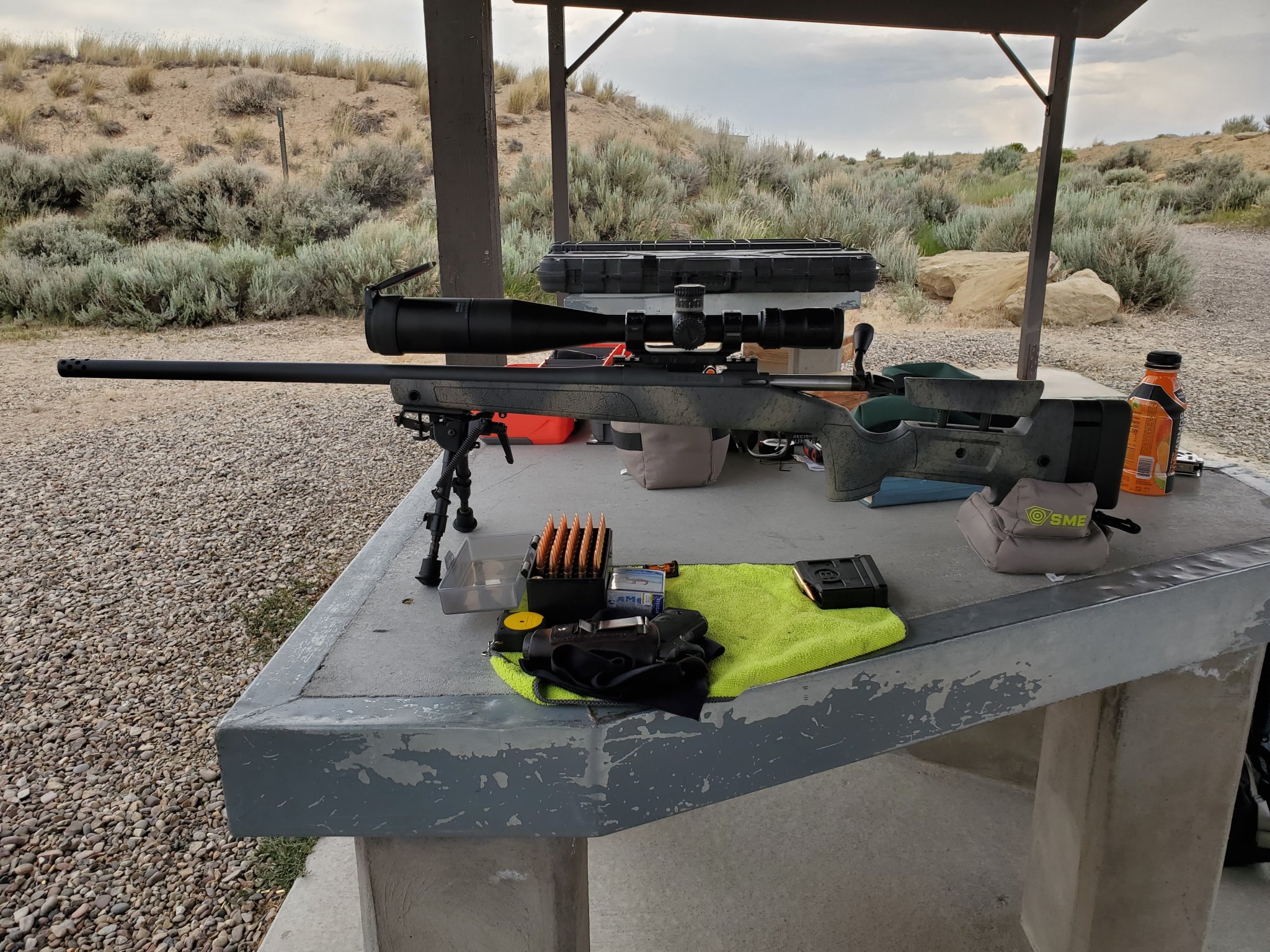

just purchased a Bergara HMR B14 Wilderness in 6.5 creedmoor and am pleasantly surprised how much I like it. Shooting Hornady 140gr BTHP's. Initial sight in and barrel break in is showing promise. Attached picture shows my cold bore shot and following 4 rounds at 100 yards the following day. Definitely room for improvement and will be trying some ELDM's to see if I can get better grouping. Curious to see how others have fared with this rifle. Let me know.

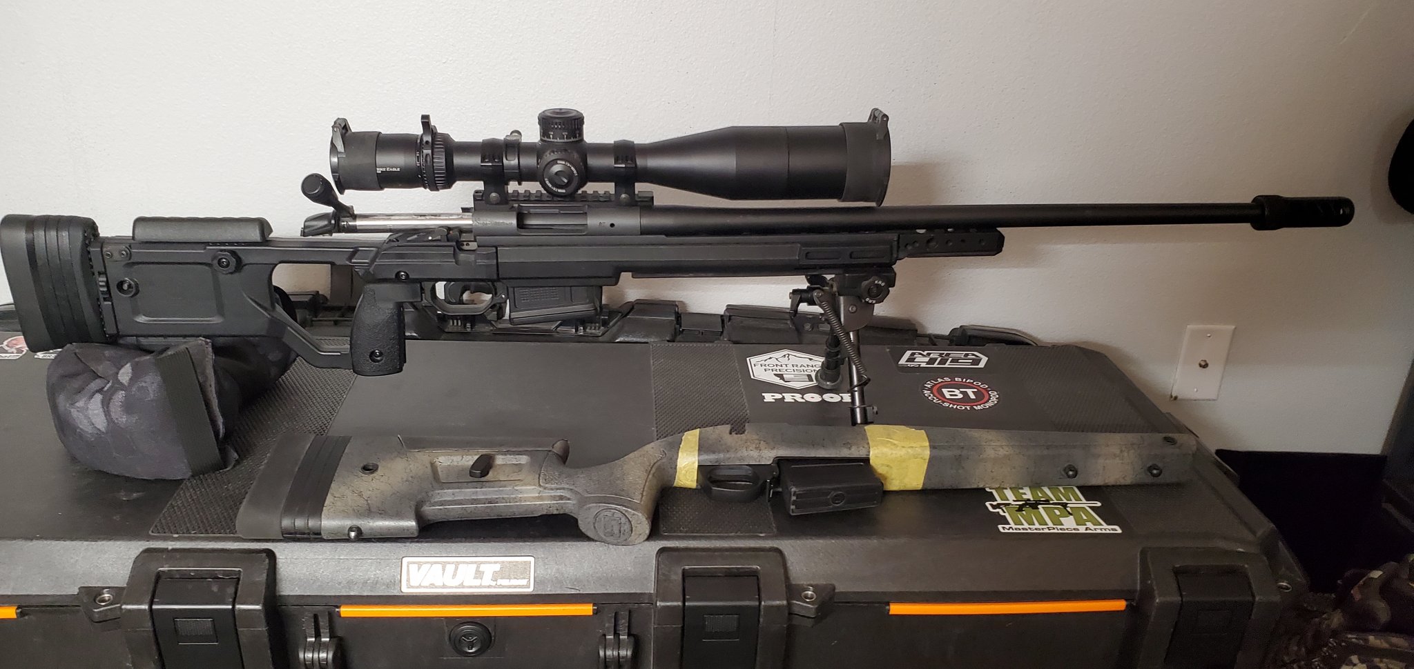

I'm on my second barrel. First went south at 1900 rounds. Put a barrel taken off of a B14 it is a lighter profile from my Wilderness barrel and is not cerakoted. It's blued.
I've thrown it in an older gen X-ray and am running a 30 cal area419 Sidewinder muzzle brake. It is shooting well now that I've worked out the new barrel kinks. It is a minimum spec chamber and I was running my brass at max length with the old barrel. Bad idea with this one which caused a doughnut to form inside at the neck shoulder junction. It gave me hell. Couldn't get my spreads below an ES of 30 and my velocities were all over. I tried multiple powders and bullets and finally found the issue by using my bore scope down the muzzle with a fired case chambered. I found the issue corrected it and it is now shooting well enough for it to be my trainer rifle. I'm trimming my brass down to 1.905" and have removed the doughnuts with an inside neck reamer and now have no issues. By the way removing doughnuts with a reamer sucks ass. If I am able to buy new brass next time I most likely will. Right now I'm shooting:
Originally a HMR B14 Wilderness.
24" 8 twist Bergara barrel with Bergara SA
Area419 Sidewinder muzzle brake
Sitting in a KRG X-ray chassis with factory trigger.
Hornady brass
210m primers
140gr hornady bthp 0.045" jump
43.6gr 6.5 StaBall
ES 17
SD 6.5
Avg 2685fps shooting 1/2moa or better.
Not the greatest spread but accurate out to 1k and good enough for steel. It saves my 6GT barrel.
