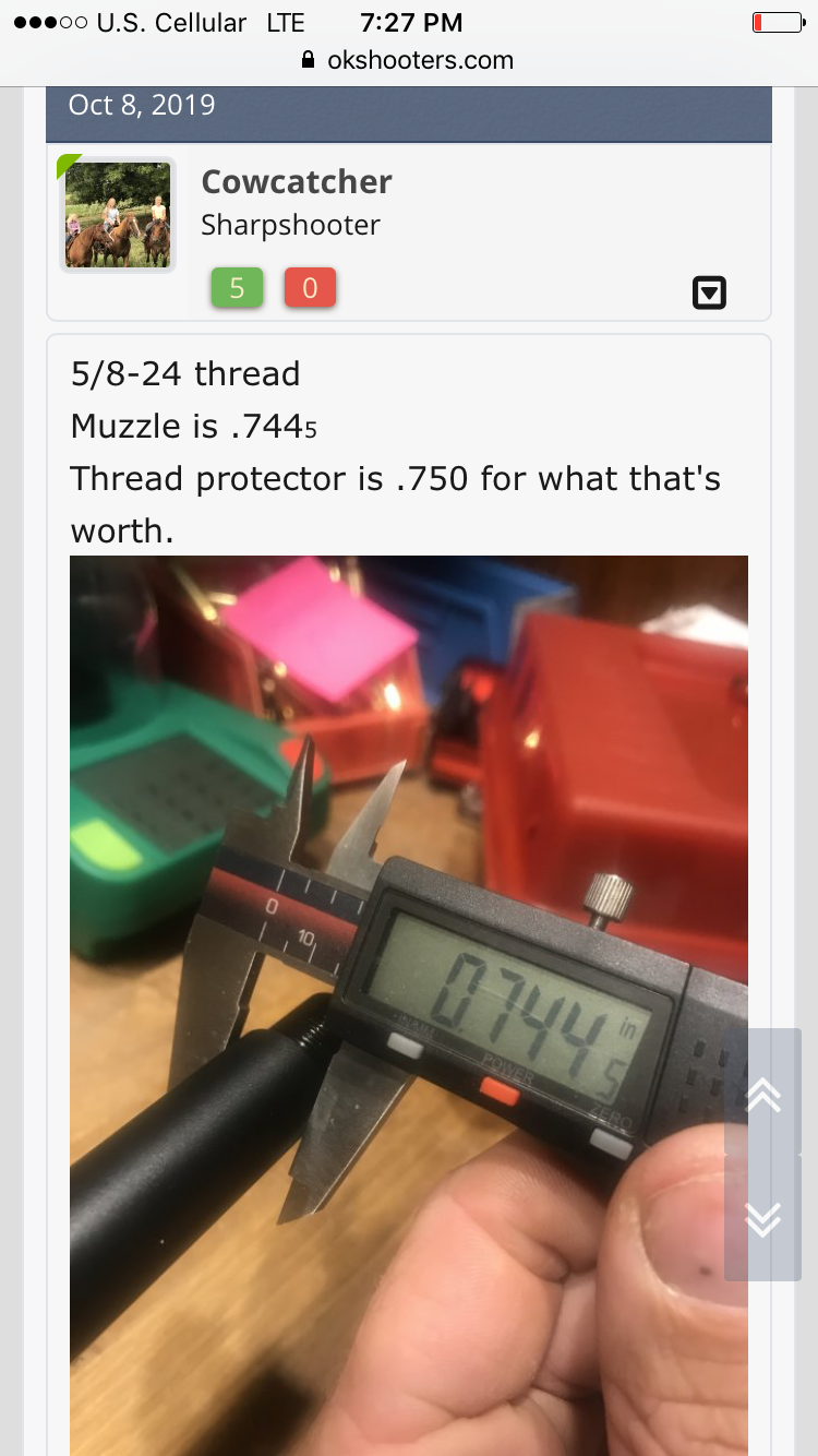

For the standard HMR what is the muzzle diameter right behind the threads? Mine is right at .855
Asking as I thought I read there were two versions. Hoping I didn’t get the heavier of the two.....

.75 is what mine measured. So you must have a heavier barrel. I didn’t know they offered it with a heavier barrel.

Mine is about 2 yrs old and the 24” model. Measures .74 just below the threads. So that seems to solve it, the newer ones have a bit heavier barrel.

Bergara has changed the barrel profile, if you look at the specifications you will notice the newer B14 hmr is heavier than the older version.
If I recall the older was a 5.5 contour and the new one is a 6 contour.

You got real close. The older version was a #5 and the new version is a #6.
