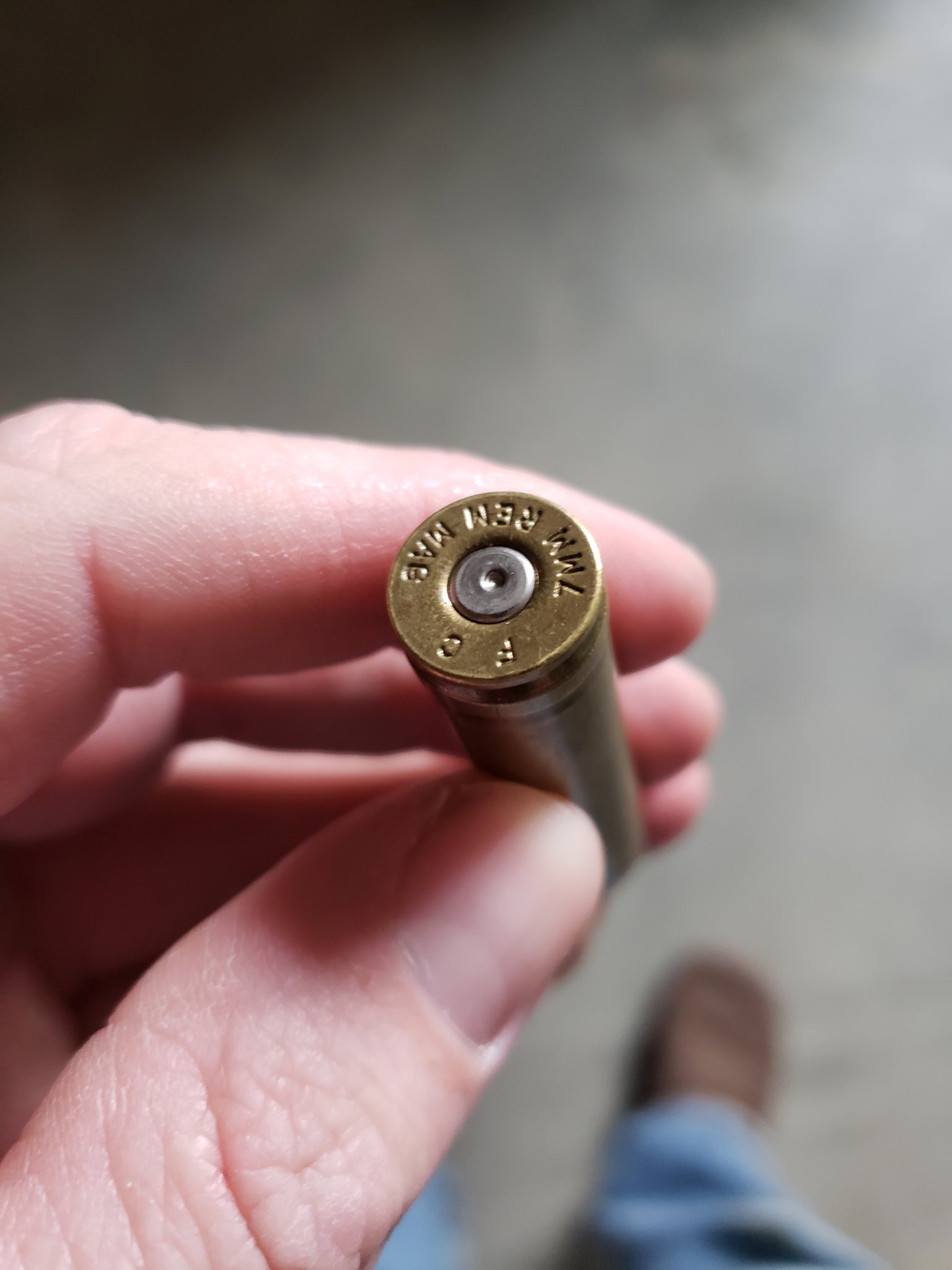

    These are a couple of duds from testing primer seating depth. Hopefully the photo works.

    Wow, the firing pin hits in that picture sure look good. Are those a double strike?
    I think almost all of my failures were struck multiple times.

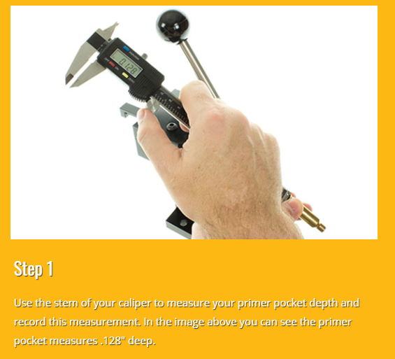

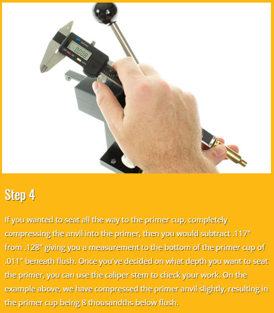

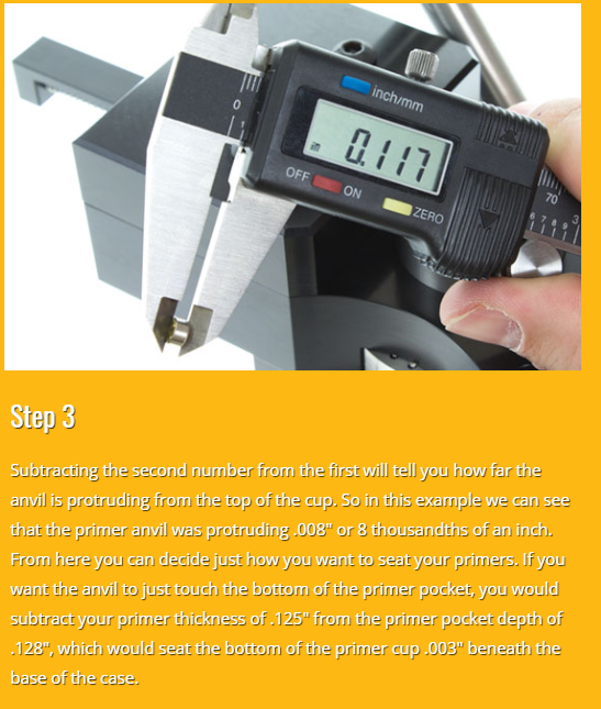

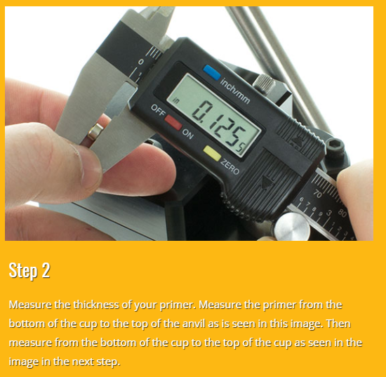

    Get some data on the actual primer depth measurements. Know for sure, this is the first place I would check.
    Awesome pics courtesy of primal rights
    Depending on the tool your suspected "crush" could just be the tool travel stopping short. I was just encountering that with my old lee primer.

    That's a pretty solid idea to see where I'm at, and I think that I'll use that from now on when I find a load a rifle likes, or just to check pockets from now on.
    Maybe I have pockets that are too deep, but this isn't a single batch of brass. I haven't found any relief of misfires though from the various primer seating depths that I've used. Like I said, I've loaded groups with primers from flush all the way down to crush and multiple points in between...and out of every five shot group I've never had all five rounds go bang with CCI 250s. I've shot a total of (20) Fed 215s, and all have popped so far.
    Thank you for the images though...it is another tool for sure.
