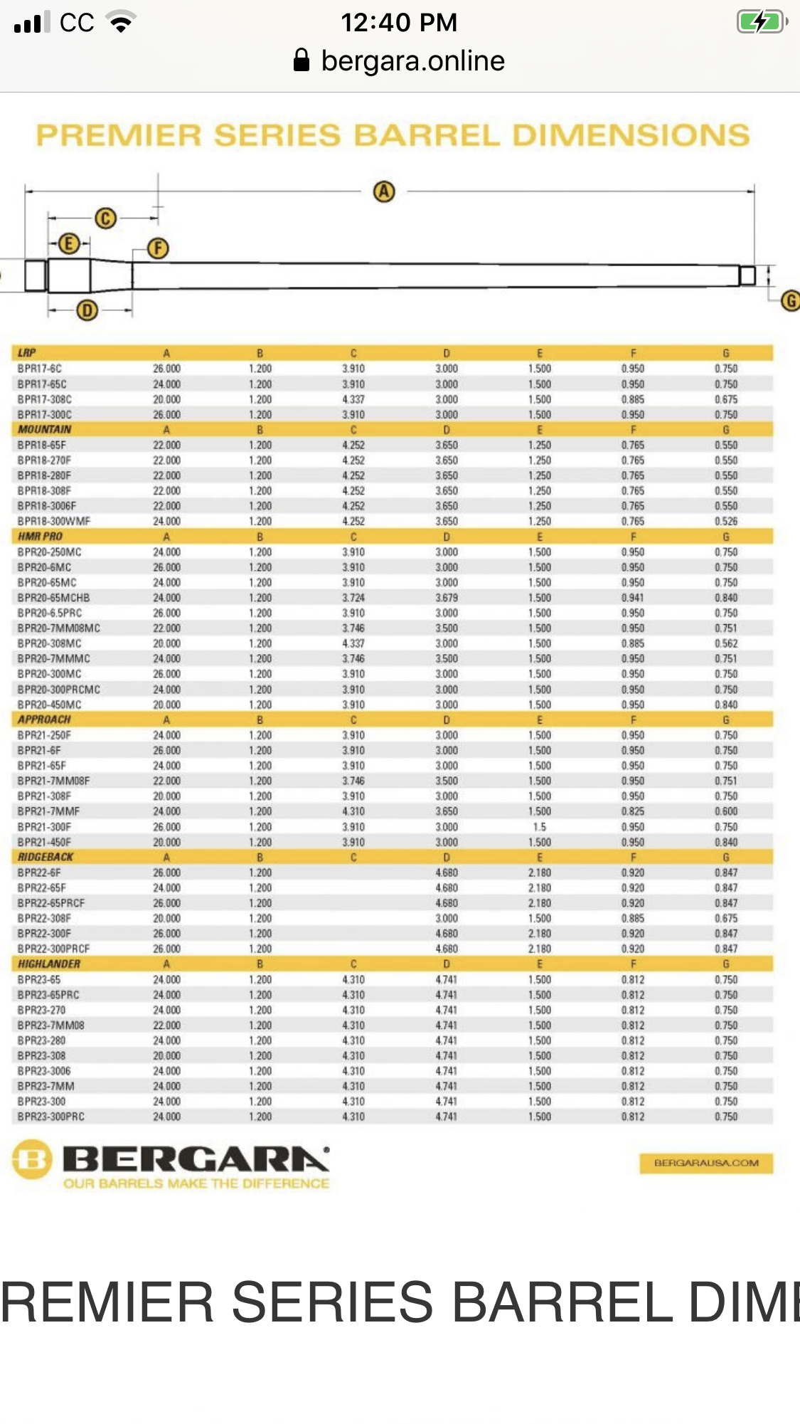

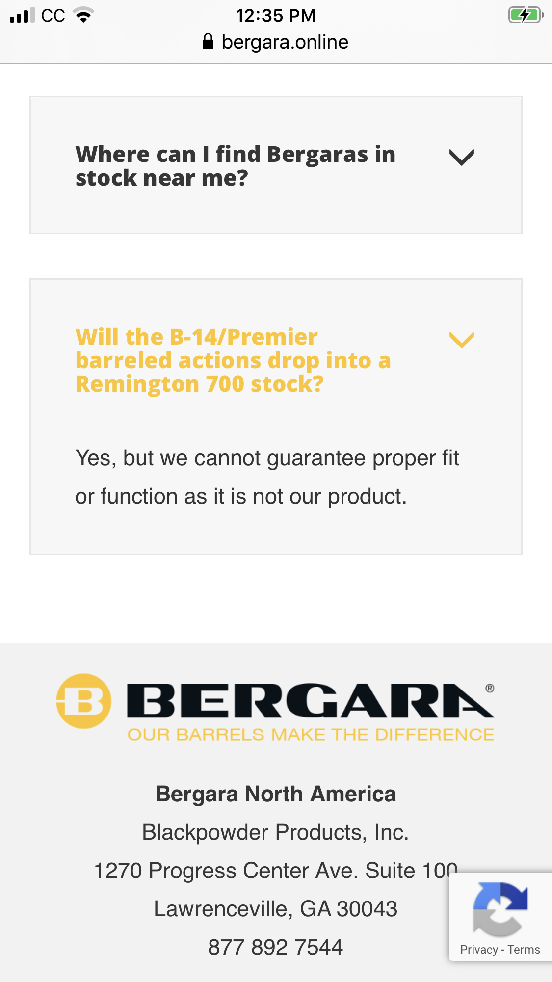

I just bought a Bergara 6.5PRC Premier Ridgeback. I want to swap out their stock for a KRG Bravo or an AG Composites stock. I am lead to believe the Ridgeback is a Rem 700 clone (with one small protrusion in the stock under the bolt, and a wider recoil lug opening). I have three questions:
1). What bottom metal does Bergara use in the Premier Ridgeback? ( AG and KRG want to know when ordering their stocks). Is it Remington, Badger Ordinance, etc??
2). What exactly is the Premier Ridgeback barrel contour? Sendero? Palma? ( I found their barrel dimension chart for my rifle, but I do not know barrel contours well enough to identify it...(see attached chart)
3). Any one of you guys ever swapped out a Bergara stock for a KRG or other custom stock? Any issues encountered?
Thanks!
Robert

From what I can find it looks be a medium palma. The bottom metal is Bergara made and it fits AICS mags
I learned that Bergara uses both a Grayboe stock and Grayboe bottom metal . As such, AG Composite said their stocks are not made to fit or accommodate Grayboe bottom metal.
