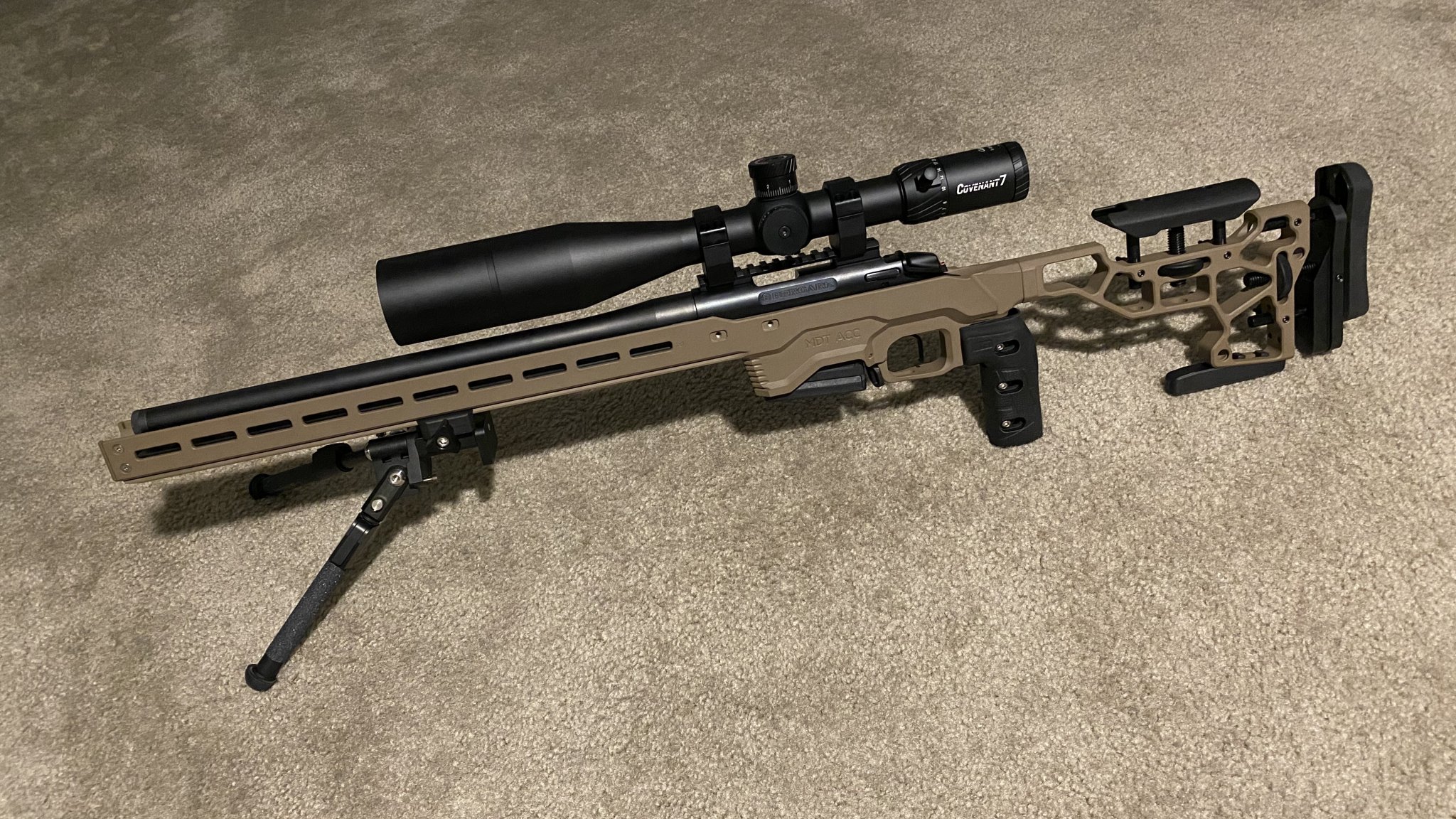

both rifles of mine aren’t stock. If you need more info just ask about them and I’ll see what I can do. I’ve shot the tikka at a match and it was extremely fun. It’s got a yodave trigger spring with a krg bravo.

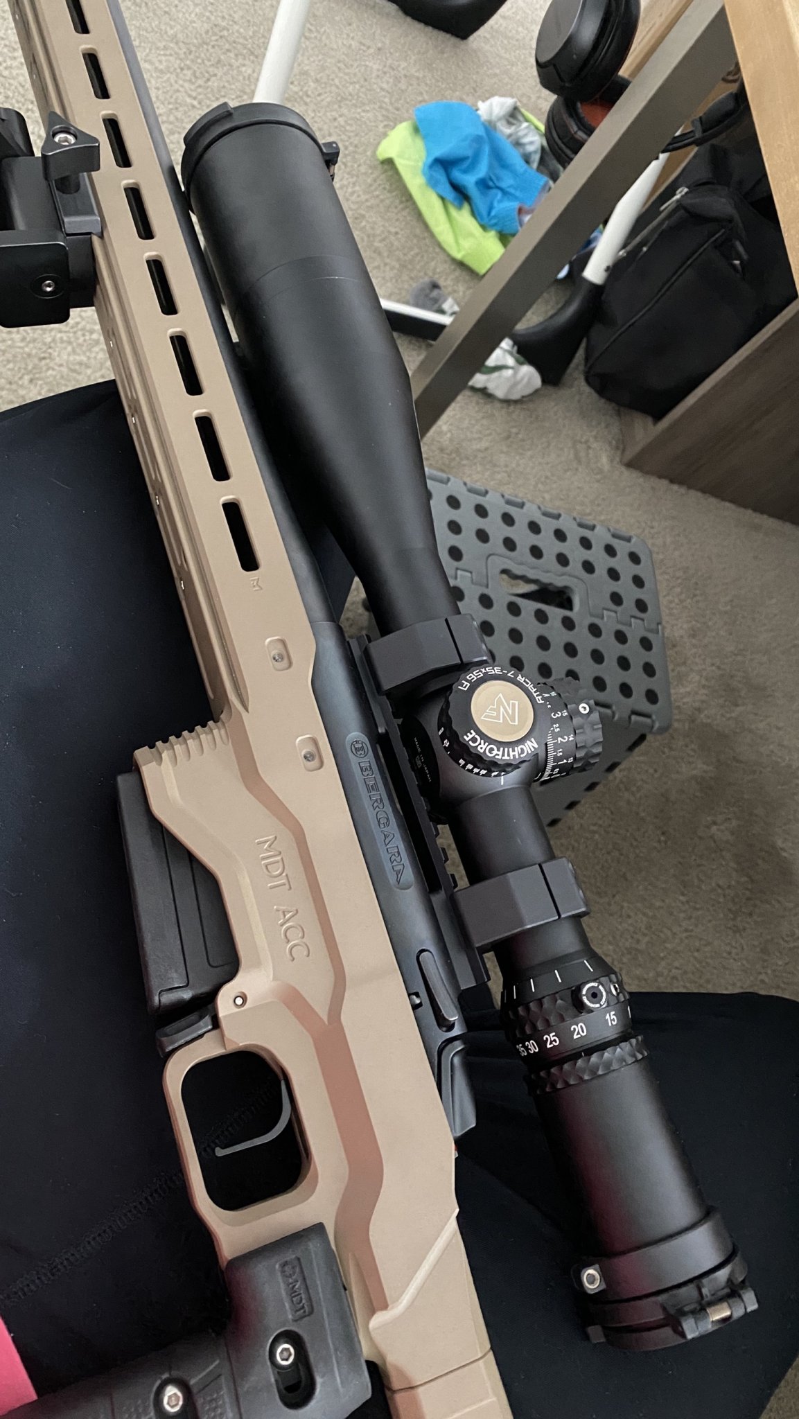

The bergara sits in an mdt acc with a trigger tech diamond and a Nightforce atacr.
As far as groups go, once you find the right ammo, you’re good to go. The bergara likes eley club, shoots between .3 to .45 groups with that at 50 yards. The tikka shoots eley tenex lights out. 10 shots through literally the same hole. But that’s expensive and I don’t want to spend 17 dollars a box. It shoots cci standard at about .6 inch groups at 50 yards. If you ask me this is amazing. The bergara shoots cci standard at .8-.9.

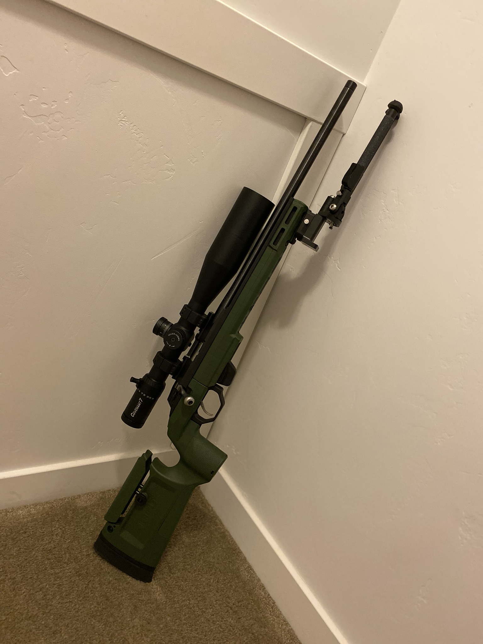

Well guys I own both! Same stock, both pillared, both glass bedded, both free floated barrels, both same scope, both same bi pod and shooter same shit conditions
total cast in the Tikka $499 gun, $210 stock, $100 bedding which I did myself just added a value for a total of$799
Bergara $650 barreled action, $210 stock, $150 trigger for $1,010
the difference the Bergara has a nicer bolt action, more consistent point of aim no extraction issues! But at the end of the day they are both sub MOA rifles
but the Bergara is just a little better in my opinion
