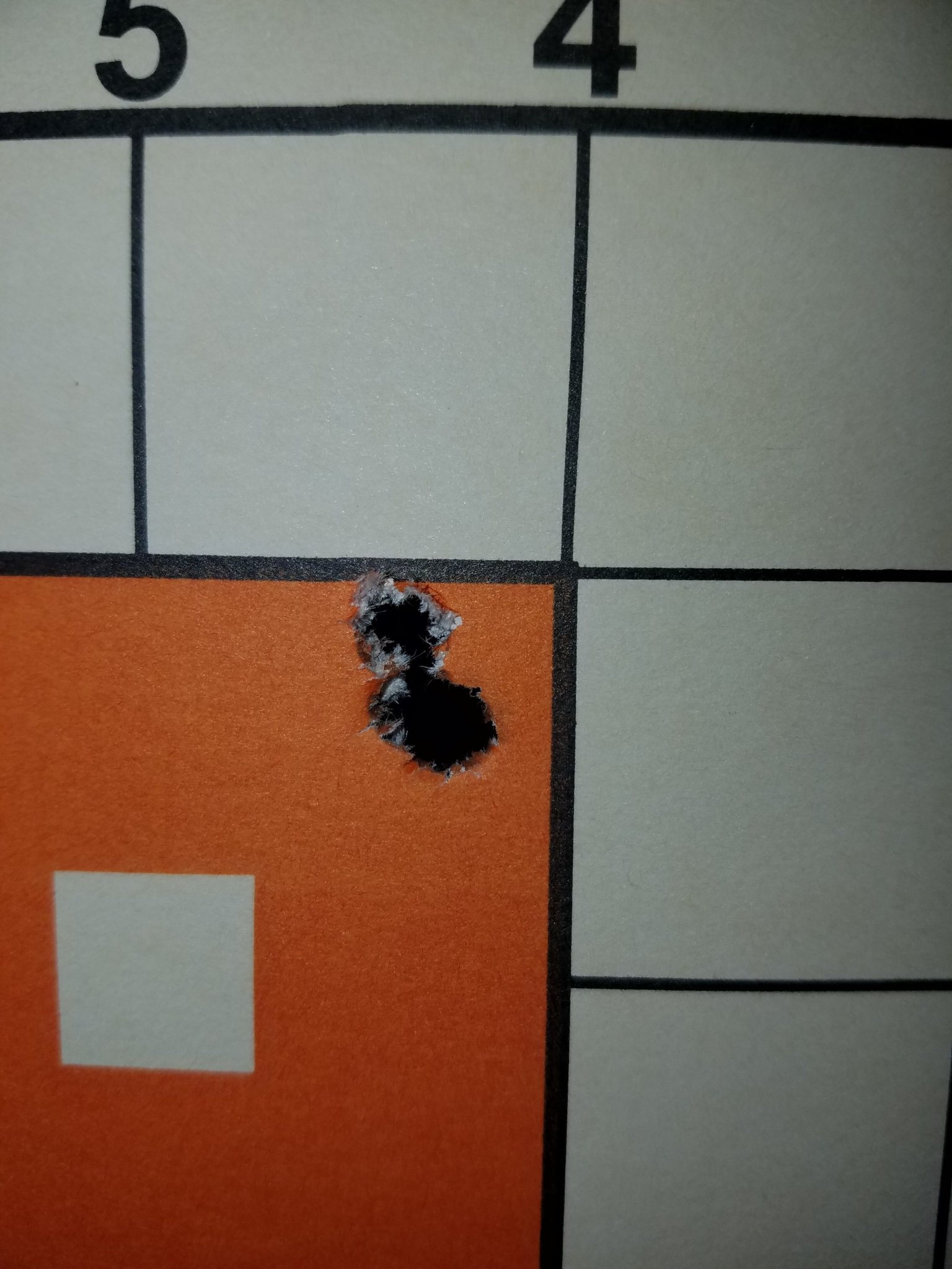

    109s..BRX..varget..fed205m..Peterson brass..Bartlein 8T
    1-32.1
    2-32.3
    3-32
    4-32.7
    5-32.9

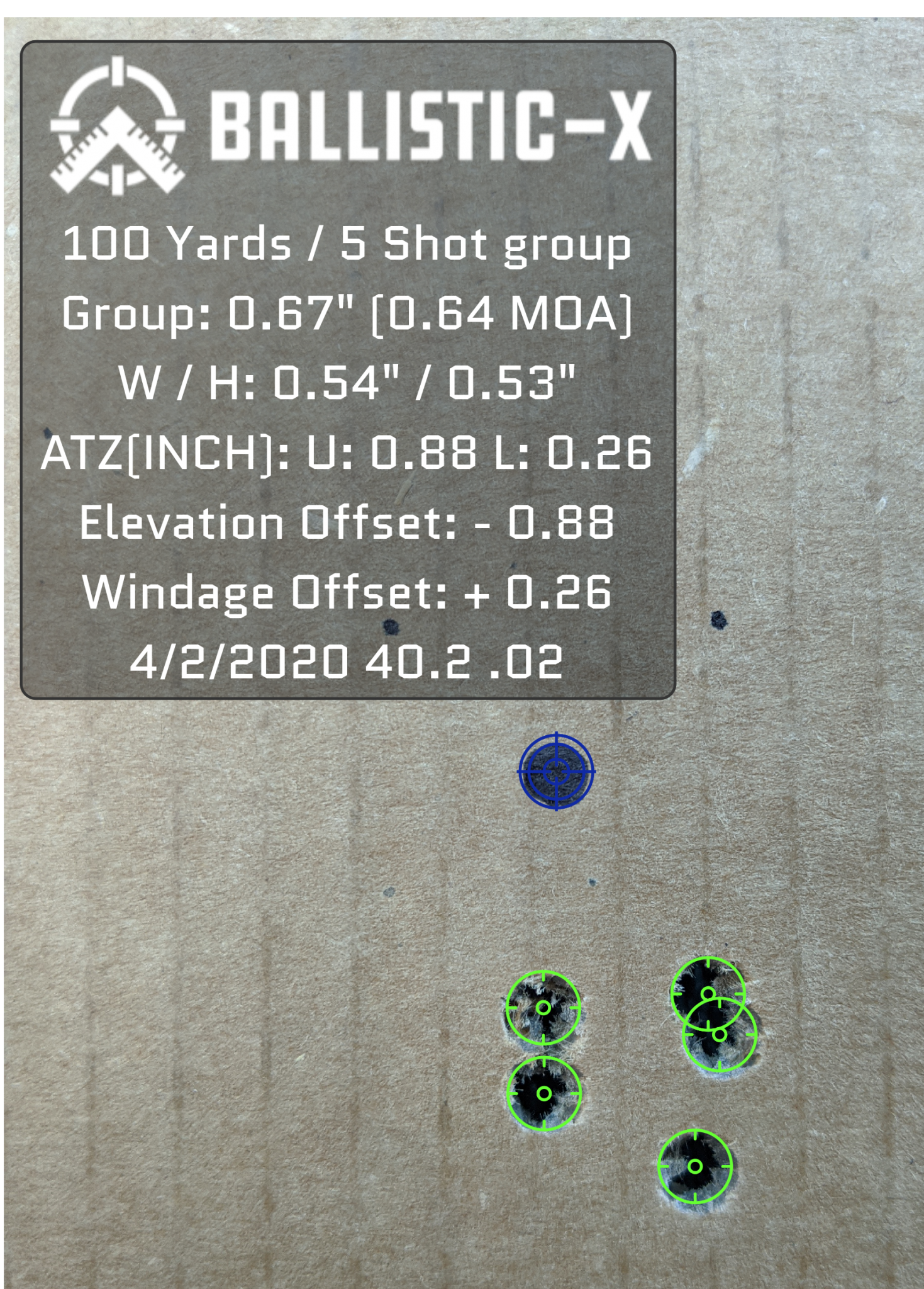

    So I read the thread. I can't seem to get my 109 to group. 177 rounds down the barrel. 26" bartlien 7.5. shot some ELD 108 box ammo to break it in. It's a 6cm buttoned up to a curtis axiom.
    I'm getting .64moa groups with a node at 40.2gn RL16, .020, federal 210m in some virgin brass 2069. The bumped brass is at 2979. 10fps difference between fireformed and virgin huh? Today ES was 7 and SD of 3. I got some loaded up with a bigger jump. I've heard these like a big .065-.08 jump. So I'm gunna try them out. I'll be shooting those out @ 700. Maybe it's just me at 100.Ballistic-X-Export-2020-04-02 16:42:46.829294.png

    try running them closer to the lands
    I have some .005, .01 and .03, .06 -.08 all loaded up. I don't think I'm gunna chase the 100 group though. I want to see what they do out at distance. It was just frustrating that the ladder didn't work for me. And the ES/SD are so low its got to be another variable
