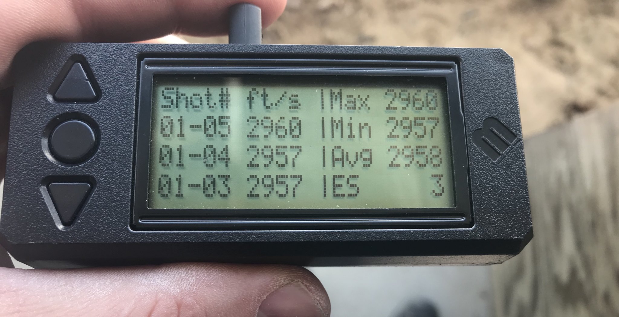

So, just to eat my own words...
The 109 is in a new line of bullets, the hybrid long range target. Apparently, the hook on this line of bullets is consistency.
Think Scenar-L from Lapua. Berger was already my choice for match bullets because of their consistency. Apparently, these are Doppler measured to have 1% or less BC variation.

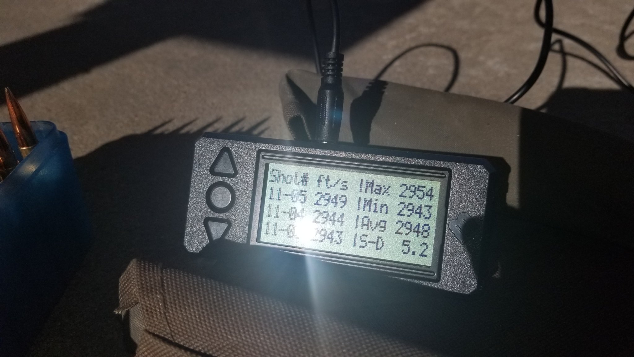

I bought a box to try. I bumped my 105 load by a tenth of a grain to make up for the weight difference and keep them in the same speed zone I've had such good luck with the 105s.
Chronographed.

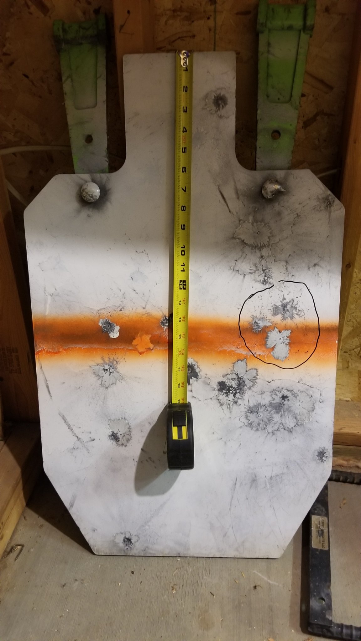

First three rounds at 1040yds. Loaded the CDM for the 109s and ran with the solution. It's dead nuts.

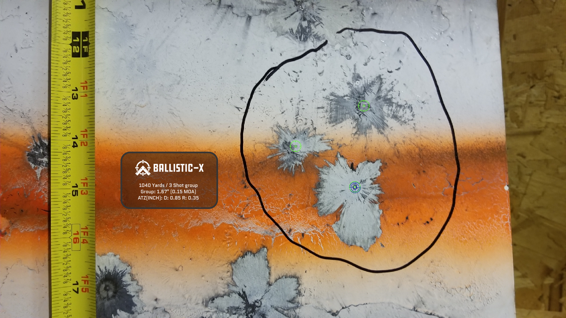

After we finished checking the curve we shot the target up and the others we brought with positional shots and other stuff.
Measured the impacts when I got home with Ballistic X and it spit out a 1.67" group, on the waterline, at 1040, cold.
I take back my hurtful memes!

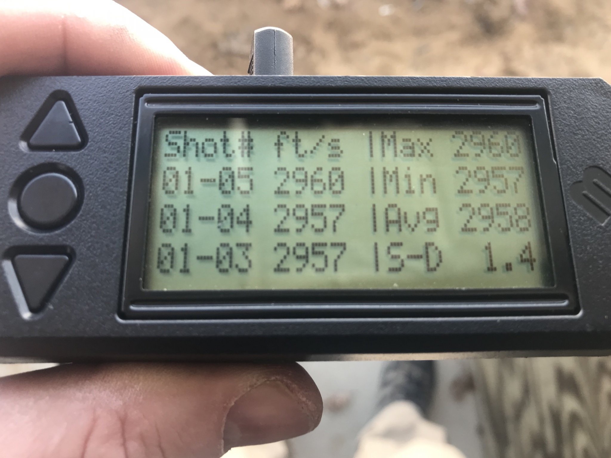

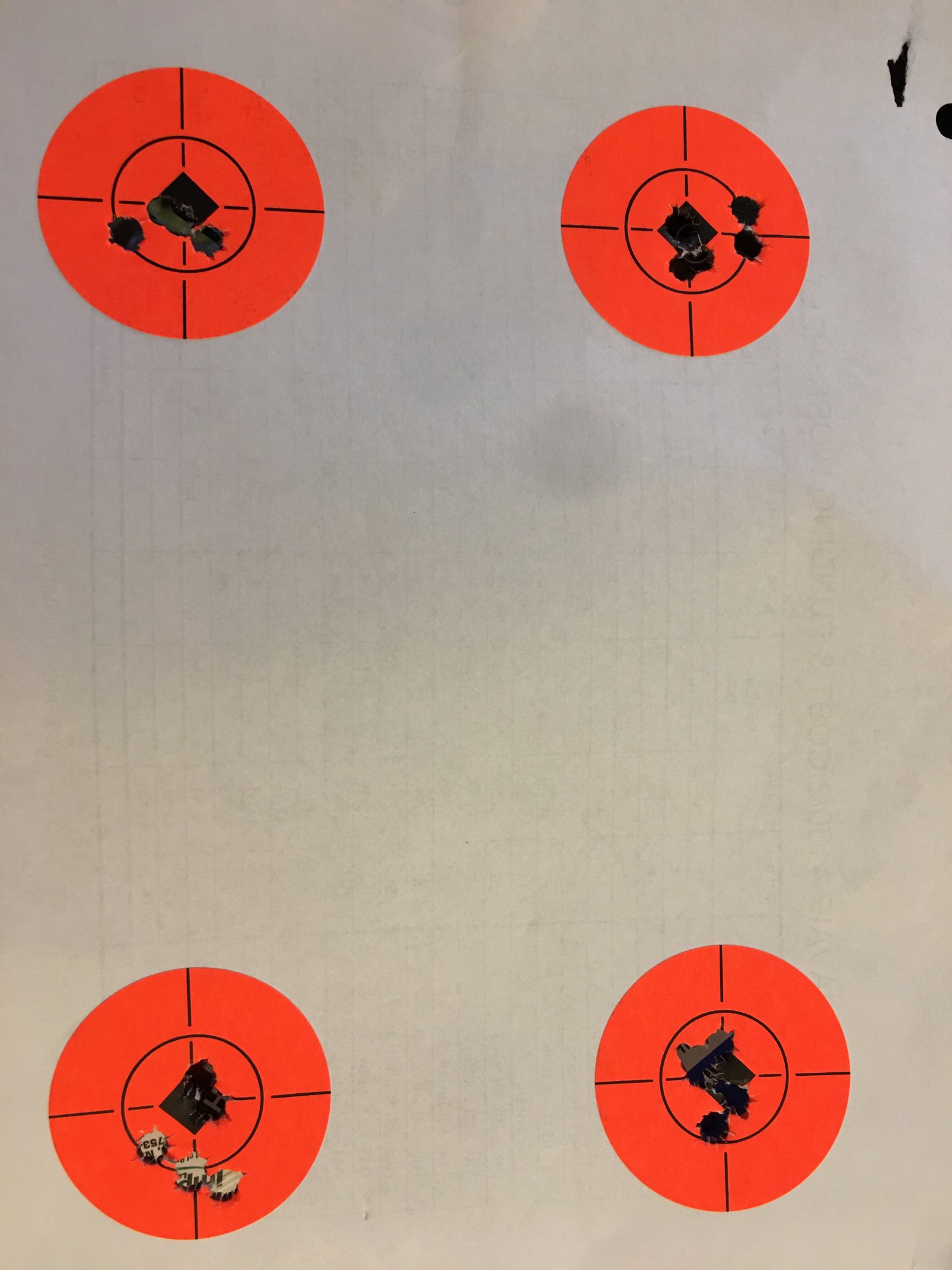

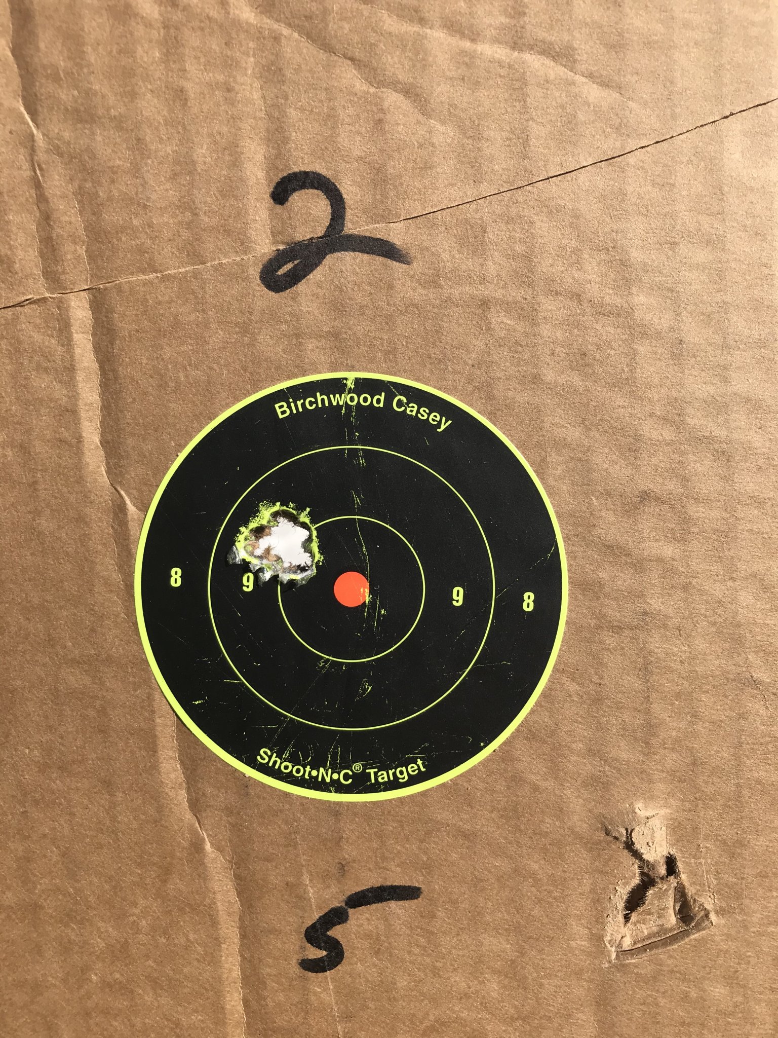

I tried them at 100 yards today. Started with same load as my 105 and went up from there. Jumped them the same as 105. Accuracy wasn't great, ranging from .5-.8. POI was exactly the same as 105. My 105 load is 32.7 Varget and pushed 2960. With the 109 my velocity is 2935. Low SDs on both. Running these in my calculator, there is no difference in drift at 1000 yards. Not sure if worth the price difference over 105s.
I’m really liking these and will be switching to them after I run out of the 110 A-Tips in my 6GT
34.5-34.6 Varget has been the sweet spot across multiple bullets in this rifle. Here is 34.5 with the 109’s
