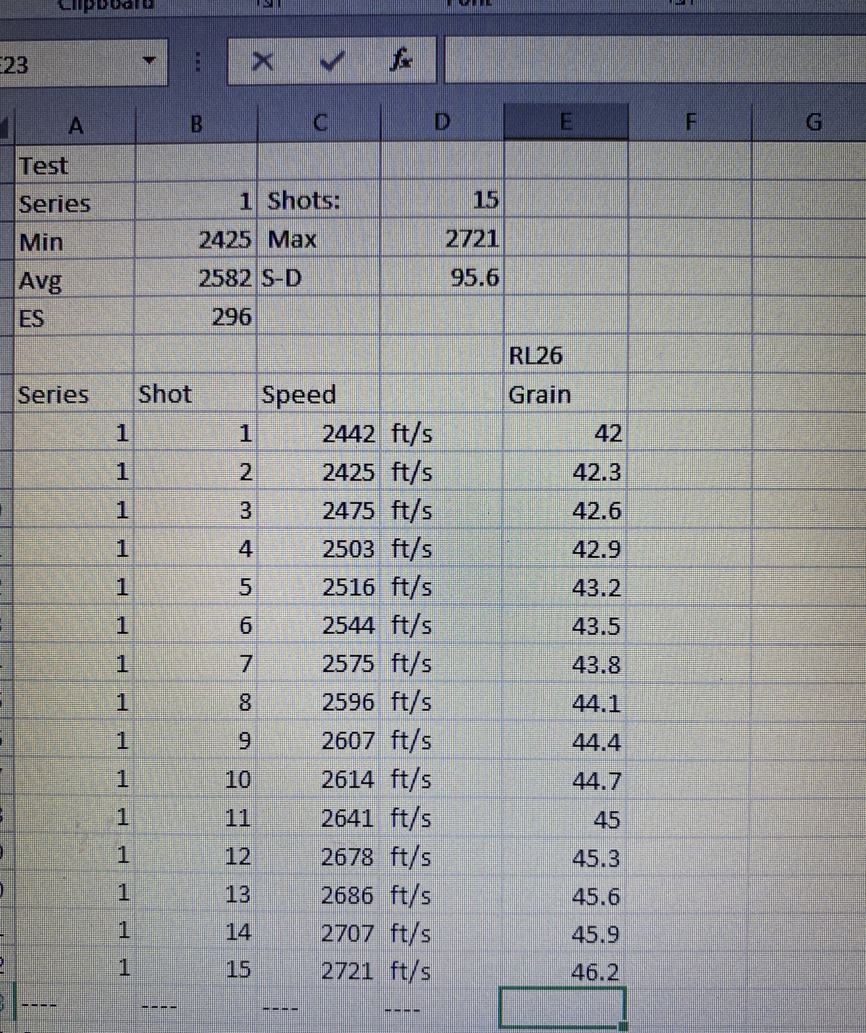

Did a ladder test today with RL26, Lapua , CCI450, from 42Gr-46.2gr and had some insanely impressive results. Running out of a brand new proof research 20” barrel suppressed which only finished its break in procedure. Hit a high of 2721FPS with absolutely no pressure signs yet at 46.2gr! May push it a smidge further to see if there’s another node further up.
Some serious potential with these Berger 156gr EOL’s!!!

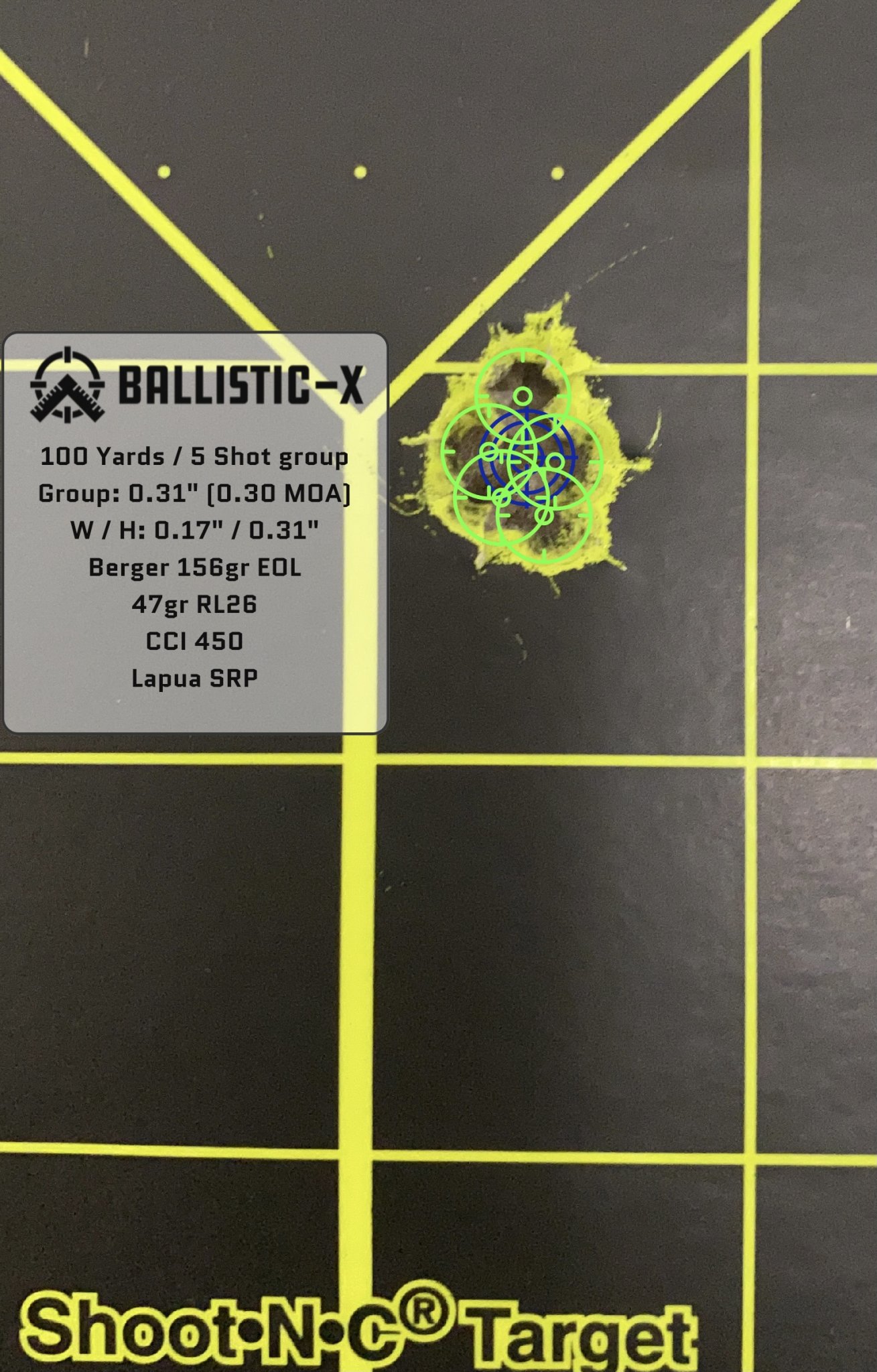

it’s been a hell of a busy summer and I’ve finally had the chance to finalize my load on this! Take a look at this 5 shot group at 100 yards! Average 2811 FPS with no pressure signs out of my 20” proof barrel with 130 rounds down the pipe. 😍😍 Compressed load with 47GR of RL26!If you try to replicate this , I am not liable and this info was provided for educational purposes.
