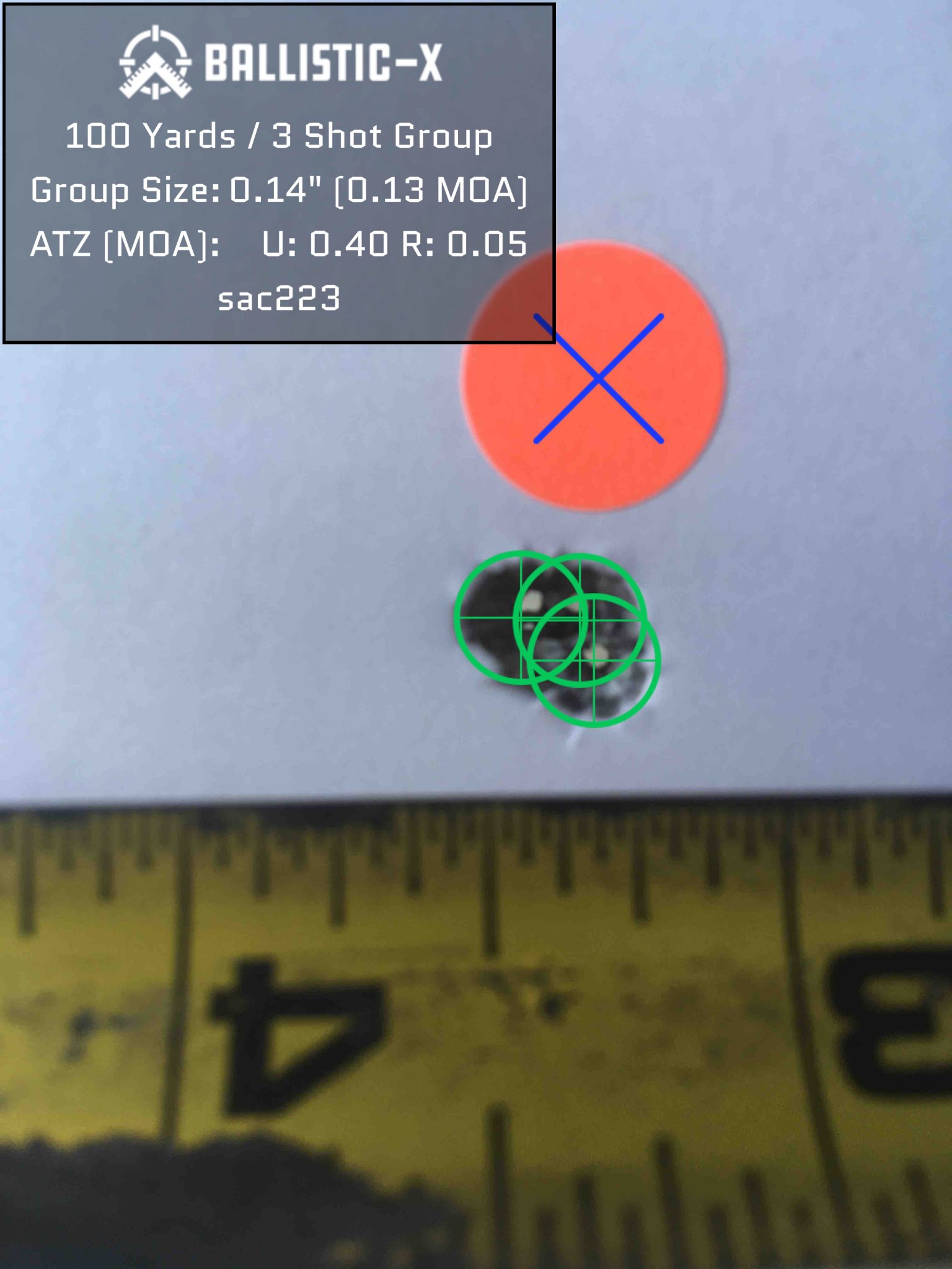

This is 77 Bergers with 24.4 Varget set to 010 off lands. Getting 2867 fps

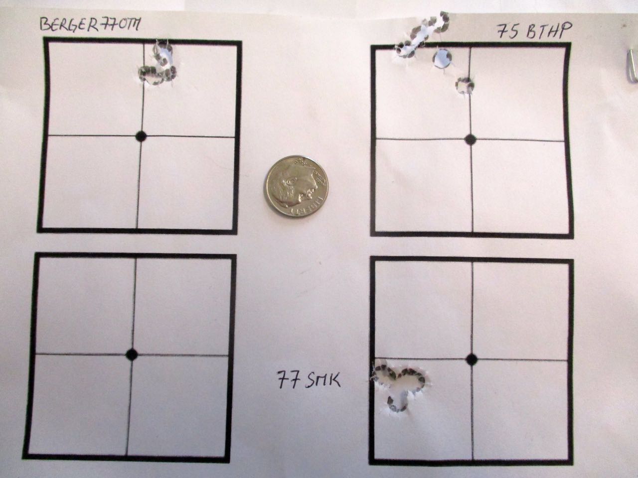

Went to the range today and shot 5 shot groups at 100 yards with Berger 77 OTM, Hornady 75 BTHP, and 77 SMK. All with 20.9 grains of AR Comp. I was having cycling problems and I think my gas block was coming loose. Didn't have any tools so only shot one group of each and headed home. Shot with a 20" barrel with CLE chamber.
I'm cooking up some loads for another rifle with a CLE chamber and will shoot for accuracy this weekend... I let everyone know what happens. I have a sneakey suspision that my Noveskie 16" upper does not like AR Comp and the bergers...
