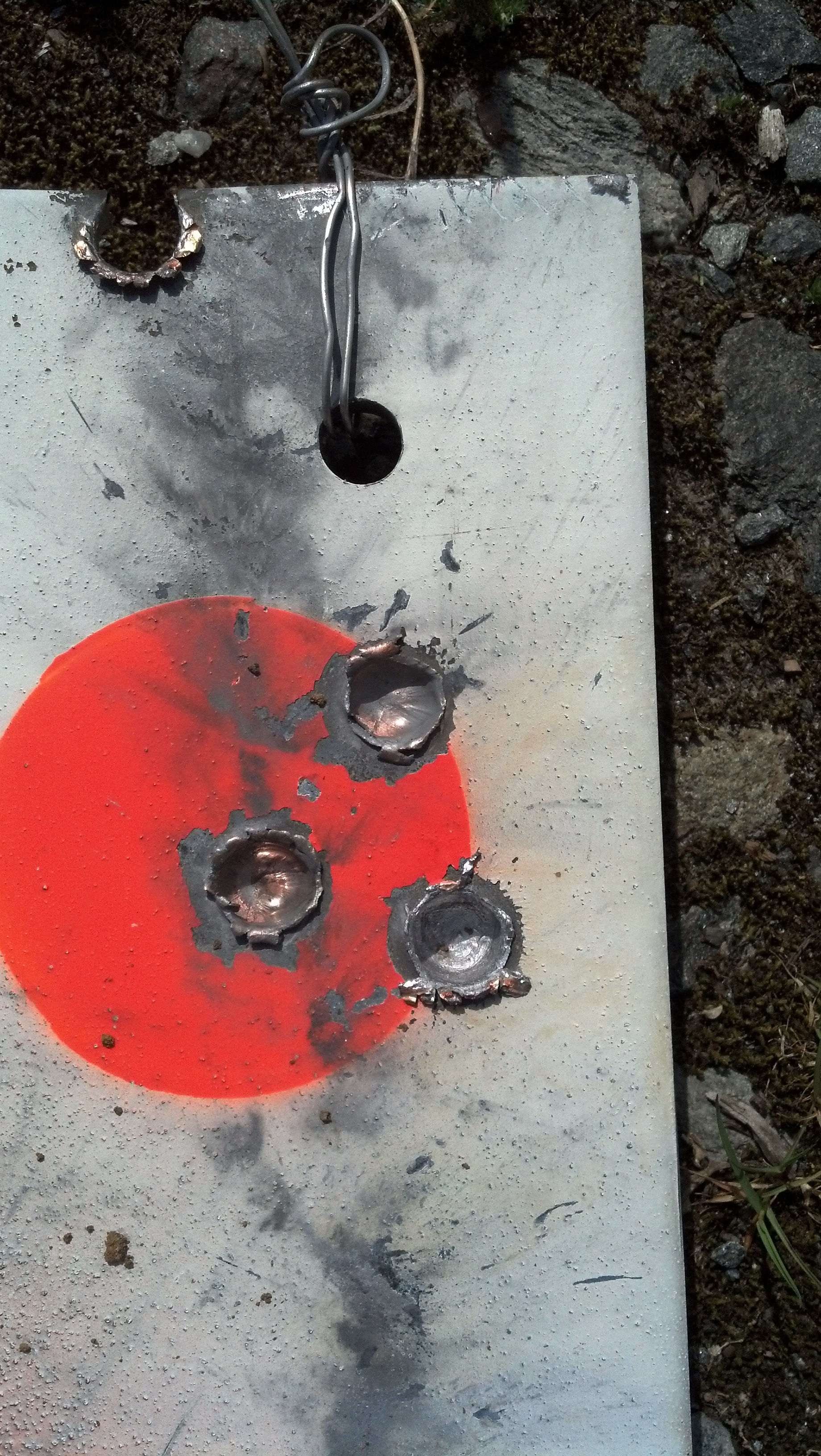

Ran this same load again today @ 300 yards. 3 shots - .525" (.167 MOA)
