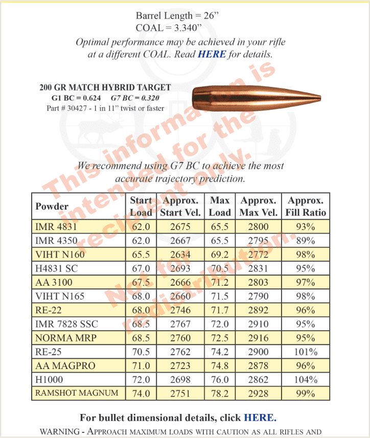

Look for some loads using the above in 308 Win and 300 WM. 1/10 twist. Not much out there that I have been able to find, so I'm hoping that some of you may be able to help. Thanks.
Awesome bullet for 300-WM ... I use this to shoot out to a mile all the time. It's a little "cryptic", so let me know if there's anything you don't understand.
I use the 200.20x and the 208 LRHT in a 300 WSM. Both shoot exceptionally well. About 3030 fps out of a 26" barrel with Reloder 26. I'm at 69.3 grains. I know it's not a win mag but pretty close in performance.
Reactions: Sgtsideways
Thanks to all for the responses. Rusty, the only two I can't decipher is the sh and neck. My guess is that the neck is referring to the loaded o.d.? Not a real lot out there on 308 Win, so I'll probably call Berger Monday. Right now shooting out to a mile is but just a pipe dream for the wife and I. Getting consistent hits at 1000 yrd steel is the current goal.
