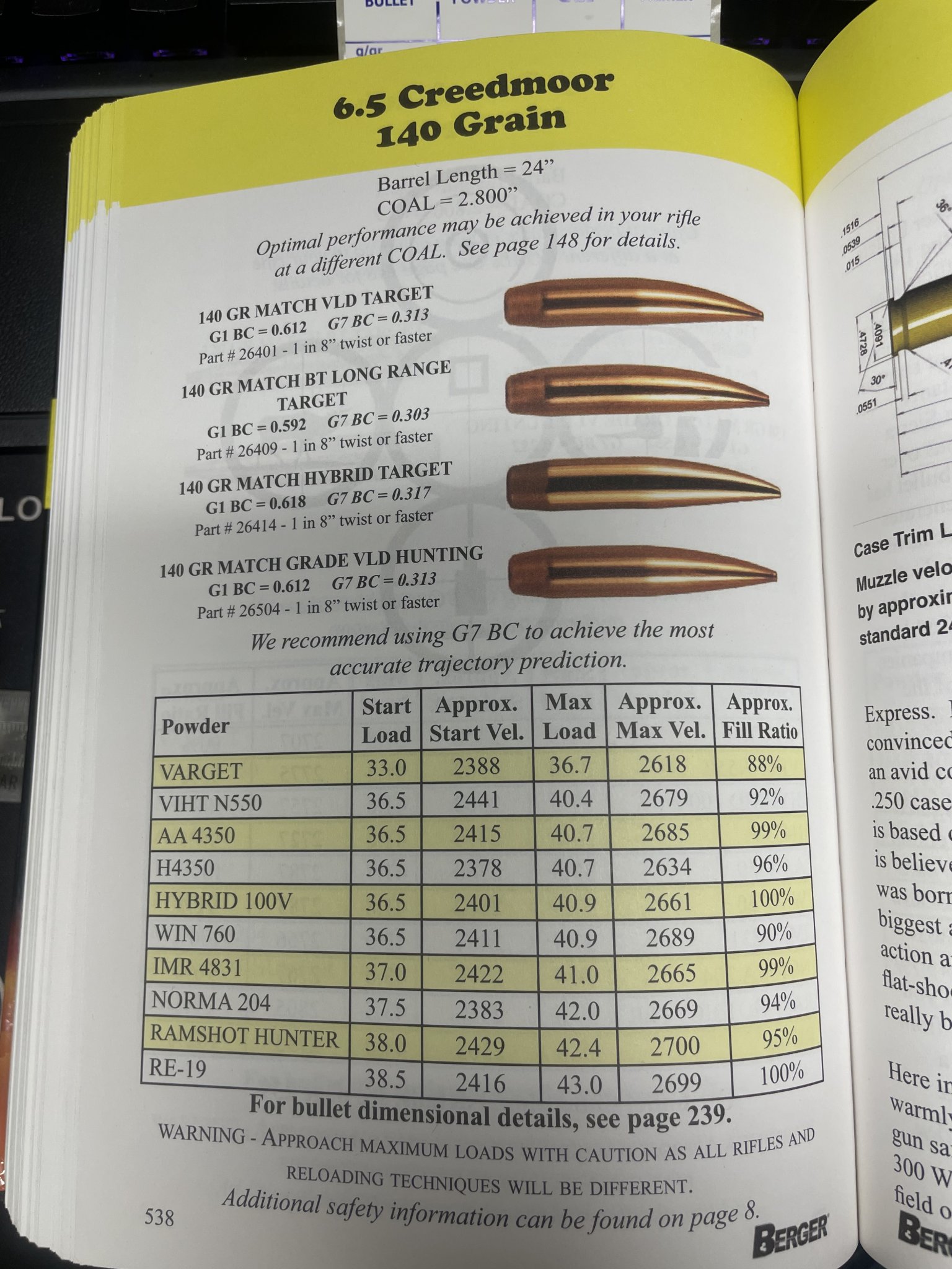

Looking to see if anyone has copied or has come close to the Berger factory 140 hybrid load for 6.5 creedmoor. I have the once fired brass, h4350, cci Br2 primers and the 140 hybrids on hand.

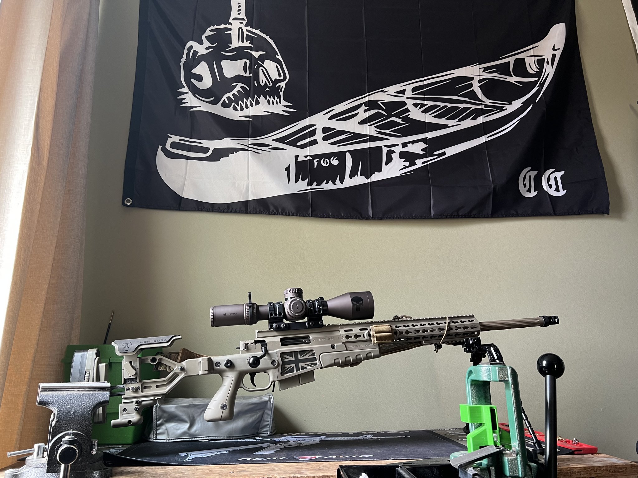

Join contest SubscribeI meant to put it’s the Lapua small primer brass and I have a AI AX rifle.OP:

FOR MY RIFLE: I would probably load x5 at 2.83" OAL (mag friendly) with 41.5 gr of H4350 with those components and shoot for muzzle velocity and group at 100y.
I know a shooter who uses 41.8 and those exact components in a bolt rifle, but brass volume matters, as does the chamber, distance to lands, etc...
Also, Berger loads VERY hot IMHO.
YMMV and work up carefully and all standard disclaimers apply Mr. Murphy.

41.5 is something of a known general middle node, there's a lower node and a higher node you can troll the 6.5 reloading thread on here for... maybe search for the tweaks with SRP vs LRP, but I'm not sure there's much difference there... I'm just cautious and load for middle speeds.
Report back, and WITH PICS of that AI and your groups once you work it out!
