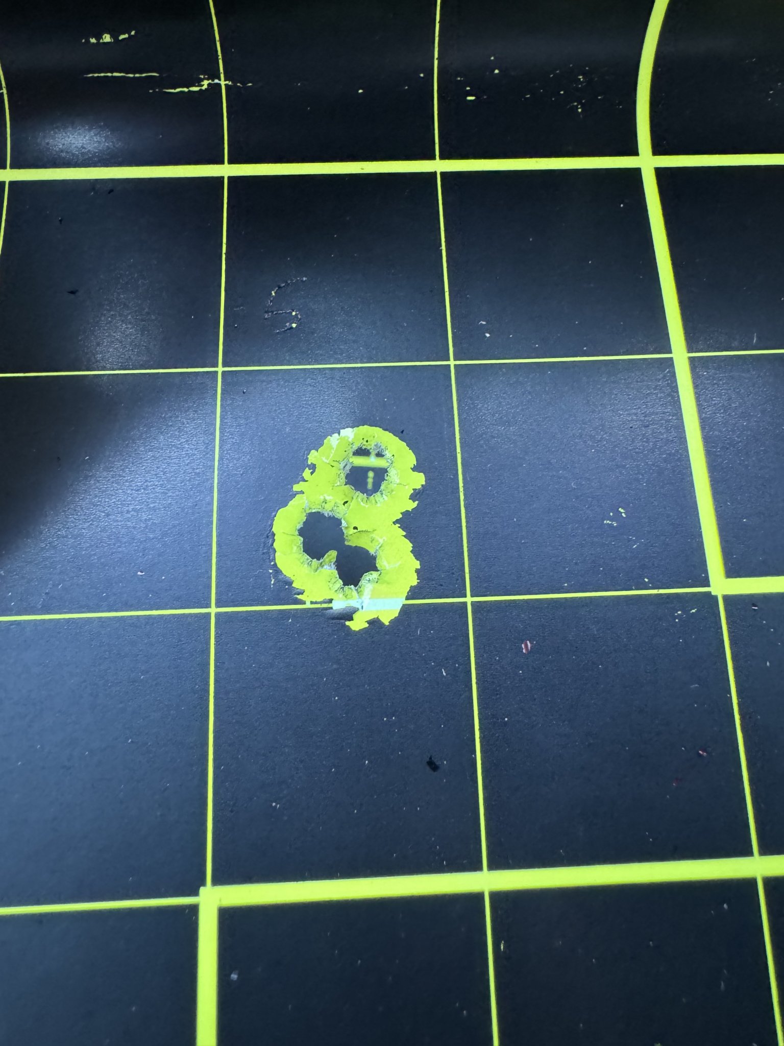

Ladder test was bad until I got to 56.5g of H1000.
My COAL with the Berger 156g EOL was 2.950.
I had zero pressure signs, and managed to shoot a 1.0” group at 100 yards once I hit 56.5g of H1000. Do you think I should give 57g, & 57.5g of H1000 a try?

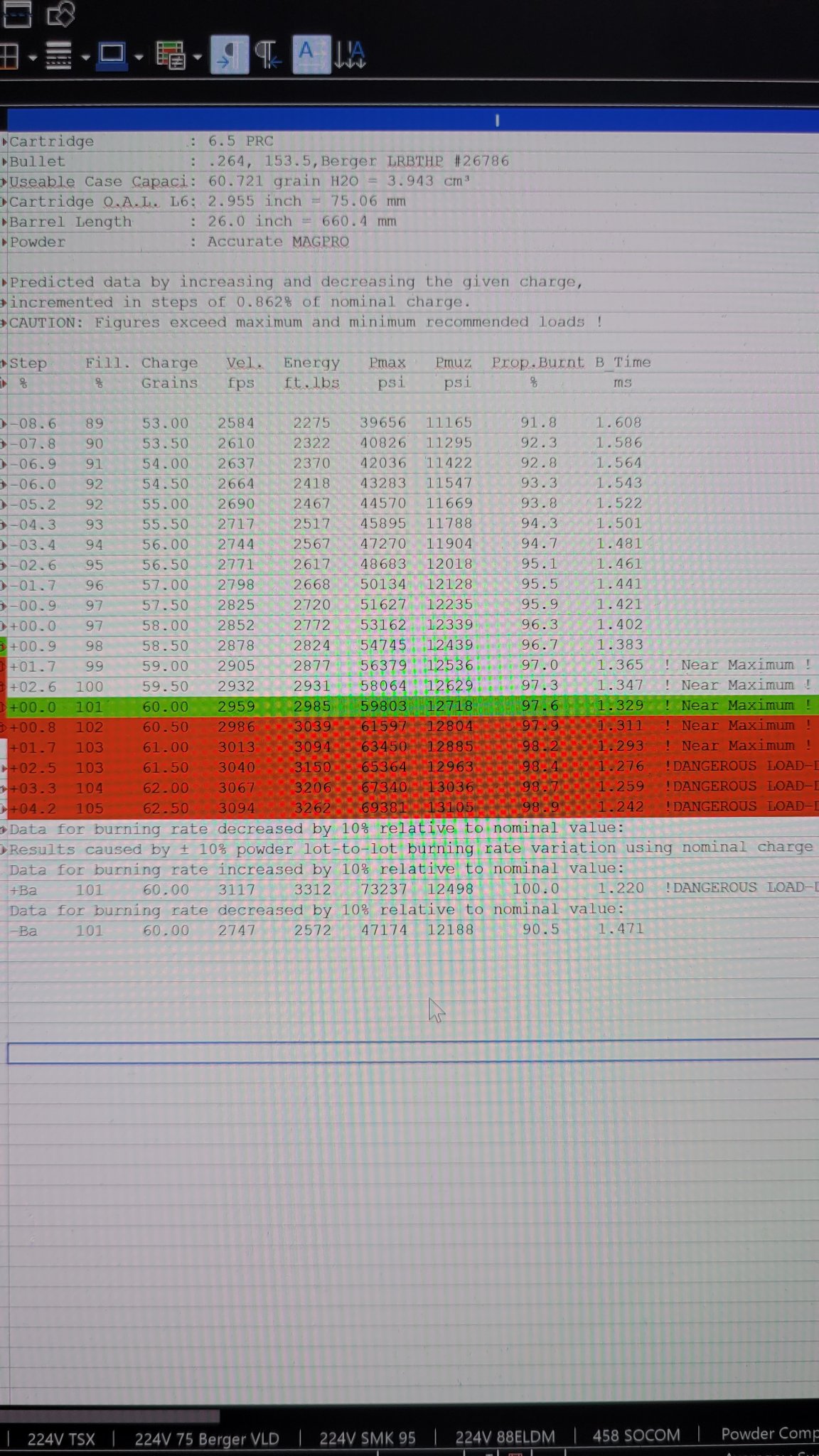

As long as I'm not seeing pressure signs, I'd keep going . . . if for no other reason than as a pressure test to see where the limit is.
Here's a guestament I put together to give you some kind of idea what your dealing with:

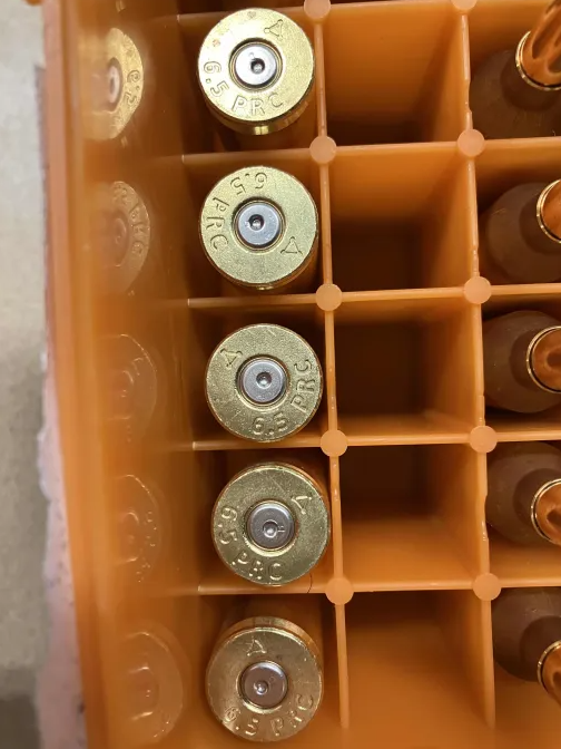

I just started loading 6.5 PRC for long-range target work. Usually I don't push speed, but for shooting at a mile plus I'll take as much as I can safely get.
Specs:
28” bartlien barrel
153.5gr Berger Hybrid
H1000
CCI BR2
Virgin ADG brass

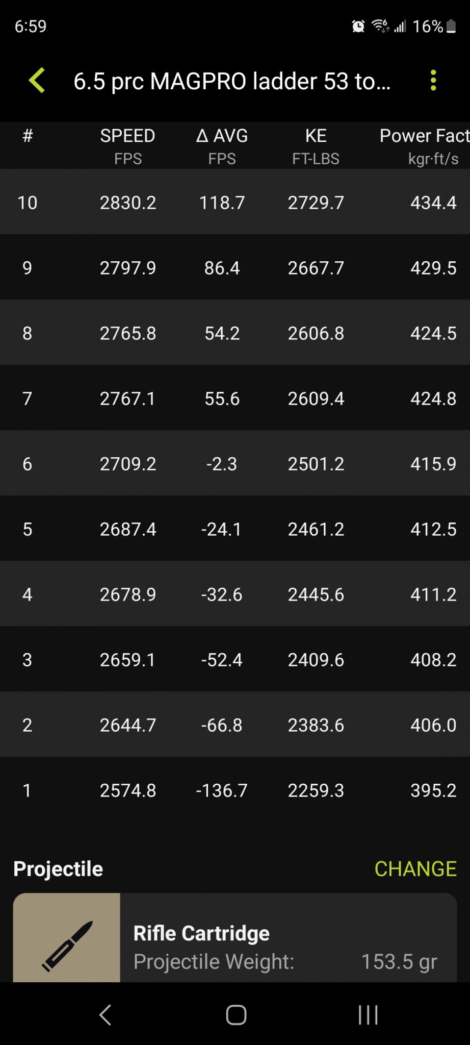

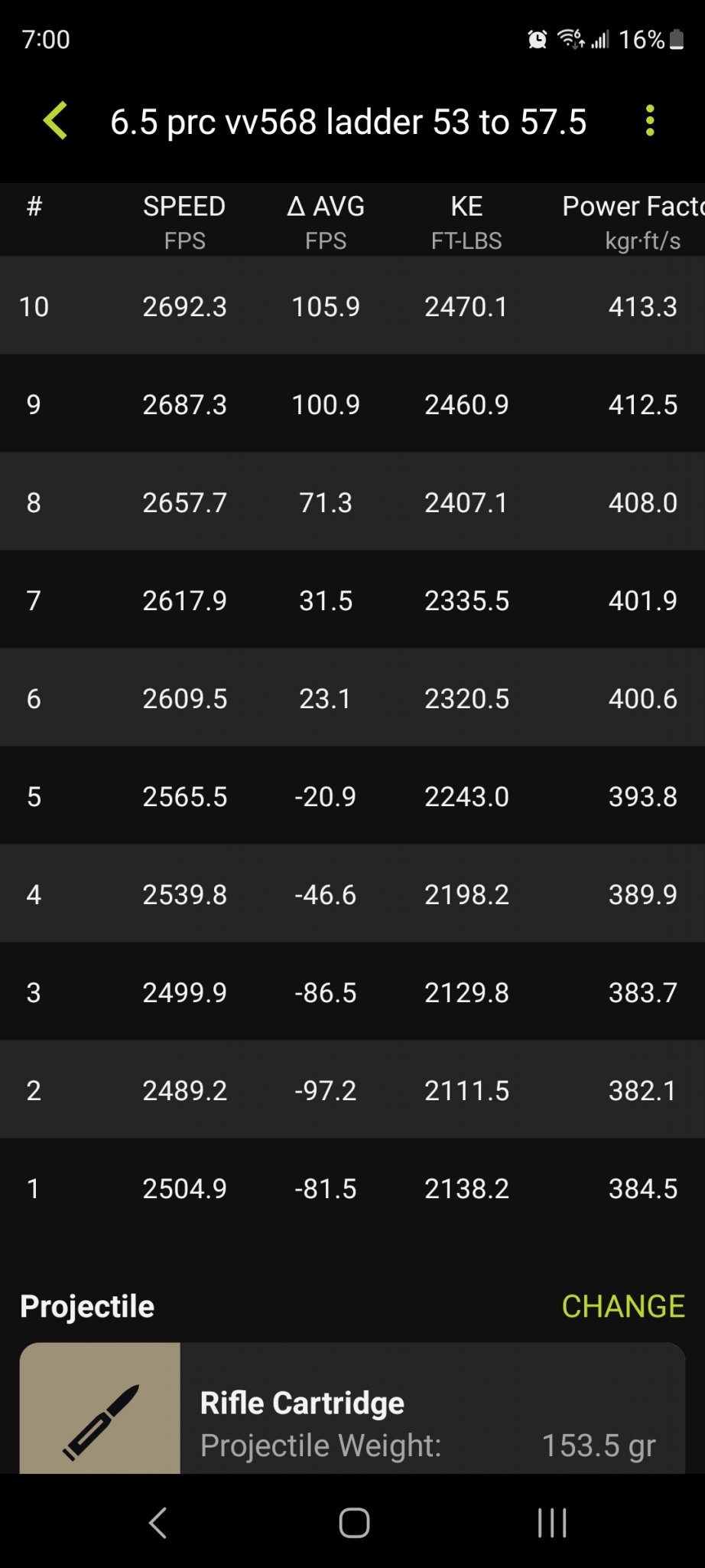

It was cold. About 42*F. But I just got the barrel back from the smith and wanted to try it out. I recorded all the rounds I shot that day with my magnetospeed. I'm a bit disappointed in the speeds I got. I had to go way over the book max in order to exceed 2900 fps. However, I see no signs of the pressure on this brass. Even though H1000 is considered to be temp stable, I'll be sure to run this test again when the weather is a bit warmer.
Top cartridge is the 57.4 gr charge. That’s the max book load. Then charge weights increase going down to 59.0 gr. I don’t see any primer cratering or ejector swipes and I didn’t have any heavy bolt lifts

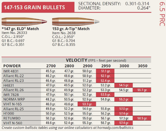

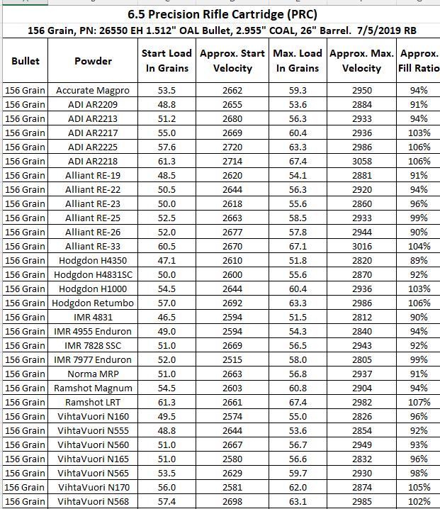

This is the data I could find from Hornady for the 6.5 PRC and 153 gr bullet. Am I insane for going 1.5 grs over book max when I see zero pressure signs?
Specs:
28” bartlien barrel
H1000
CCI BR2
Virgin ADG brass

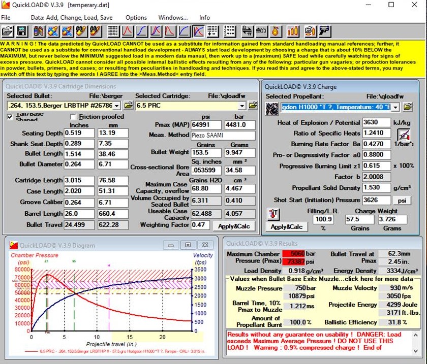

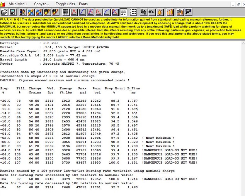

I am surprised to see those velocities that low. I am running 57.5gr H1000 in Lapua brass with 210M primers and the 153.5 Berger’s getting 3050 FPS in 26” barrel. H1000 is my go to in the case. Running 6 PRC, 25 PRC, and 6.5 PRC all with H1000.
On the other hand, your's surprises me and is pretty high from other's I've seen reported. What COAL are you using and what temperature were you shooting in for that velocity? Are you seating to touch or jam?
The only way it seems one can achieve such a velocity is if the powder has dried out some, increasing its burn rate. . .???
Hmmm???
Coal of 3.015” with shooting temps around 40*. Barrel has a few hundred rounds through it.
Hmmm??? Yeah, after "a few hundred rounds" I'd expect some increase in velocity, but . . . 250 fps increase? I use QuickLoad to help evaluate what's going on and very often the default burn rate in the app has to be adjusted up to fit the real life data so that any changes (le.g. different bullet, change in size of charge, seating depth, temperatures for shooting) produces more accurate predictions. With your 57.5 grs of H-1000 I'm seeing the case fill for a COAL of 3.015 is at 100.9%, which is actually where I tend to like to see my own case fills. To get to your velocity, I really have to bump up that burn rate! Then it shows some really high pressure readings at that burn rate.
I'm not doubting your claim or trying to be critical, just trying to understand why such a difference. Here's what I'm looking at:

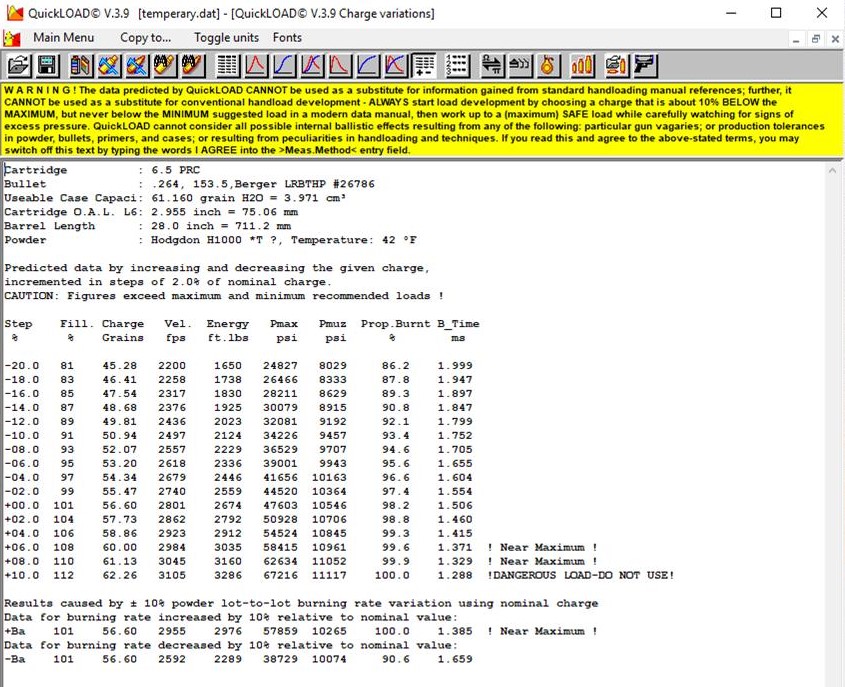

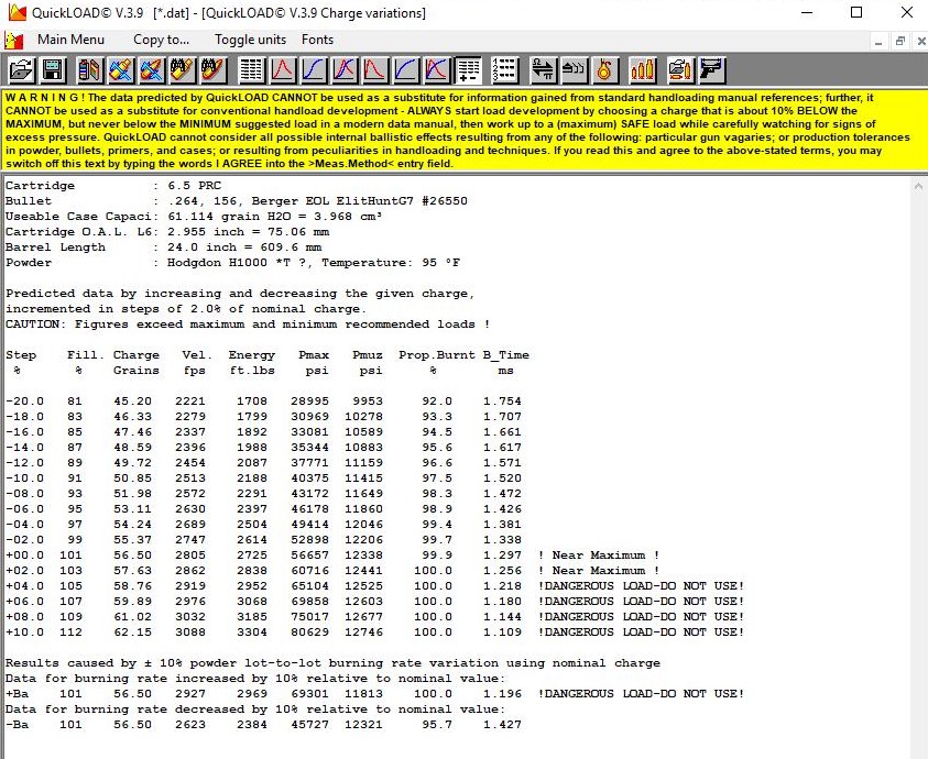

From your info. . .
And here's from the default burn rate. . .

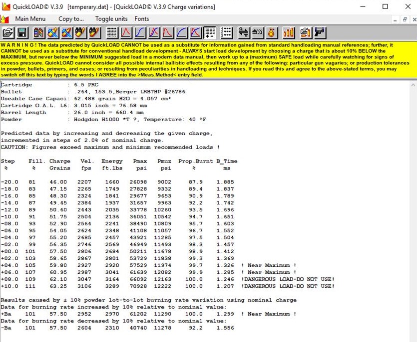

If it’s not too much work, would you mind posting this data at 2.955” COAL with the 153.5 Berger, H1000, and 28” barrel? I appreciate you sharing your experience
OK, but keep in mind this is only giving you kind of a ball park idea of what you're dealing with. The number aren't as good as I like as I don't have your actual velocities you recorded for the charge weights AND I used a case volume for ADG brass I've acquired that's very like different than what yours actually is (case volumes can vary from lot to lot for any manufacturer).
So, here you go (and Merry Christmas :)):
Thank you! And a Merry Christmas and a Happy New Year. Having this info as a reference will be nice. I understand that this is just an estimation and may not be 100% accurate. I am still going to do my due diligence.
That being said, those velocities line up pretty close to what I was seeing! Its reassuring that the software agrees with my lack of pressure signs. The barrel is young, so I expect it to gain a bit of speed. This is my first cut rifle barrel, but my button rifle barrels always took about 100 rounds to settle down. It will be useful to know approximately what fill % I am at. At some point I'll get around to measuring the volume of my ADG brass and I can calculate the actual fill percentages from there.

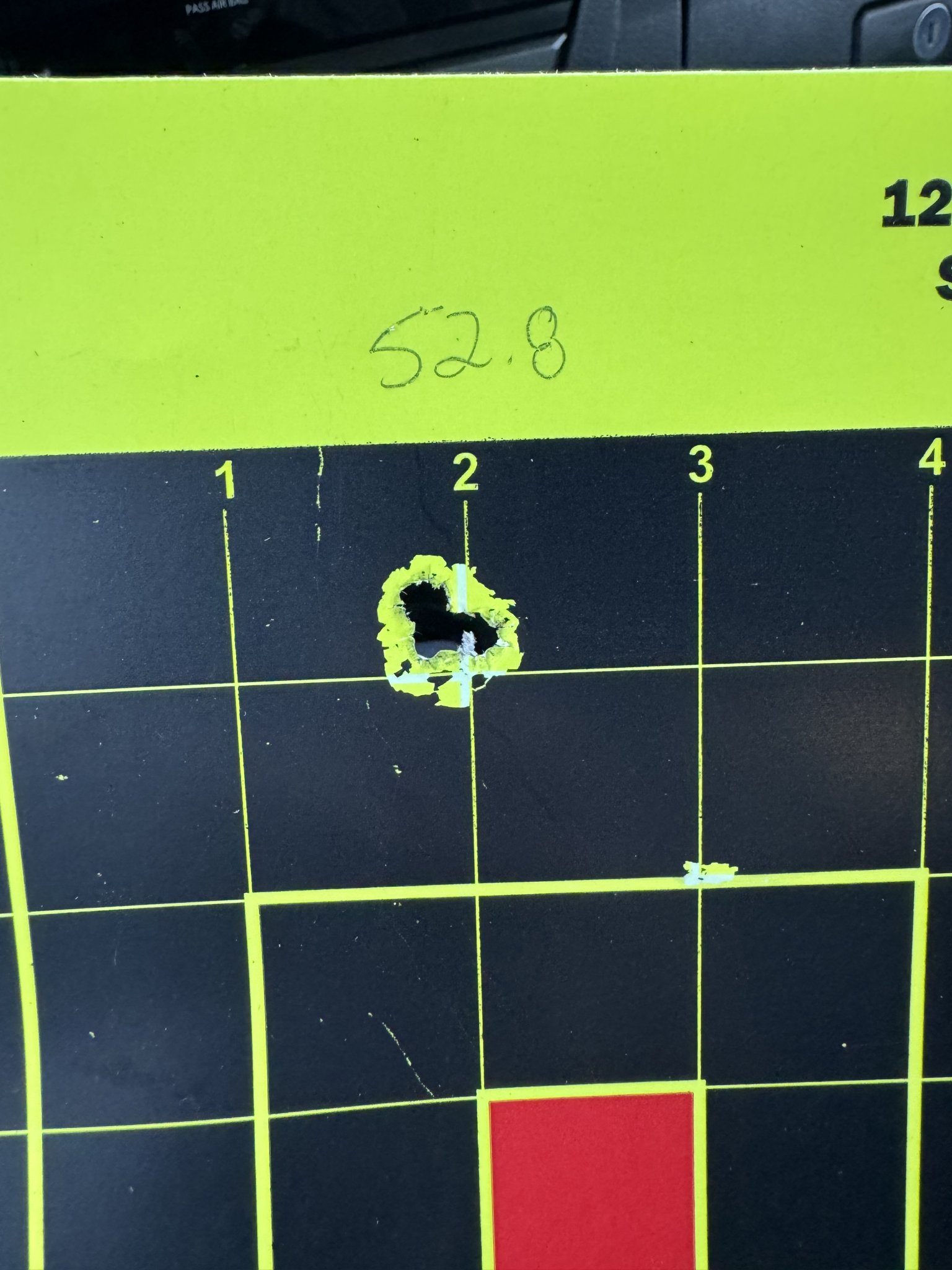

Really good SD's! How did each of them group?
To be honest, I’m new to reloading and was doing a ladder for some hammer bullets first and ran out of targets (poa) after a couple charges of the Bergers. This was the best group I shot out of the bergers that had a decent aiming point. Definitely not anything to brag about.
What I did find interesting was that the SD of the hammers was much higher but the groups were tiny. Although they were 3 shots compared to 5 of the bergers. And they were using RL26

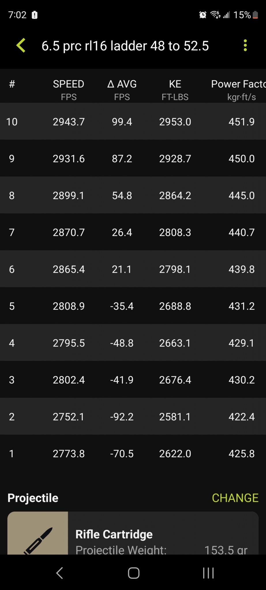

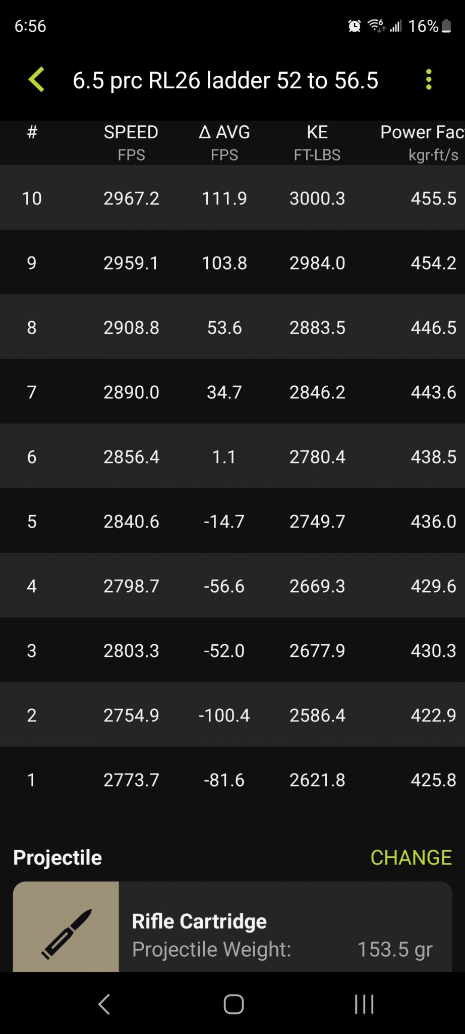

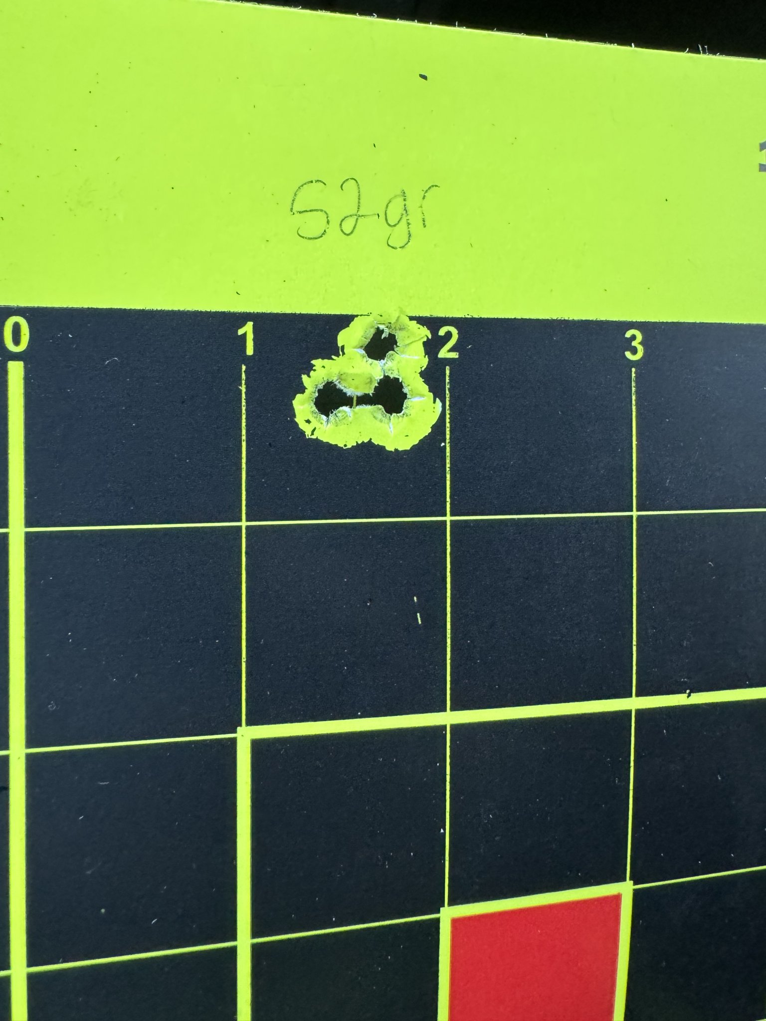

View attachment 8340449View attachment 8340450View attachment 8340451
52.8g's is looking good! I'd load up 9 rounds of 52.8g and confirm it to see if it shoots a hole like that consistently with those SD's.

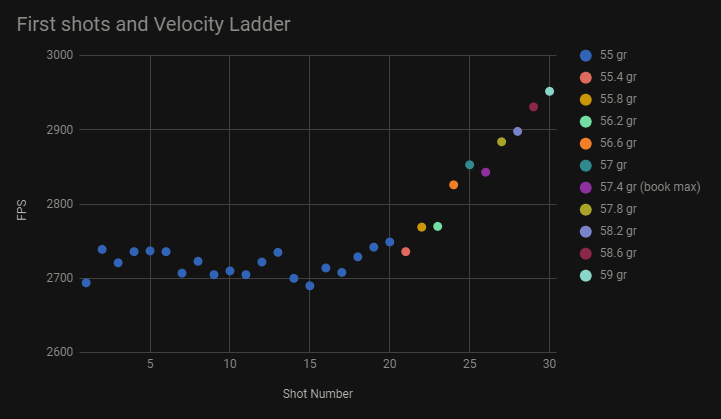

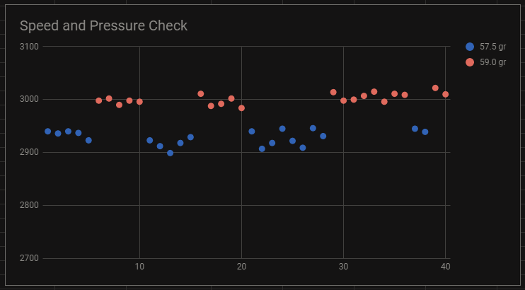

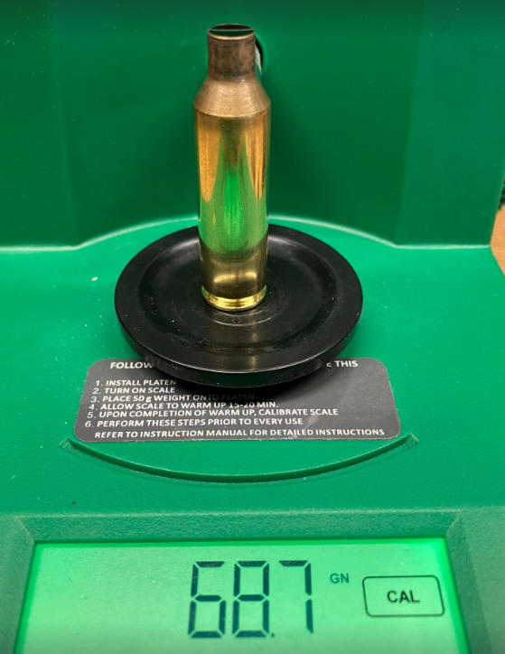

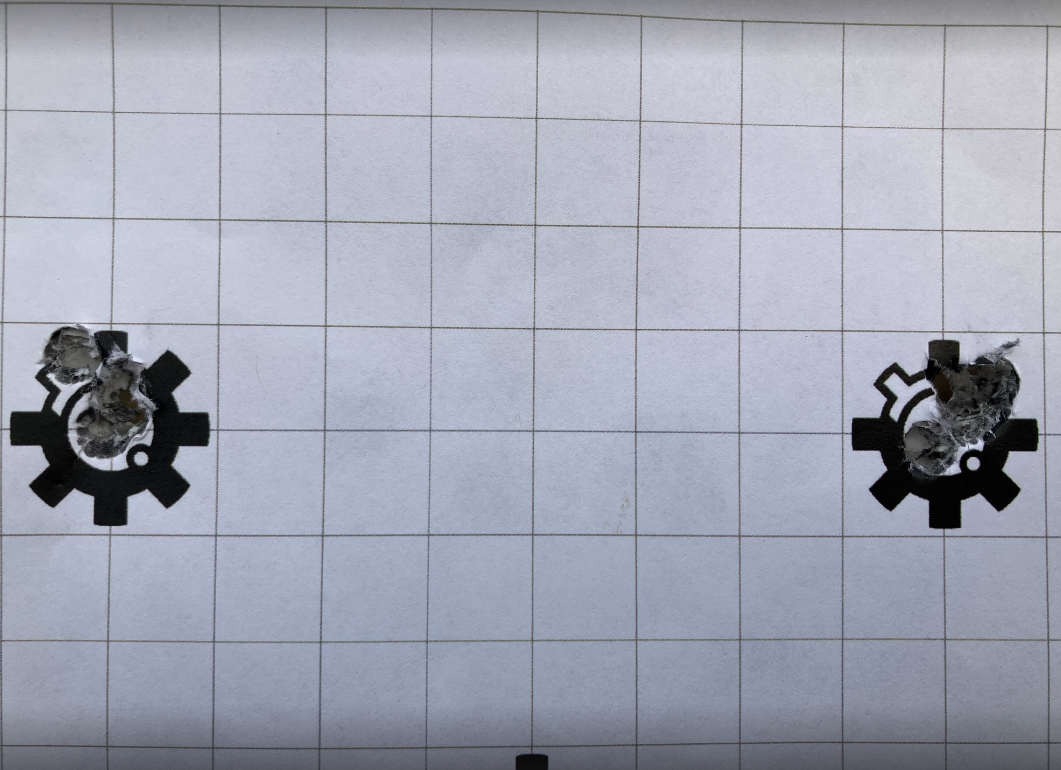

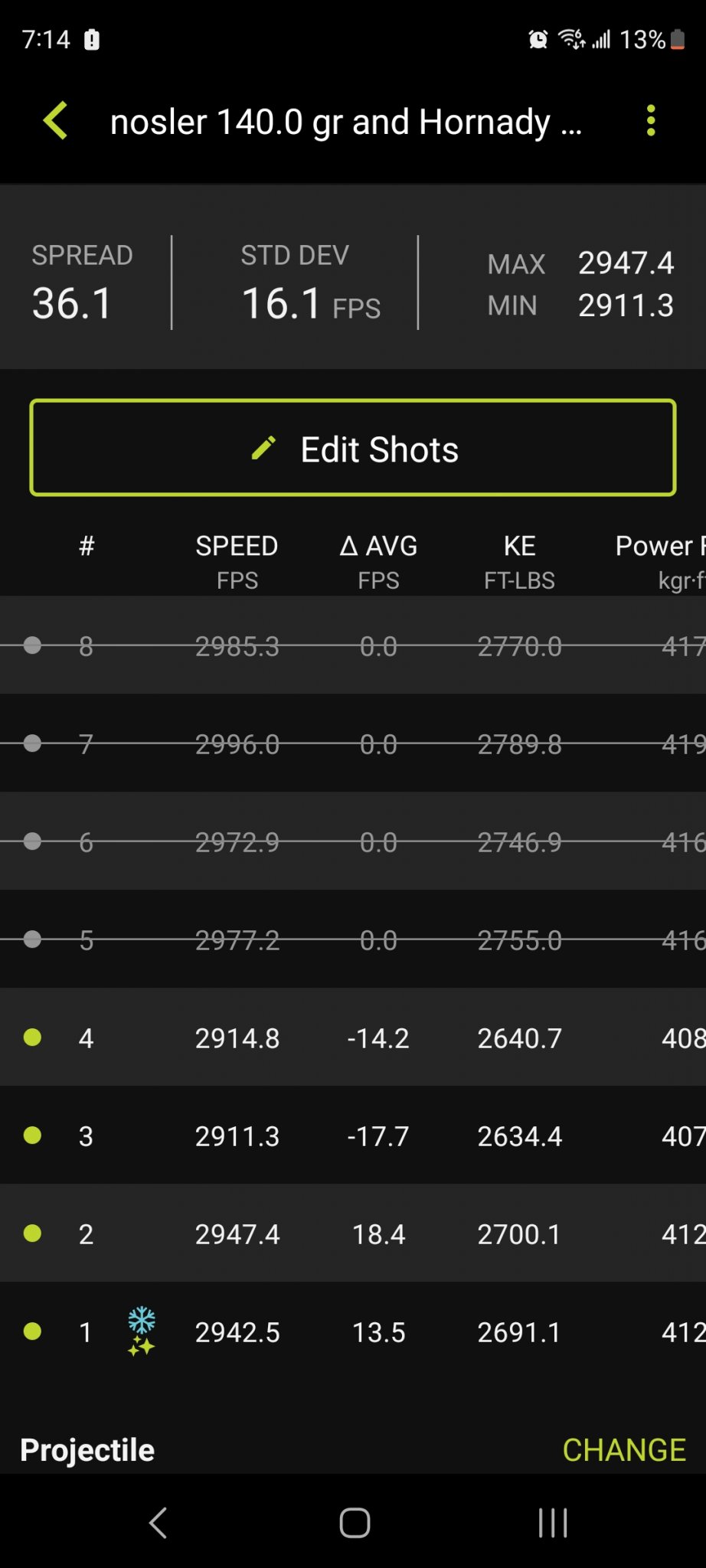

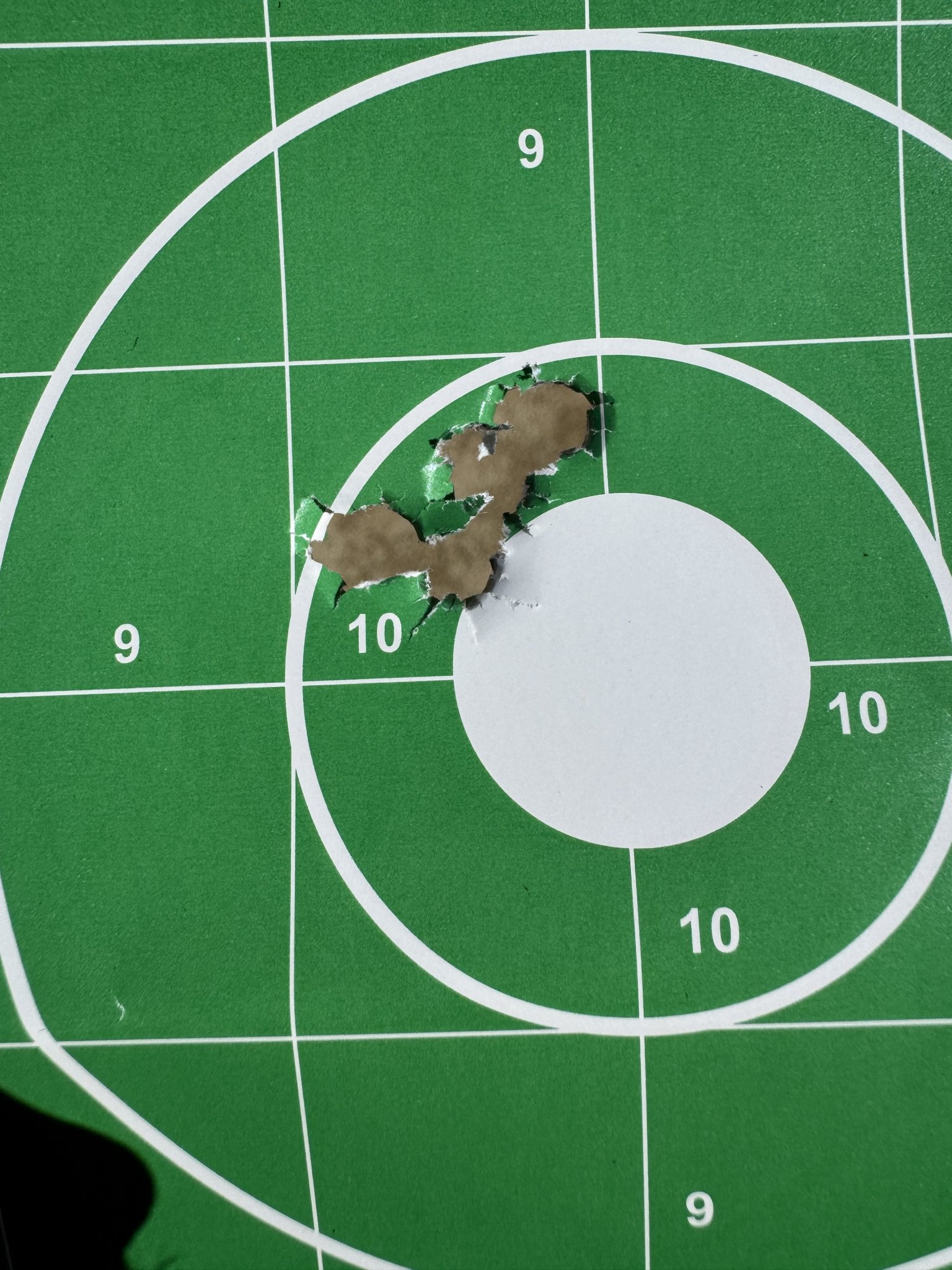

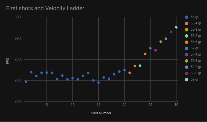

Finally got in a range trip today. It was 61*F. Still cool, but better than the 40s. Today I compared 57.5gr vs. 59.0gr of H1000 with 153.5 bergers in virgin ADG brass with CCI BR2 primers. The brass was chamfered, neck lubed, and expanded with a .262" mandrel before loading. Rounds were seated to a CBTO of 2.246" +/-.001". This results in a COAL of 2.950"-2.960". I ran everything out of an AICS short action mag today and had zero feed issues.
First off, I measured the capacity of my brass. Once fired, unsized brass has a capacity of 68.7gr of H20.
These rounds were loaded about a month ago. Since they are compressed, I was worried the compressed powdered may push the bullet out with time. I checked the CBTO before I left for the range and everything was 2.246" +/-.001" as it should be.

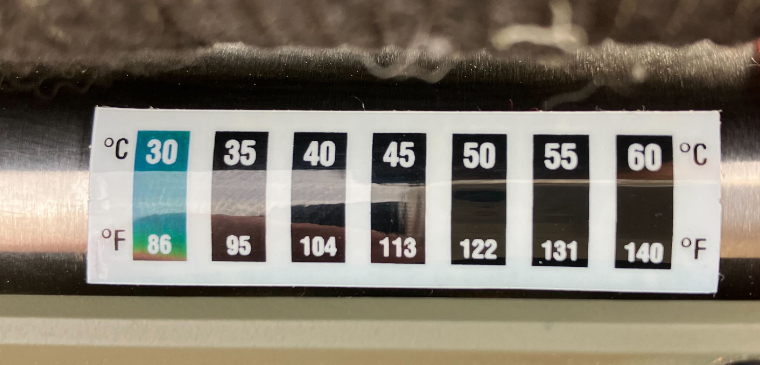

I ran the same test with each charge weight before moving onto the next test. I have a temperature sticker on my barrel and I left it cool down to this point before each test.
The order of my tests:
- 1st test: 5 shot group. I shot slowly and inspected each piece of brass as I shot it.
- 2nd test: 5 shot string. I broke a shot every 10 seconds to simulate a match-like environment.
- 3rd test: 8 shot string. Same as before. 1 shot every 10 seconds.
First off. Holy shit. What even is the point of seating depth tests. These were my two 100 yard, 5 shot groups from the 1st test. 57.5 gr on the left. 59.0 gr on the right.
57.5gr averaged 2927 FPS over the day and 59.0 gr averaged 3002 FPS. This is out of a 28" barrel that after today, has 80 rounds on it. Both of these averages are at least 50 FPS faster than when I ran my velocity ladder a few months ago in 40* weather.
I saw no pressure signs on the brass. For the most part, the bolt lift always felt fine. This is very subjective, but the bolt lift may have got slightly stiff towards the end of that 8 round string with 59.0gr of powder. This is anecdotal evidence at best, but I will still probably play it safe and stick with 57.5gr of H1000. The barrel will probably speed up a bit more, and on a warm day, 2950 FPS will be sufficient. If that sticky bolt lift does become a problem, I don't want to risk it with the 59.0 gr charge. 50 extra FPS isn't worth having problems during a match.

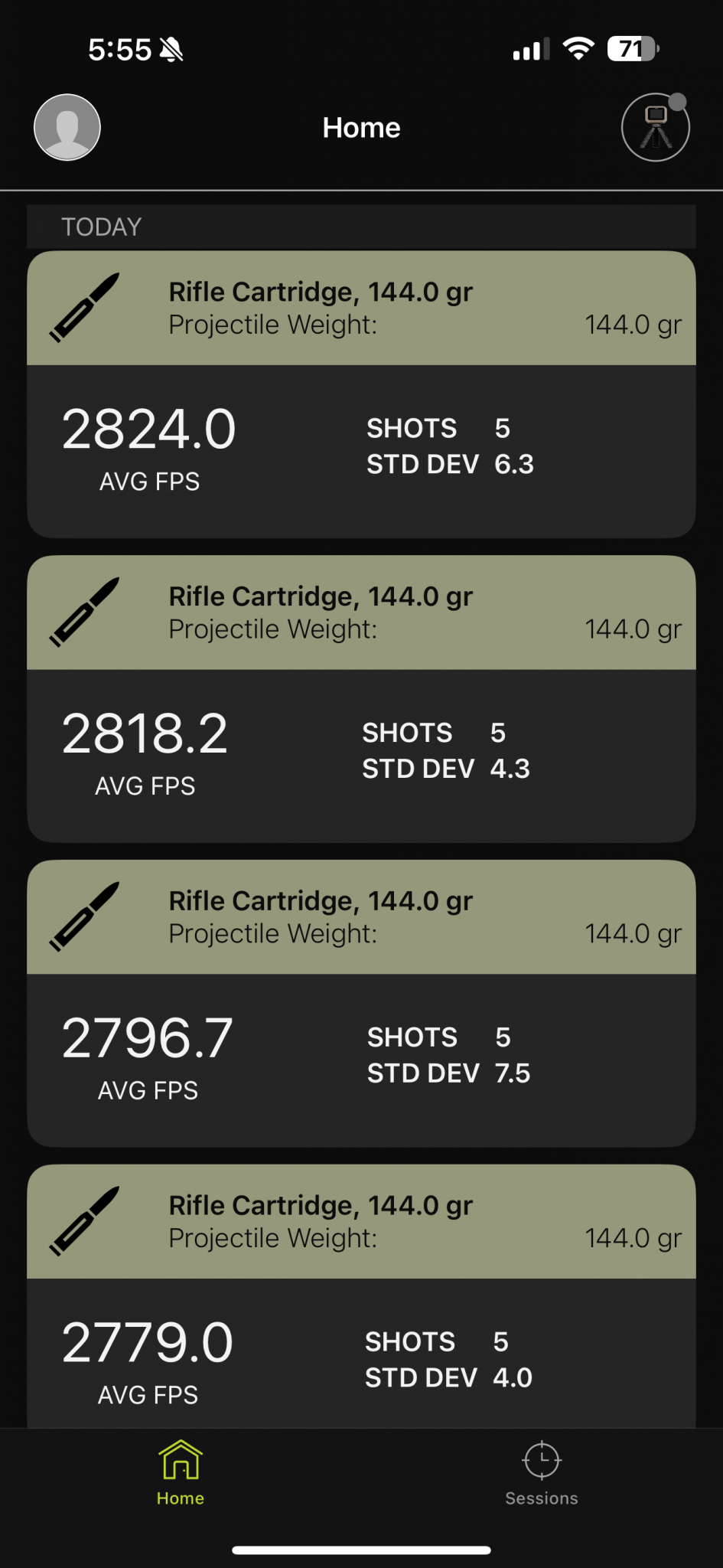

Here's the velocity data. The SD and ES of each charge weight was a bit sporadic. I am hoping this improves with time. The barrel is young and I've had past barrels behave similarly. Also, with other cartridges, it seems like my velocity data got more consistent after the brass had 1x firing on it, but I have never collected data on this. 57.5gr had an SD of 14 and ES of 47 for the day and 59.0gr had an SD of 10 and ES of 38 for the day These are close enough in my opinion to be treated as the same.

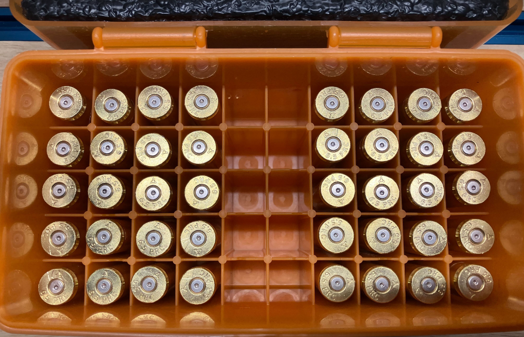

And here is the fired brass. This all looks fine to me:
Excellent man! I'm itching to load for my new 6.5 PRC using the same 153.5g projectile, but Lapua Brass instead of ADG. 2.950 COAL is what I'll be using as well. Nice shooting @Overclok79 and solid groups out of your rig.
This is my ladder test for RL26 with Berger 153.5 in a 26 inch barrel 1:7 twist. No pressure but my QL trued ba for this cartridge puts the 56.5 near max pressure.
This is the MAGPRO ladder to 57.5.
QL trued up ba shows I can go up to 60.0 grains before near max pressure.
Vihtavuori n568 ladder to 57.5.
QL says I cannot fit enough into the case to over pressure. Says I can get over 3000fps before max pressure.
This one is RL16 from 48 to 52.5. slight heavy bolt lift at 52.5. QL says this is max pressure load already. I would back it down to 52.0.
Lastly I tried h4350 from 45.5 to 50.0. also slightly heavy bolt lift at 50.0 and QL says it's at max pressure.
All of these QL max pressures are calculated after trueing up the ba to my velocities.
Also forgot to mention, the brass is Lapua 6.5 prc brand new, and all ladders are in .5grain increments. Brass prep only consisted of putting an expander ball through the neck to round it. Primers are CCI LRM. Temperature was in the high 60s to low 70s. No pressure markings on any brass and only the two heavy bolt lifts (very slight).
Barrel is brand new and essentially the ladder started after 13 factory rounds as foulers.
QL truing uses a 68grain case capacity as opposed to the default 65ish. Quickload Ba for each powder was adjusted to get velocities matching the actual velocities to calculate where max pressure will be.
The loads near max pressure shows the barrel time to match an OBT node.

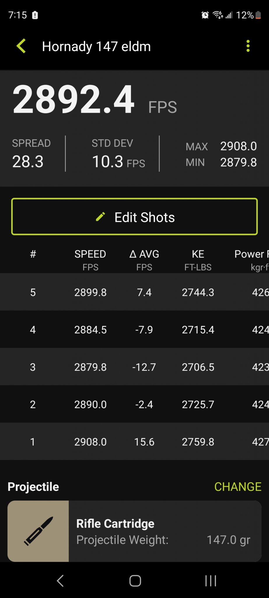

In comparison these are the factory round foulers. Many of these factory rounds had heavy bolt lift.
Nosler 140 and Hornady 130 cx.
Hornady 147 eldm
Though I haven't used MagPro for my 153.5's, using my "trued up BA" for 140 SMK's that I've used MagPro on, looks like my lot of MagPro might go up to just over 61 grs (at the COAL that I'm seating my 153.5's, anyway).
Such ladders are good for pressure testing, and that about it. So, I'm wondering, is that what you're doing?
Yes I am pressure testing and getting a gauge on what velocities I will get.
Also forgot to mention coal, I'm using 2.955.
My MAGPRO trued ba is .3100
My 60.0 grain estimate is for 60k psi not 65k. Gives wiggle room for hot days since MAGPRO is temp sensitive.

I bought a box of 156gr to try out and ran a couple ladders. The ladder with h1000 showed pressure (heavy bolt lift) so I stopped at 56.7gr with a MV of 2825.
The ladder with rl26 found a winner that I’ll be experimenting more with. 54.5gr for MV of 2854.

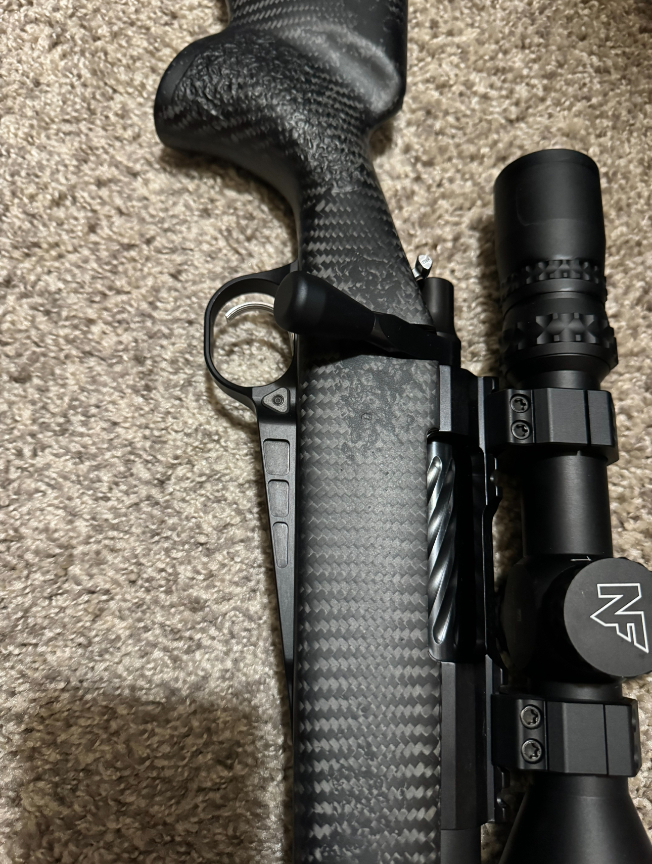

These have a COAL ~3.02 so I ordered the unknown munitions bottom metal and mag to replace my Hawkins but currently having issues getting it to fit properly.
Edit: 20” Bartlein gain twist barrel

Not sure about your bottom metal, but was your stock cut for the UM bottom metal?
I have no complaints about the GT barrel but I also couldn’t tell you if it’s better, worse or the same as non-GT. I just wanted to try one out.
I got up to 2912 fps with 55.7gr of RL26 but I’m hoping to get a little more barrel life with less powder.
UM bottom metal is a M5 pattern but I did have to open up the stock load port a bit with a dremel. Trouble I’m having is the magazine seems to be hitting the back of the action. May end up taking it to a smith.

153.5 LRHT
H1000
210M
Lapua 4PH6023 unfired, 68.8gr H2O, graphite, mandrel to 0.002 interference
~2.965 COAL for ~0.090 jump in a 0.163fb (I'll have to check this again)
25" CFW 1:8.25-7.5" left hand gain twist, 25rds on barrel @ start
55.65gr 2780fps
56.37gr 2850fps
57.74gr 2920fps
5 shot group SDs all 8-9fps.
I still had about 10% that felt much more difficult to seat & initially seated .020 longer. Primers all fine, no wipes. No compressed loads, although the 57.74 is very close. Hoping to retest @ 2.950 COAL this weekend.
Is double seating a thing for loads that are close to compressed? E.g. seat 0.050 or 0.075 longer than intended, shake the round to redistribute powder around the boat tail prior second seating, then reseat to final depth.

Also, @R_A_W I plan to use the follow powders, and components:
Berger 144 LRHT - N565 - fill ratio 103%
Berger 156 EOL - N570 - fill ratio 106%
Notice that the powders based on the projectile I'll be using have fill ratios of 100% or +100%
