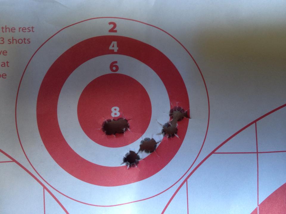

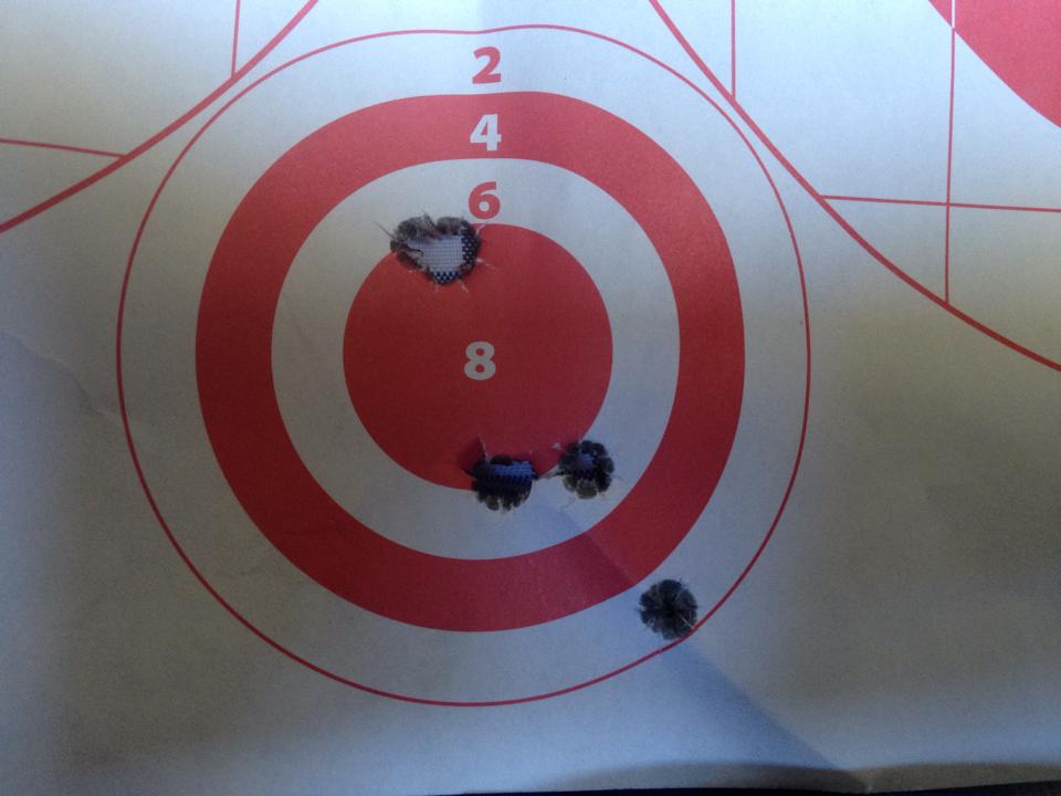

Savage 6.5 creedmoore w/ Burger 140g Hybrid VLD
This was some groups I just shot last week. The first two groups where really bad because I never shot from a bench. I couldn't get the rear of the rifle stable do to the tall bipod and so the first two groups suffered tell I figured something out.
140g Hybrid VLD
H4350 40-41.5 (still going up tell I see pressure signs)
CCI large primers.
Nosler Brass
OAL is 2.890
Two of these groups measured less than .3
