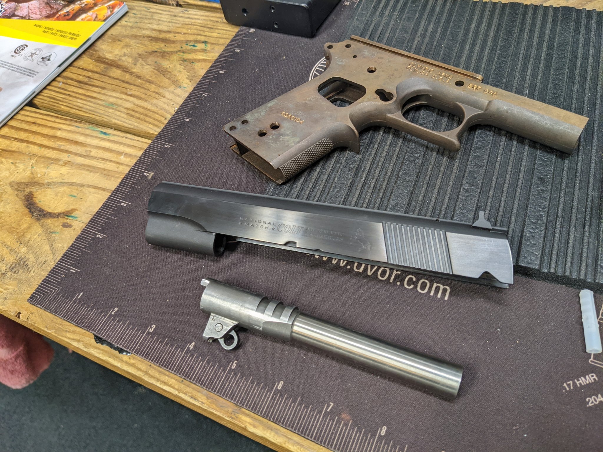

    At the suggestion from @sirhrmechanic , I'm going to start a build thread on building and finishing the 1911 frame I've acquired that's an Olympic Arms Beryllium Copper frame.

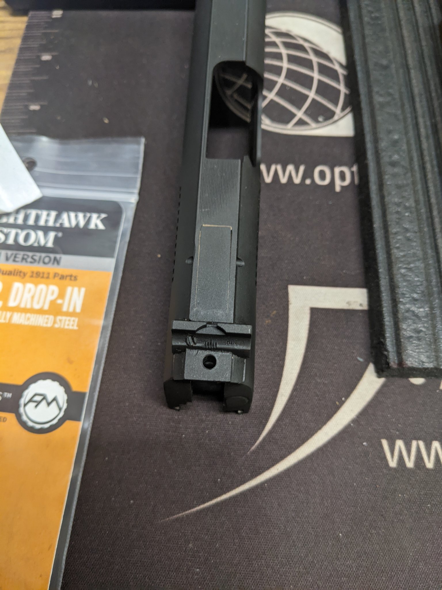

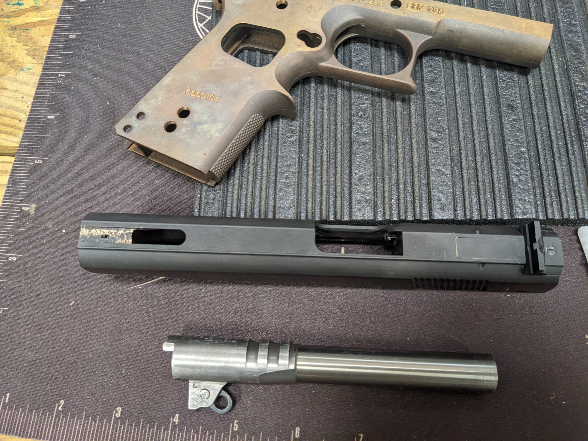

    I've sourced an older vintage Colt National Match slide, and hopefully some of you guys can give input on it and or other various parts and items I'm planning on. Currently, I'm working on fitting the barrel to the slide, which takes time and patience. Still need to fit the locking lugs and locking depth.
    One specific item I'm curious about is a front sight that's missing from this slide. The rear is a King and I'm guessing the front might have been a King reflective?
    Anyway I'll do my best to update with pictures as I work through it.
    Disclaimer: I am aware of the health hazards of Beryllium Copper dust and will take precautions throughout the process to handle it accordingly. Masks, oil, vacuum etc.

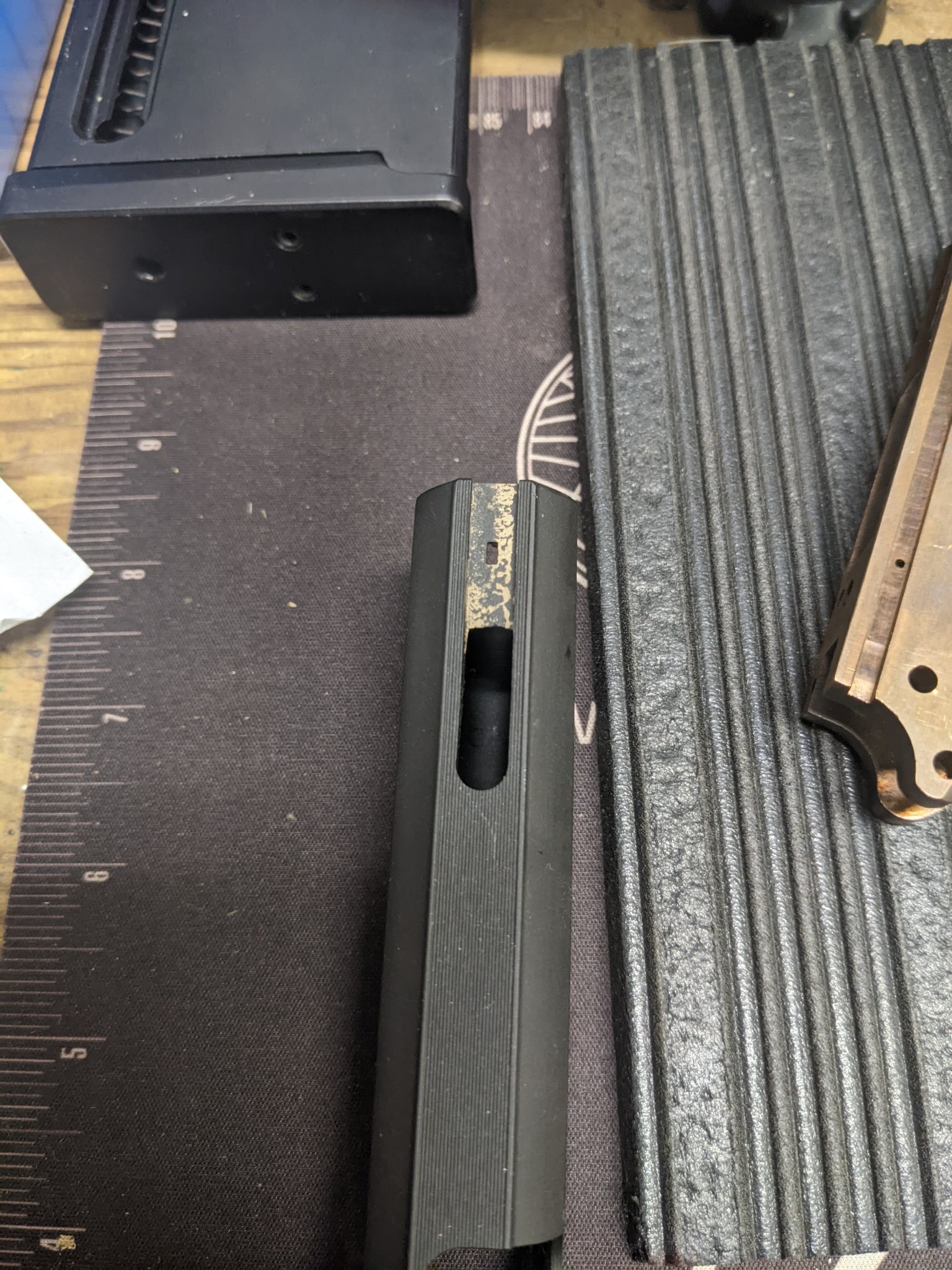

    @buffalowinter any idea what the front sight was? Possibly a King reflector that someone removed?
    The slide has been modified…. Are there any off the shelf parts to restore front sight?
    I'm okay with there being a void or hole in the slide, will be like it's own form of a cosmetic porting. I'd like to get a sight I can stake, and that will fill the width of that groove.
    I'll go on the hunt for another King sight and see what I can find but any help from the specialists here is always welcome

    here is my current order of operations, basically working top down.
    1) fitting barrel to slide, barrel hood, locking lugs, barrel-to-bushing fit, and find a front sight.
    2) fitting slide rails to frame. its currently too tight to slide onto the frame. the frame rails are too think and too wide. i will be removing copper from the rails. safety abounds during this process!
    3) plan to fit beavertail grip safety and MSH. grooves and frame have machining rough edges and that will need to be smoothed and polished.
    4) i have some very nice figured burl walnut grips that need a slight modification on the safety lock inlet. will modify as needed.
    Those are my main goals for the immediate future and i will update as progress gets made.

    Come on your slide is 3/4's of the way to a sight tracker / Schuemann hybrid barrel! Why stop now? :)
    None of my business but just a suggestion here. Great build be the way.
