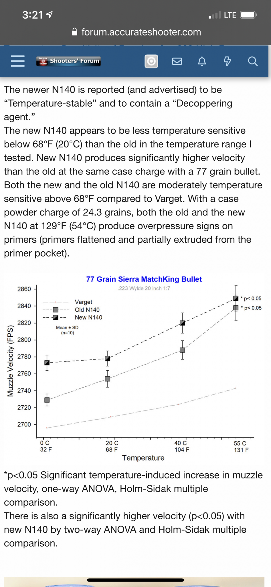

I haven't seen much about flash(which a good MD handles alot of that, but thier are a few short barrel pistols in use too). Are the V N133, N135, and N 140 temp stable? I'd rather minimize any poi shift from winter to summer conditions.

The velocity variation really depends on the distance you will be shooting. With a 100 yard zero, a difference of 100 FPS will be less than an inch at 200.

Living somewhere where you can have an 80° difference between summer and winter temp sensitivity is always on my mind, to the point that I'll give up a little velocity for better temp tolerance. Up until recently I primary reloaded for ARs and M1s (Garand and carbine). I've used H322 with good success in mid-weight 5.56 and heavier 6.8.
