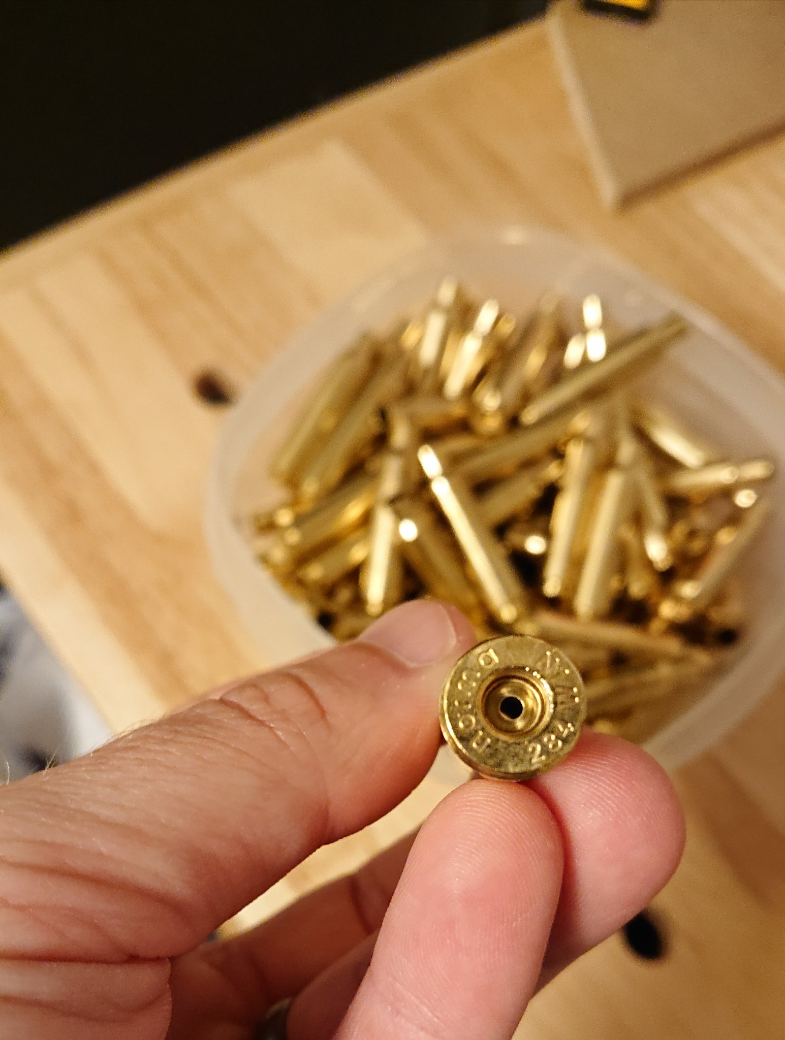

I recently bought 100 Norma and 185 Winchester cases off a guy. All new cases but I don't have a barrel yet to test any. I'd like to choose one brand and stick with it and sell the other, any thoughts? I'd like to have ~250 in the end, so added cost to buy more is a factor but not a large one.
