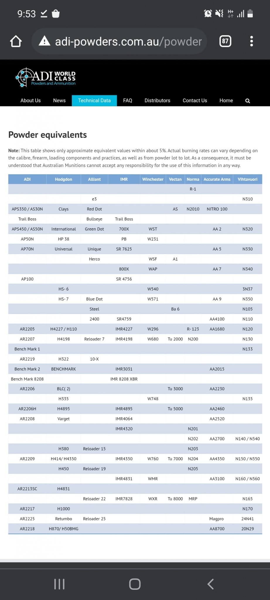

    AR2225/Retumbo best or A2217/H1000
    I think you could get much more speed for equivalent pressure with those in winmag too.

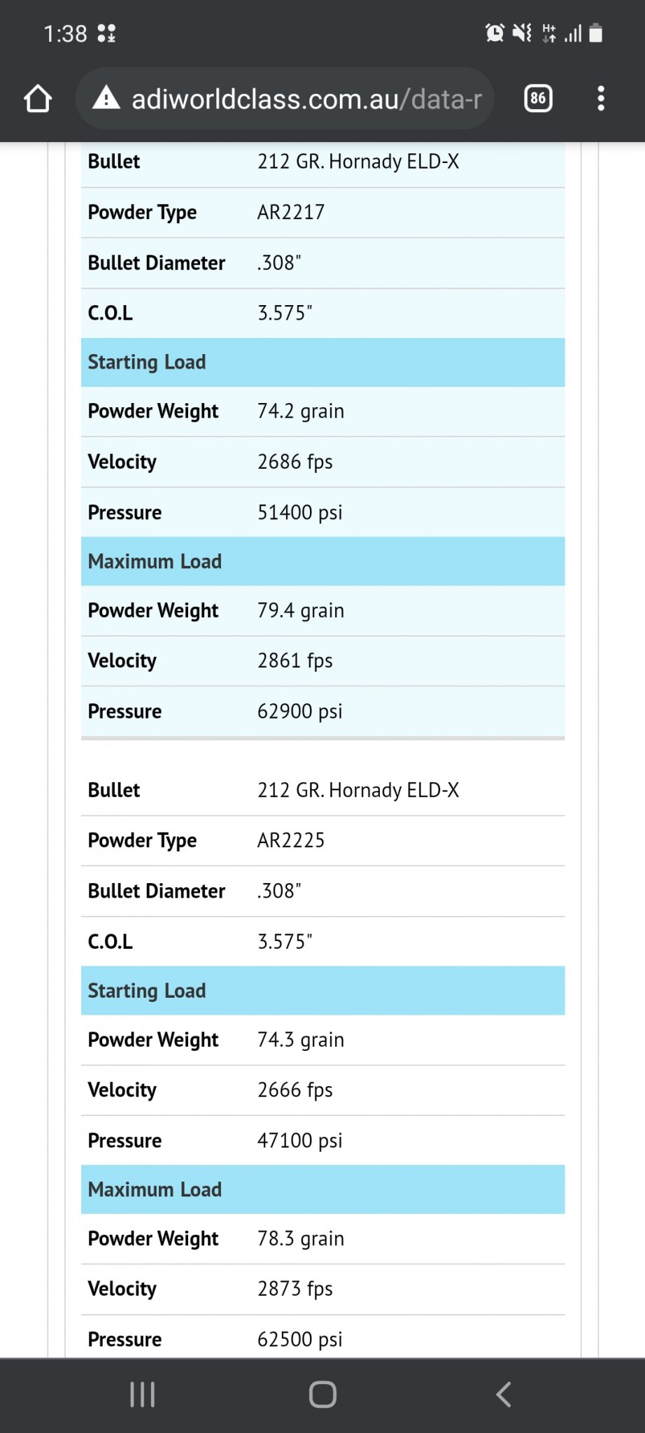

    not sure how old that data is. but i can't find it ANY where on their website?
    i currently only have load data using h1k for a 200 grain projectile
    200grain eldX + 74 grains of h1k was right around 2840fps
    i purchased some IMR 7977 to load. but have not yet
    200grain eldX + 74 grains of h1k was right around 3k FPS

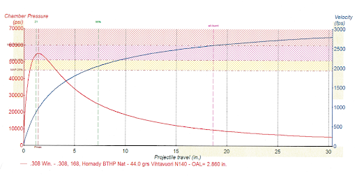

    300PRC H1000 and Retumbo, obviously velocity is for 24 inch test barrel. I don't understand why people say use faster powders for shorter barrel, for the same peak pressure the slow powder will yield higher velocity from what, like 2 inches onward?
    Powder choice depends on chambering and bullet weight, not what happens after everything is already up to speed feet out ahead of the chamber.
    I like to use faster powder in shorter barrels because it doesn't burn as much powder in the suppressor.
    Gas port and muzzle exit pressure can be significantly higher with slower burn rates if those are a concern (usually not in a bolt gun unless muzzle exit pressure causes poor accuracy). Velocity ES can suffer in shorter barrels, but it's case-by-case.
