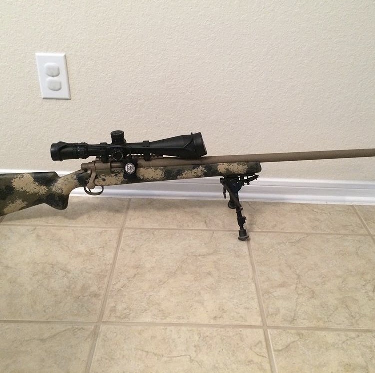

    I love the 243 as it was the first centerfire I grew up shooting. Not looking for cheap just well rounded. I handload so don’t need factory ammo. Here’s my last 243 I dumbly sold

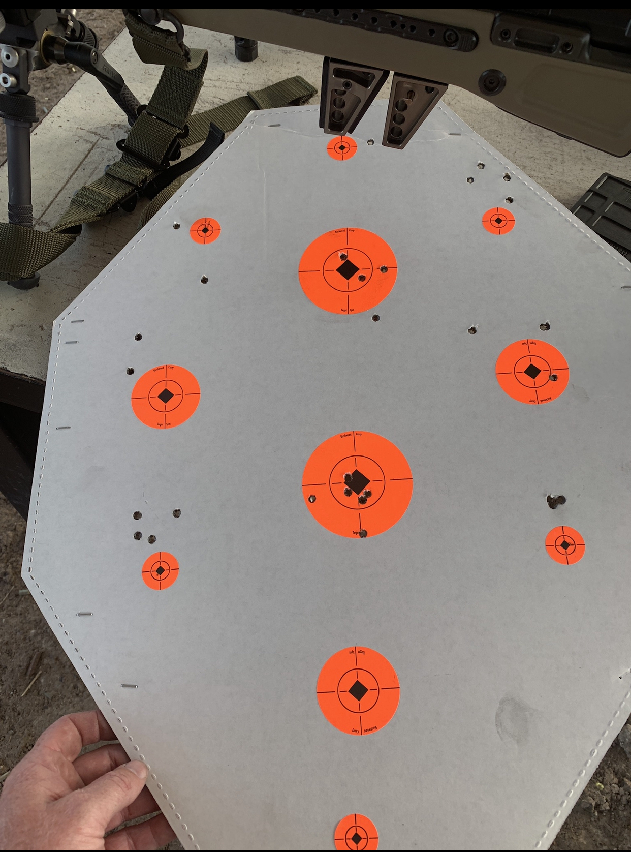

    I’ve had some make it to 13-1500 and others go at 900 rnds.
    I like 6cm a lot, but it’s a crapshoot on barrel life.
    Here’s how one shot after 900 rnds. Firecracking over halfway up the barrel or more. Only factory hornady 108 through the barrel.
    This is at 100yds.
