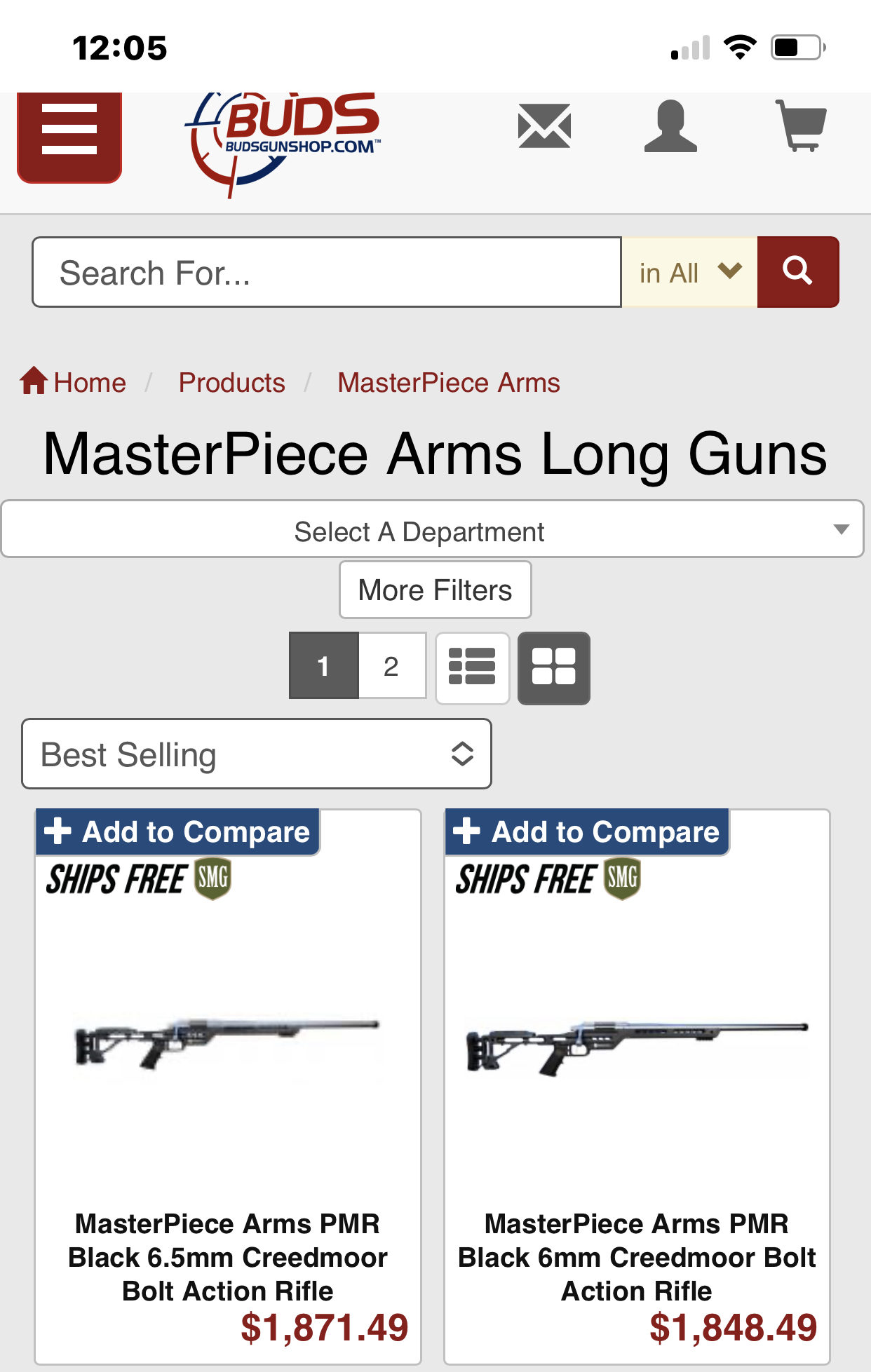

I vote MPA as well. The MPA PMR rifle for under $1900 from Buds is a great deal . As already stated MPA is a great company and their rifles shoot . They actually come with a 3/8 moa guarantee.

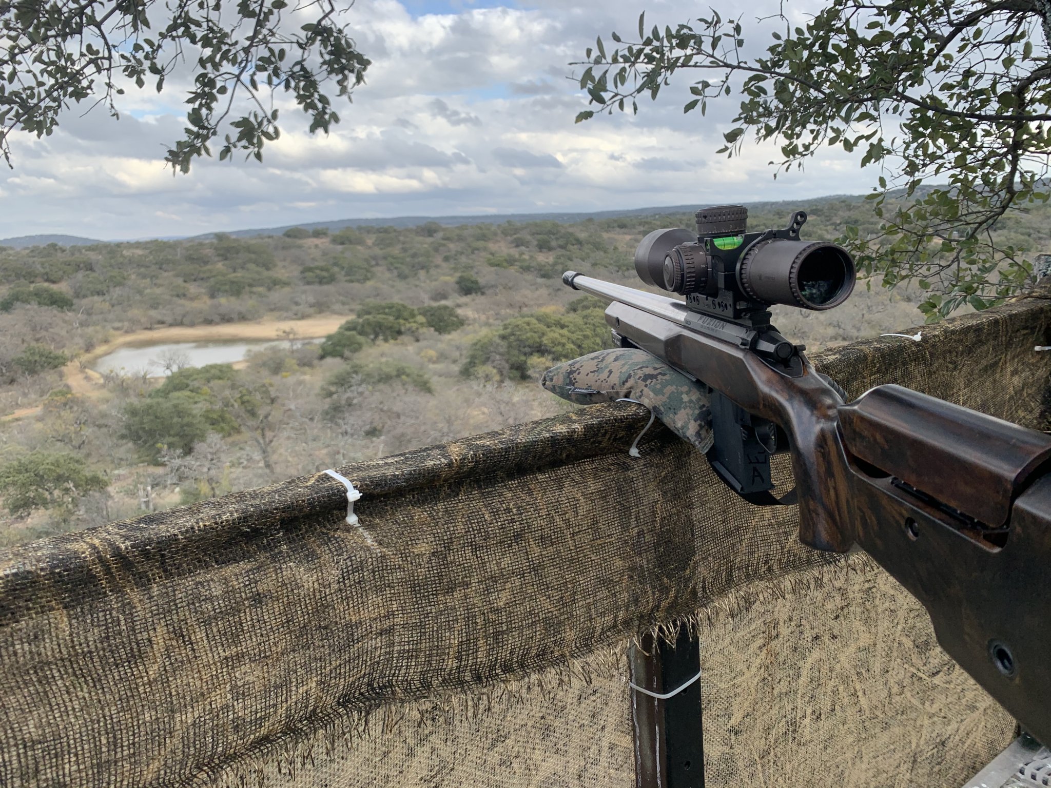

Just build a legitimate PRS rifle and hunt with it. Unless you packing your rifle miles and hunting big game like elk, you can get away with a 20# 6br, which is what I do. I’ve shot plenty of whitetail and pigs in Texas with 109 hybrids and it kills them as good as any “hunting” ammo or caliber I’ve ever used. Added benefit you actually get to hunt with a rifle you practice with so making a 300 yard ethical kill becomes a chip shot.
