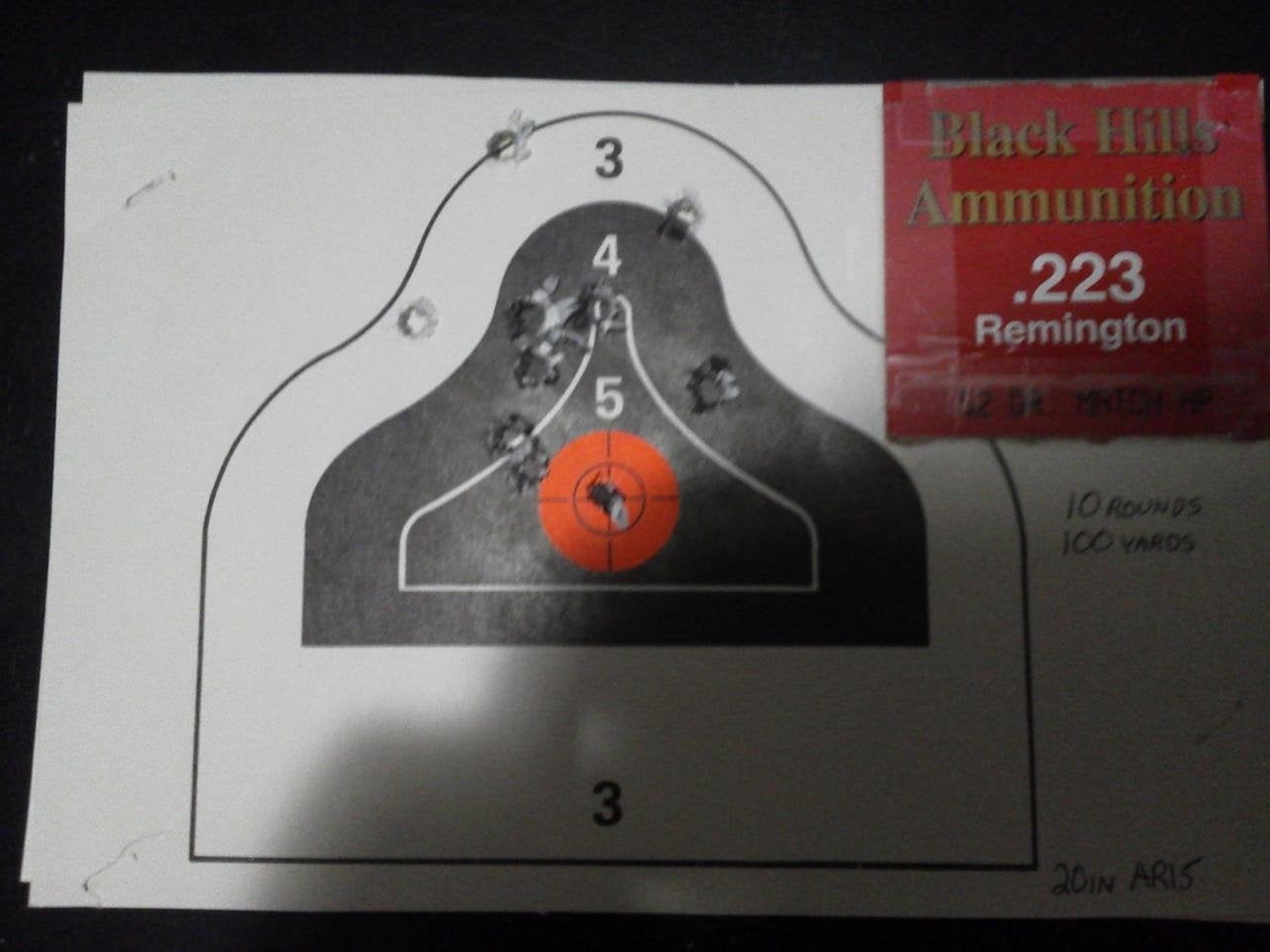

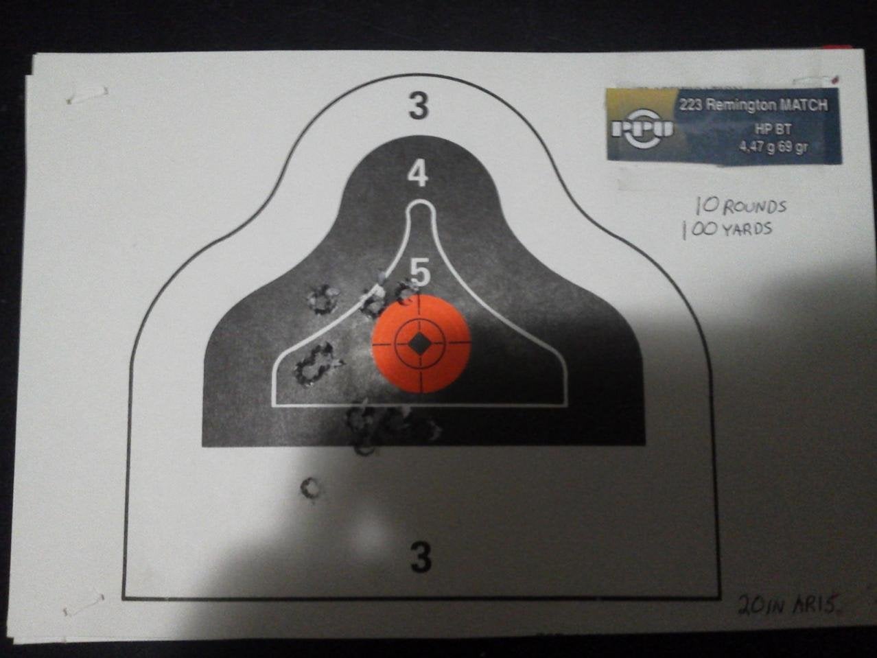

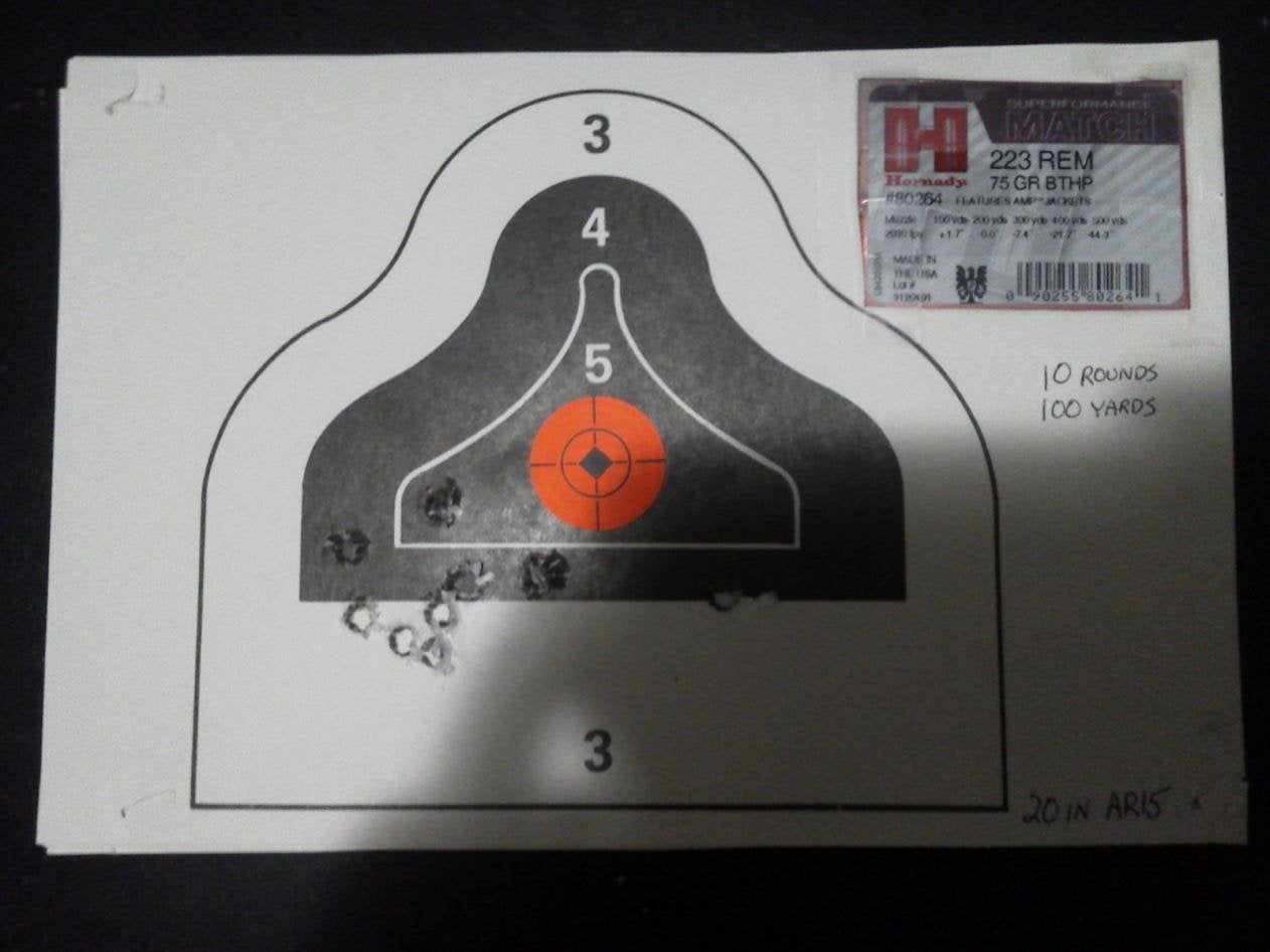

I got to the range today. Shot a few different types of ammo. 10 rounds each. PPU M855 62Gr, Hornady Match 75Gr BTHP, PPU Match 69Gr BTHP, Black Hills Ammunition Match 52 Gr HP, and American Eagle 55Gr FMJ. Overall, it seemed to be a tie between the PPU Match and Hornady Match. I am not the best shooter, so I take that into account. I took some pictures of my targets, and my shooting setup.

Callmecolt, I can't seem to access the photos of the groups. Clicking on the links re-routes to another forum sign in page. If it's a tie between the 69gr and 75gr bullet try shooting further out. If convention holds true the 75gr should take you out further.
