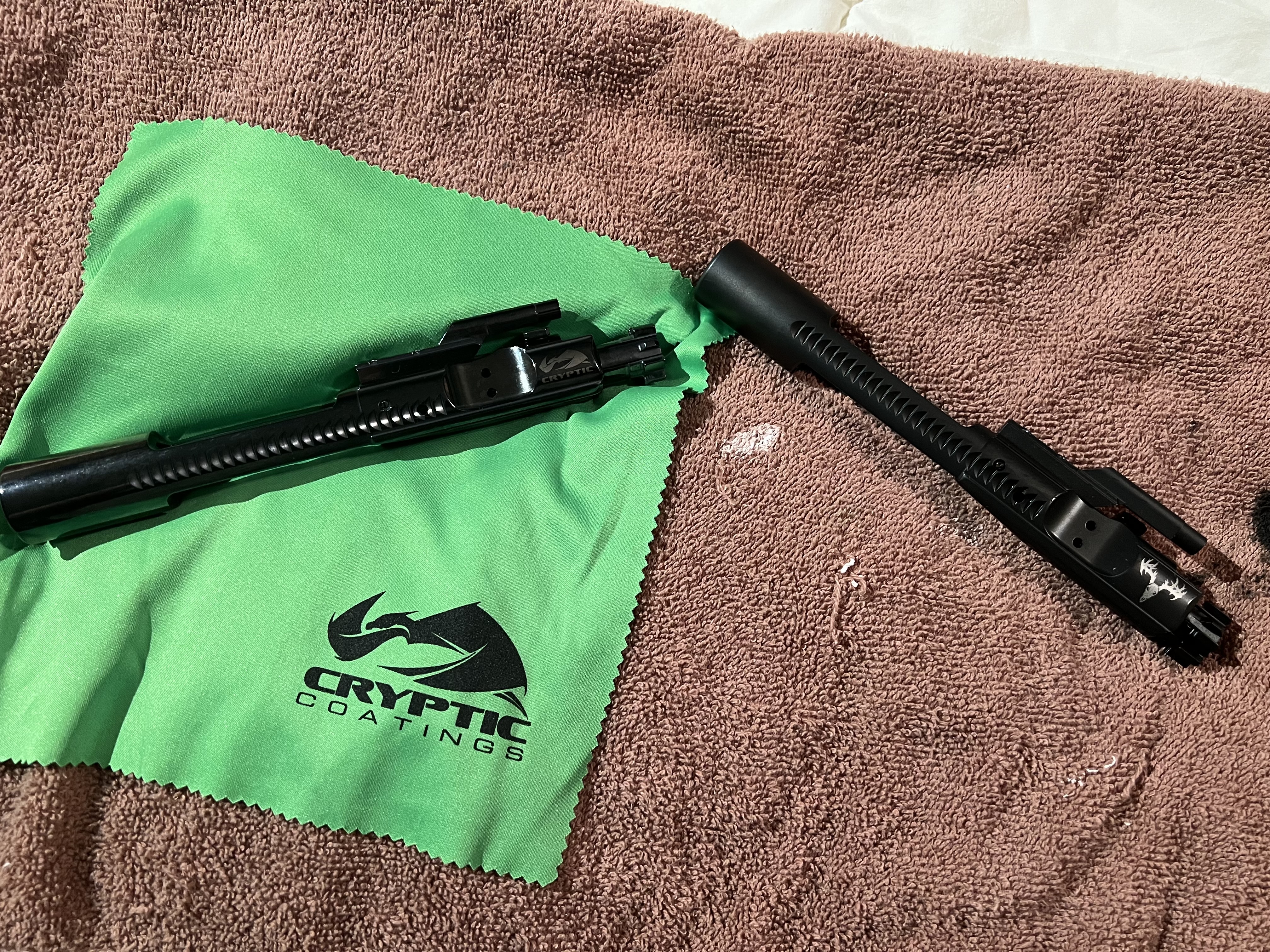

Have another one I’m doing a long-term test on right now, with one of HMB’s BCG’s with the modified bolt and cam where the hole isn’t drilled all the way through. Supposedly a lot more reliable design, but I only have 1K or so rounds through it so far, and still trust the Geissele set up the most right now.

I also have one complete Geissele BCG mated to an URG(ish) upper on my go-to AR, maybe some day will own a Knight’s Armament set up as well with a similar (even better?) bolt design.
Have another one being tested with HMB’s BCG’s with the modified bolt and cam where the hole isn’t drilled all the way through. Supposedly a lot more reliable design, but I only have 1K or so rounds through it so far, and still trust the Geissele set up the most right now.
