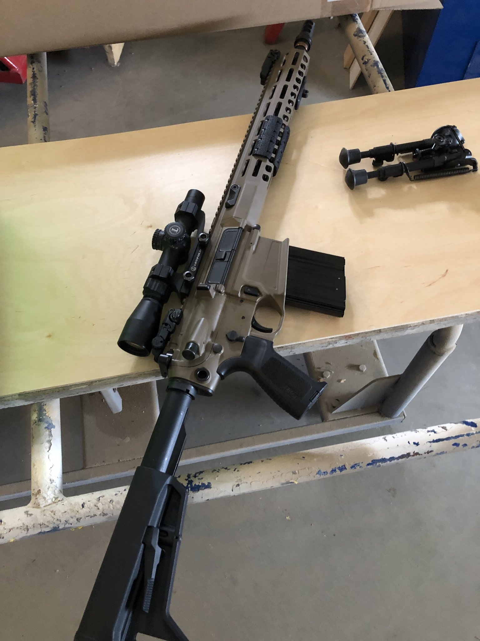

This is the rifle I plan on using for Javelina here in arizona it's a very basic 16:
