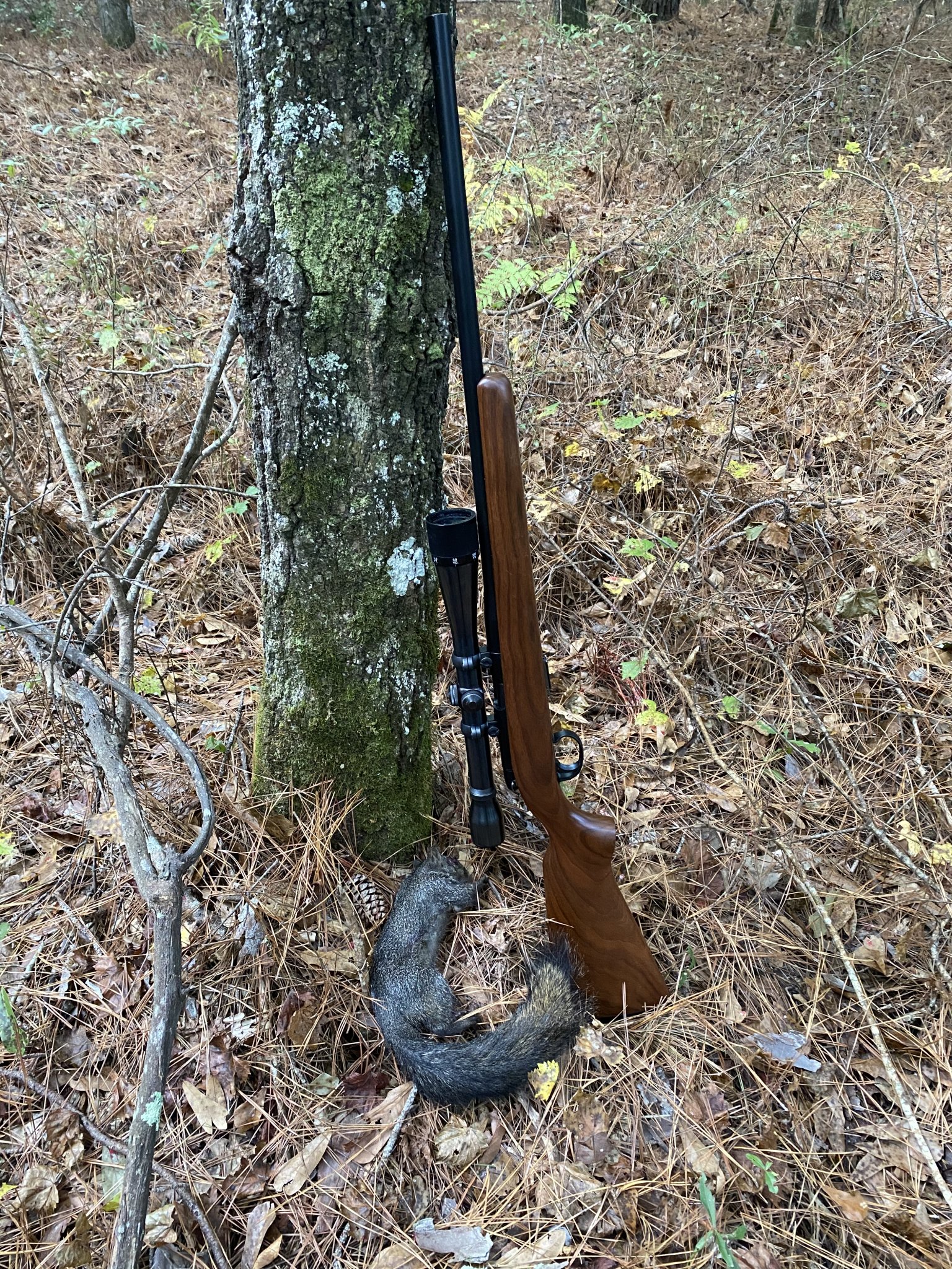

Mr. Voelker built my sporter Rem 581 squirrel rifle and put a Broughton 1:17 twist on it. No problem staying in the 0.2’s at 50yds if you can hold it. 22” barrel
Voelker Rem 581 with Broughton barrel and Canjar trigger set at 1.25lbs. It loves Eley HP’s.
