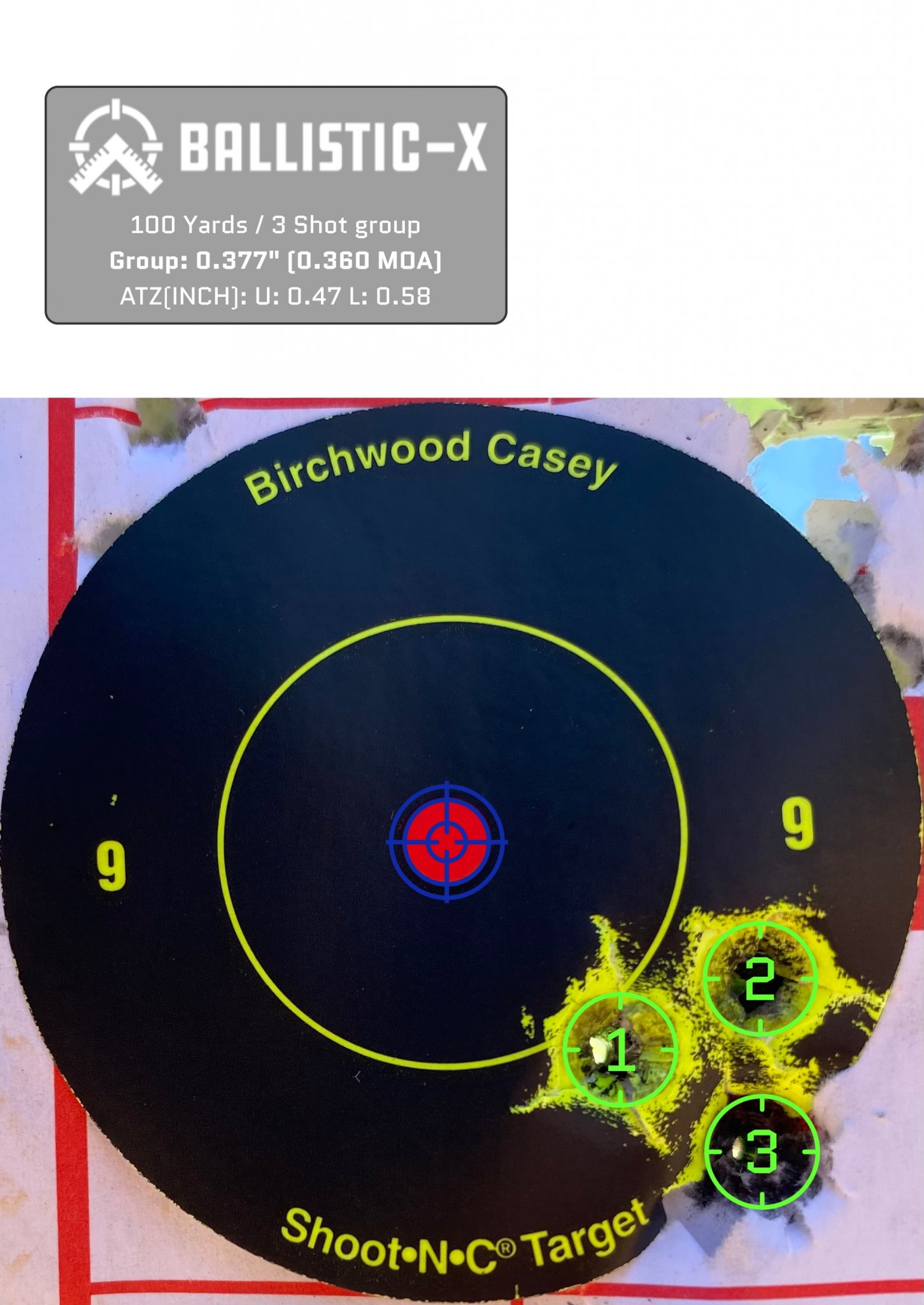

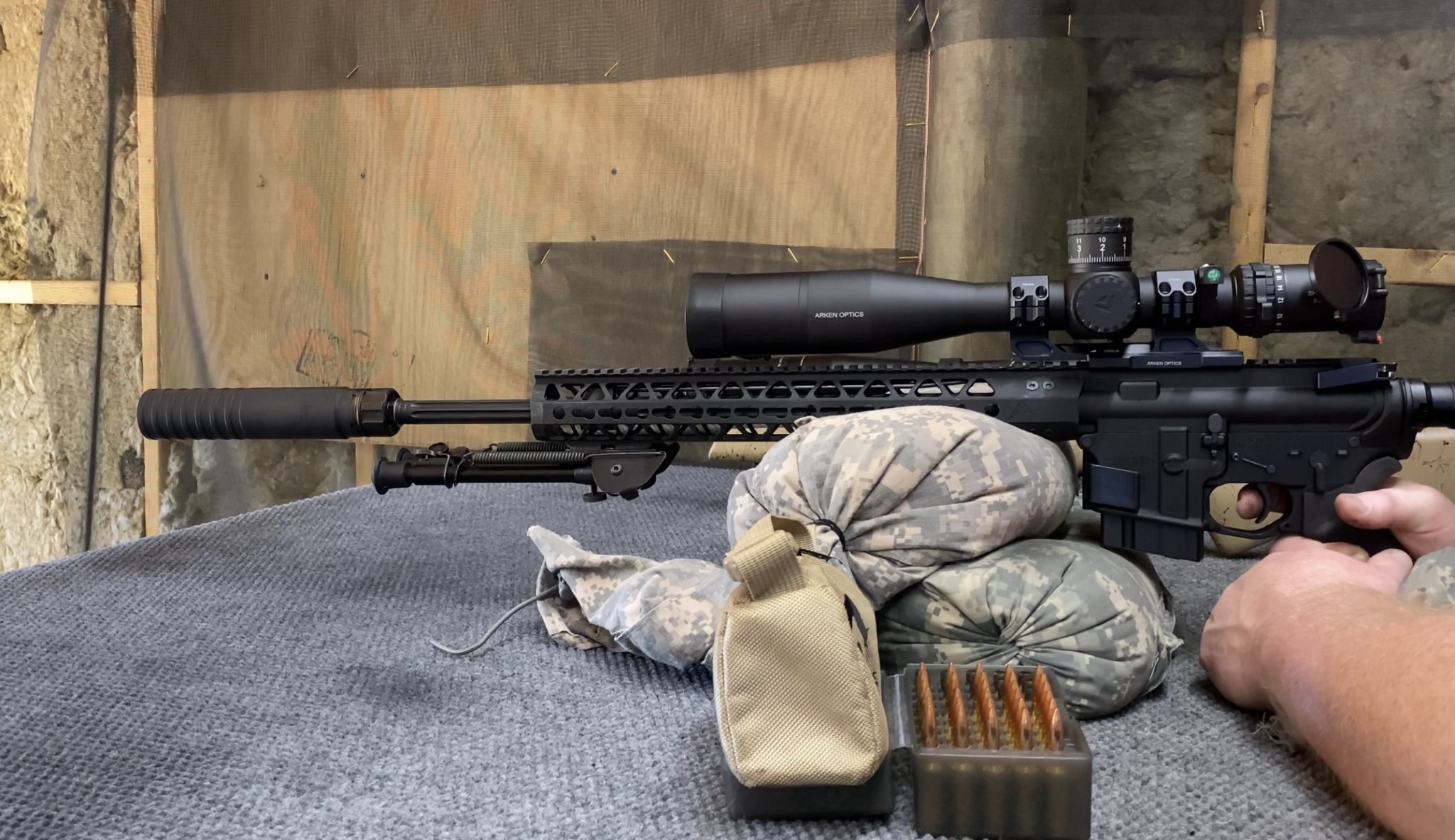

Lapua is best, obviously, but I use cheap Hornady brass from factory ammo I shot back when it was cheap ($16-20 a box). Works just fine for me. My custom built 20” 6.5G is putting down sub-1/2 MOA groups at 100, so I’m not complaining. 😏
