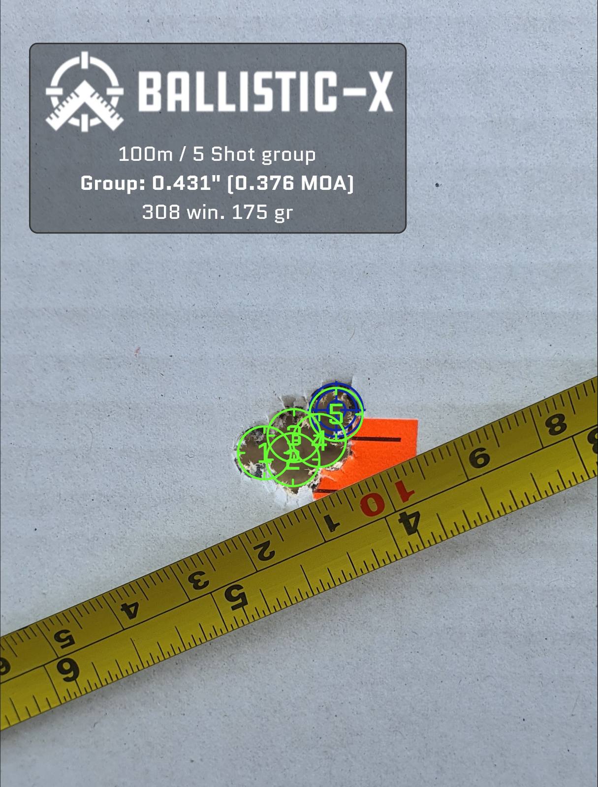

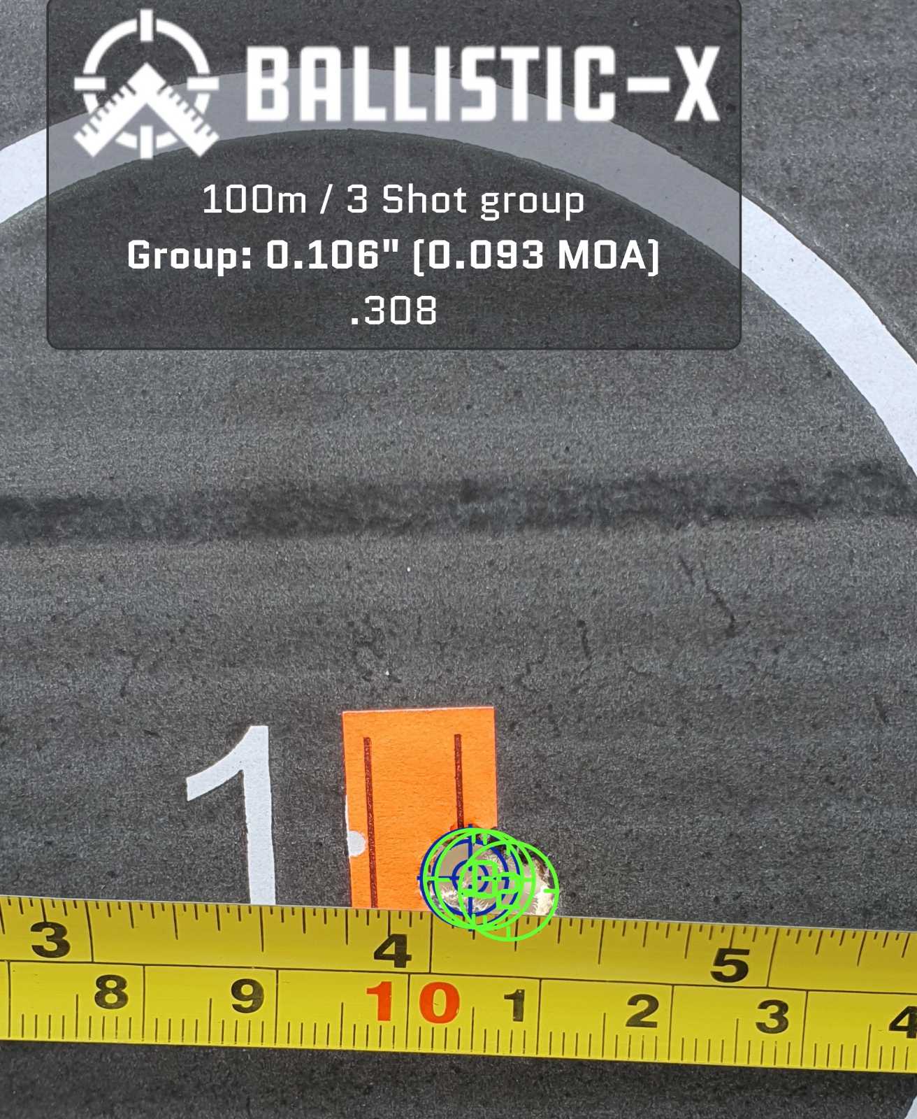

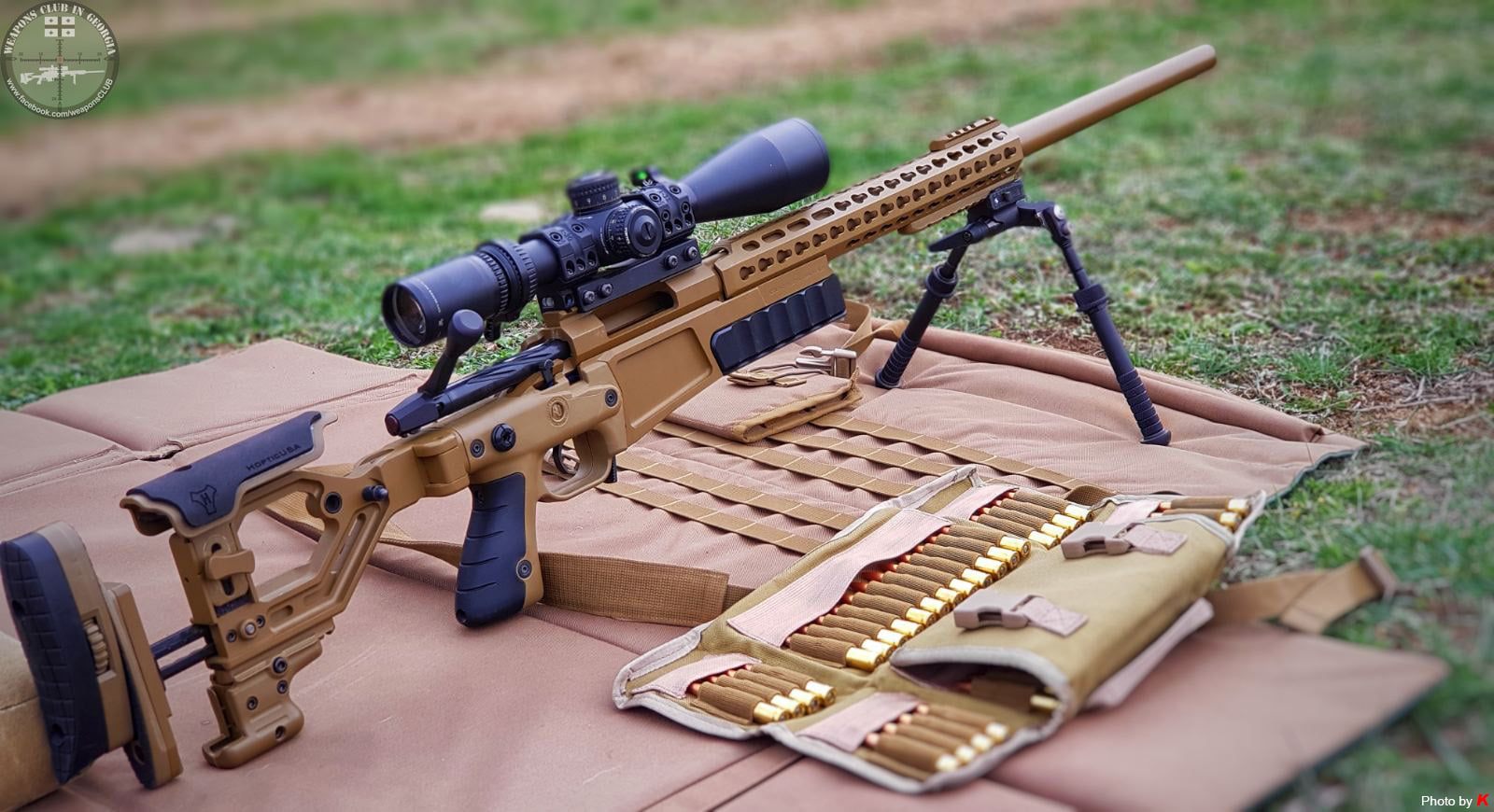

308 Win. Federal 175 Sierra match kings
100 m
Stiller's Actions SPECTRE
.308 Win
Vortex Optics Razor HD AMG 6-24x50
EBR-7B FFP MRAD Reticle | 30mm Tube
Bartlein Barrels, Inc HV Modified, 28 inch, 5R , Twist 1-10
Timney Triggers 2-STAGE CALVIN ELITE
Accuracy International Ltd AICS AX 2014 Rem 700 SA Stock
Spuhr AB MOUNT 30MM 0 MOA
20MOA Rail
Vortex Optics RIFLESCOPE LO PRO BUBBLEVEL 30MM
Vortex Optics Switchview Throw Lever
Vortex Optics Flip Cap Optic Cover
B&T Industries BT65-LW17 Gen. 2 CAL Atlas Bipod
Really Right Stuff SOAR SOAR AIAX/AX AICS ACCURACY INTERNATIONAL AUXILIARY PLATE
HOPTIC USA SADDLE BLANKET

42.0 of IMR 4064. which I've gotten a couple of pounds lately. 168-178 bullet. 2625fps out of a 20" Krieger barrel. (175 MKs)
I got to 44.1 of imr4064 and was seeing pressure signs and had to back off. Not sure how fast that was running them.
