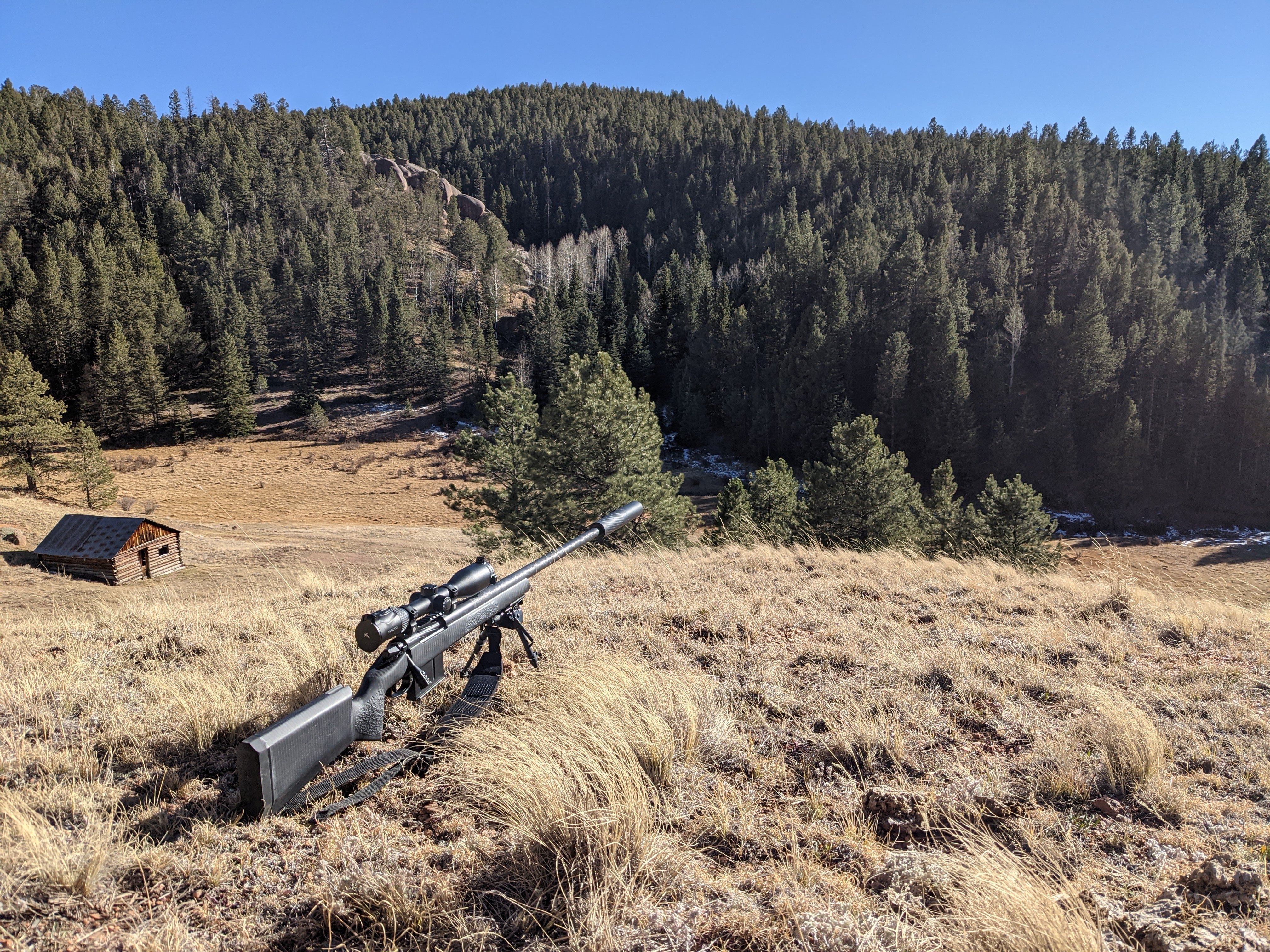

For sure there are a lot of uncontrollable, unshootable lightweight super magnums out there that are just plain stupid (e.g. every factory Weatherby Mark V with those terrible stocks). But there are also a lot of really well thought out platforms that have good stock designs, sufficient weight, and an appropriate muzzle device that are perfectly controllable, not punishing, and capable of extreme precision.
I firmly believe that just about anyone can master a properly set up 30 cal magnum in the 12lb range with a good stock design that fits properly and has a good brake or a can. 30-378 is definitely on the extreme end, but 300 WM/300 PRC/30N no problem.
Ultra lightweight and magnum are just a stupid combination. That doesn't mean that magnums can't be controllable in a package that is still reasonably portable. If you absolutely must have an ultra lightweight platform, then yeah stay far away from the magnums.
