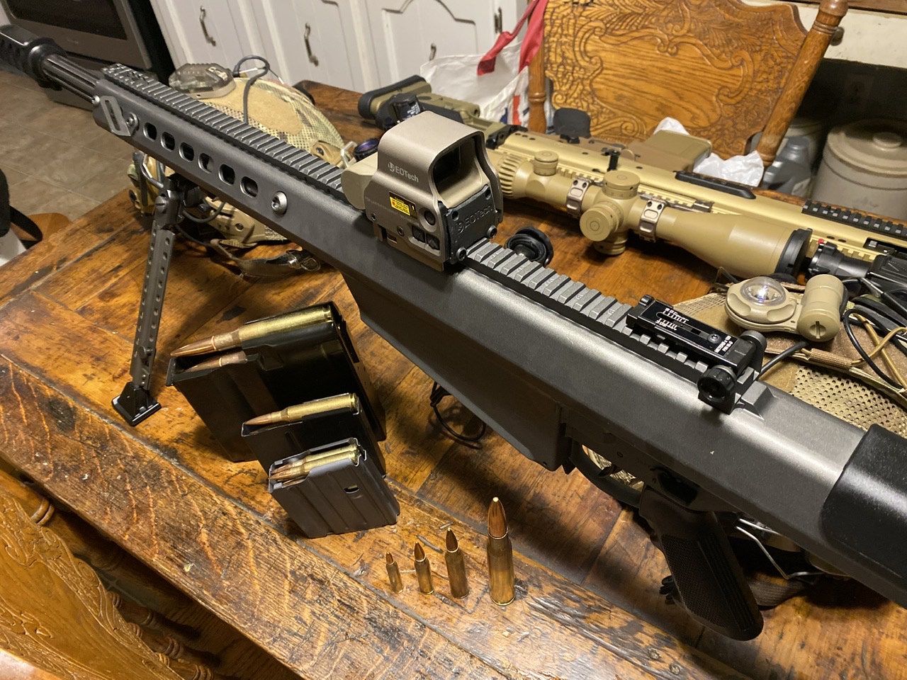

    M107A1.
    It’s the multipurpose, do-it-all rifle. 2Km shooting, CQB/Home Defense, Coyote hunting, repelling MRAPs. It gets the job done.
    Light. Discreet. Concealable.

    I can totally see why you'd run the EOTECH on the .50 and the big scope on the SCAR. :LOL:
    That’s in Home Defense / CQB configuration.
    Here it is in nighttime yote hunting mode:
    See? The most versatile weapon platform available.
    The Barrett M107A1. :giggle:

    Damn, I hope the word doesn't get around to the Yotes out here to start wearing body armor like yours do. Or is the Barrett for when they barricade themselves behind a Hesco wall?
    Bama yotes shoot back. They have a whole mechanized division in my AO.
