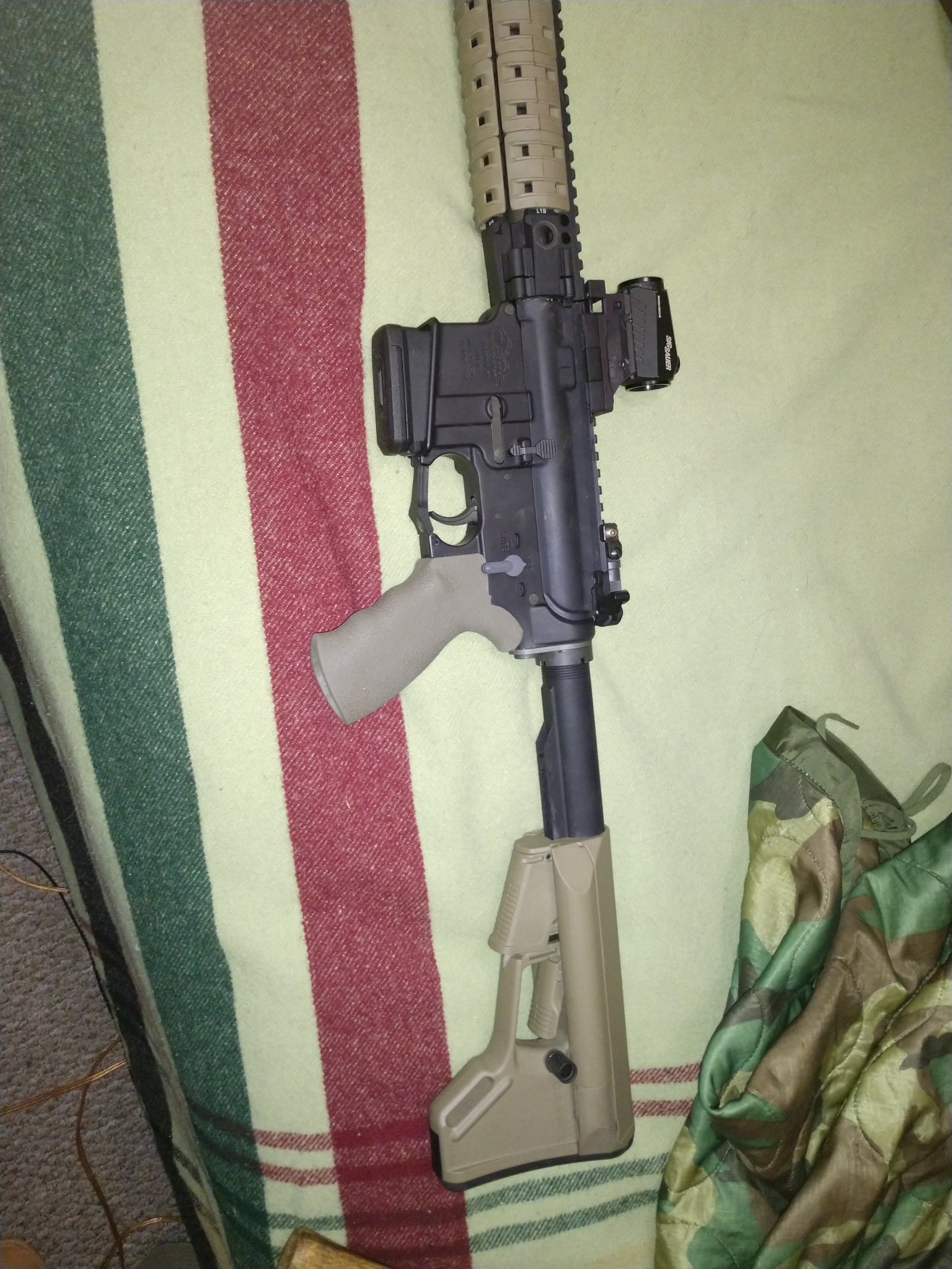

I have one of these on my SPR build.
comfy and solid yet still adjustable

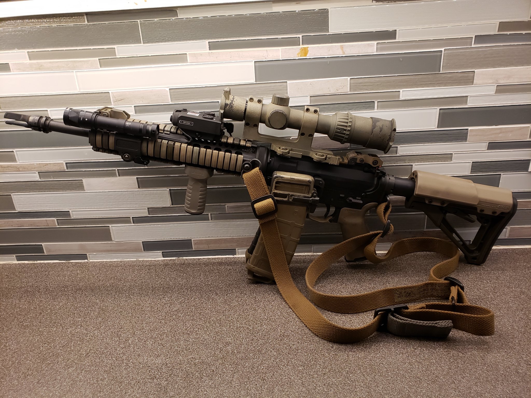

Pretty solid looking carbine. I have almost as much, use it all routinely. Very sad the other month when I had to get issued a crappy slick gun for an EX. Want my laser!
You don't get too much splash from it that far back?
No, i only use the laser. I use the Surefire Vampire if i want an illustrator. That way i get much better balance. I do the same set up for all of my guns.
