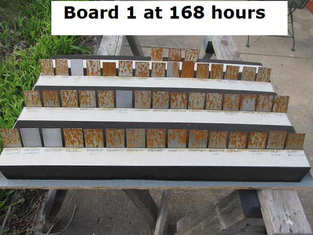

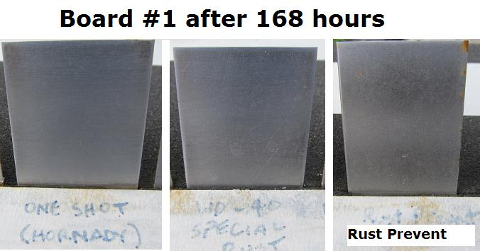

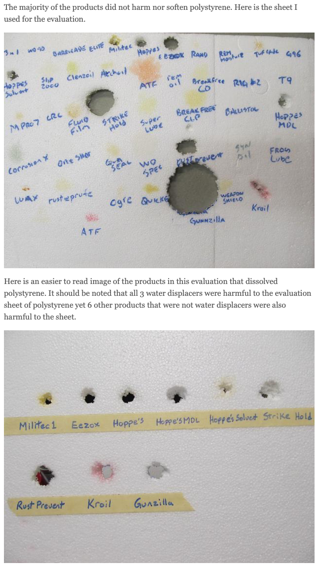

    At least Barricade isn’t in last place. I might have to try One-Shot or WD-40 Specialist. Cannot STAND the smell of Froglube.
    The funny thing about any chemical or foodstuff is the manufacturer can change the formulation at any time, and unless you check the back of the can (or SDS) you’d never know. Unless they brag about it on the front, of course.
    Also something to keep in mind when using a cleaner... how will it react to plastics. I remember when Gunzilla was getting a lot of attention for being a great cleaner. It will absolutely destroy plastics. While you may not get any of these on your stock/grip while cleaning, some like Kroil do creep and may get on something while the gun is stored.
    Froglube was getting a lot of attention as well. But when it was found to gum up some actions, if not properly removed, it seems to have fallen out of favor.

    I guess one has to balance a bunch of different properties when picking something; smell, tendency to build up, stickiness, toxicity, safe on plastics/wood/diff types of metals, rust prevention, friendly to clothes, no off-gassing…the list goes on and on…
    As he says in his article, if the product you use now works, stick with it. I’ll probably do just that. Barricade lasted 24 with rainwater and 48hrs with salt water (which is weird, but many products did that too). That’s long enough for me.
    Who paid for that test?
    IIRC, I believe he did himself.
