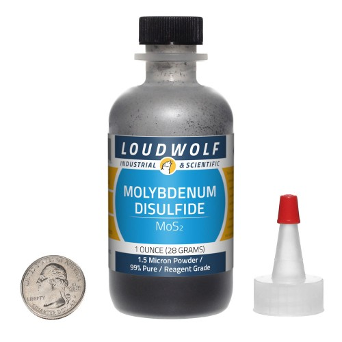

Don't know that you will ever find the "best".
Applied with a q-tip before resizing neck with a gage pin and again before bullet seating.
