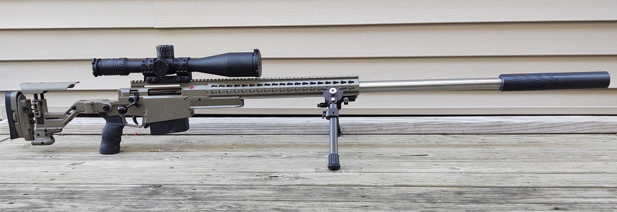

I just recently (finally) got all my parts for my 37XC build. Each component was selected based on experience gained over the years with my 30 cals (300 WM and a couple 300 PRCs). If I hadn't had that background, everything would have been a guess.
As an aside, I'm taking a trip to Boise with both my 300 PRC and all the 37XC parts in either 2 or 3 weeks. My smith is going to put together the 37XC while I'm there (and I get to watch him do it all), and he's also going to slightly expand out my 300 PRC chamber, which was cut with one of the original small reamers.
Then I get t bring them both back with me ready to shoot.

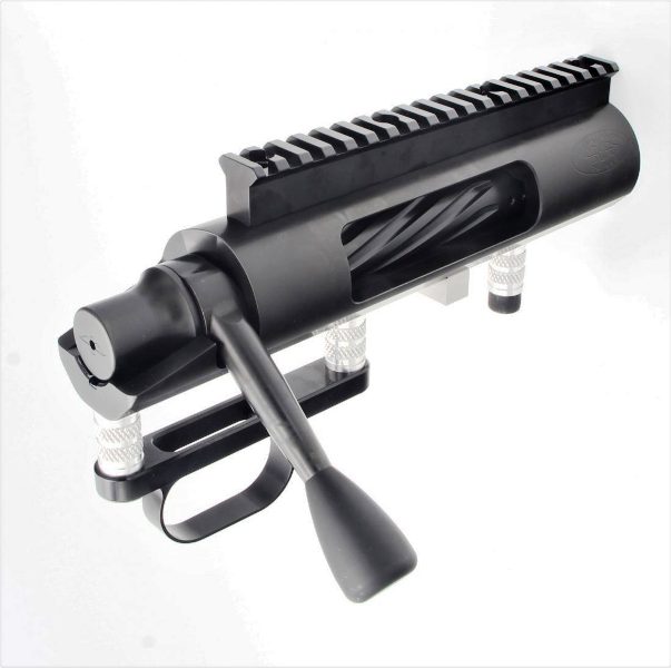

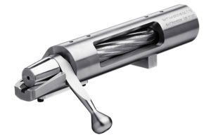

If I was to recommend an action to build off it would be one of the two:
TacDriver - with a lapua bolt and cheytac bolt
10x - with a lapua bolt and cheytac bolt
With that you can go from lapua bolt face cartridges (300NM, 33/37XC, 338LM) and cheytac bolt face cartridges.
Both actions are good. One is more budget friendly and the other has some unique features.
But the main problem is that lapua based cartridges are generally light class cartridges (338LM, 300NM, etc.) and cheytac based cartridges are heavily class cartridges (375CT, 375SnipeTac, 416CT, etc.)
So, what weight do you want the rifle to be: light or heavy. If it’s greater than like 25-26lbs and > 338cal then it’s a heavy class rifle. Just keep that in mind.
I am a fan of practicing ELR with something like a 300NM and then stepping up to a 375CT for competition. 300NM is cheaper to practice with, harder to spot shots, etc. so it makes a good practice cartridge.
Disclaimer: I’m speaking in generalities because I don’t want to post 9000 caveats. When speaking in generalities you lose accuracy. I don’t want to type a research paper just to split hairs.

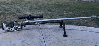

Finished a new one on a Model L this week and my newest personal one I’ll finish today on a EXS. The BAT action is the one to beat when choosing for an ELR build. They aren’t the cheapest but they are the best in my experience for this game. But like I mentioned….the end goal will determine your build. If you want to compete at the highest level, there is definitely a certain build that you will see time and again in the list from Ko2M. If you want to plink, and use it for multiple purposes, that can open up possibilities. But if for competition, build it for that specifically or you’ll spend a small fortune building another etc etc.

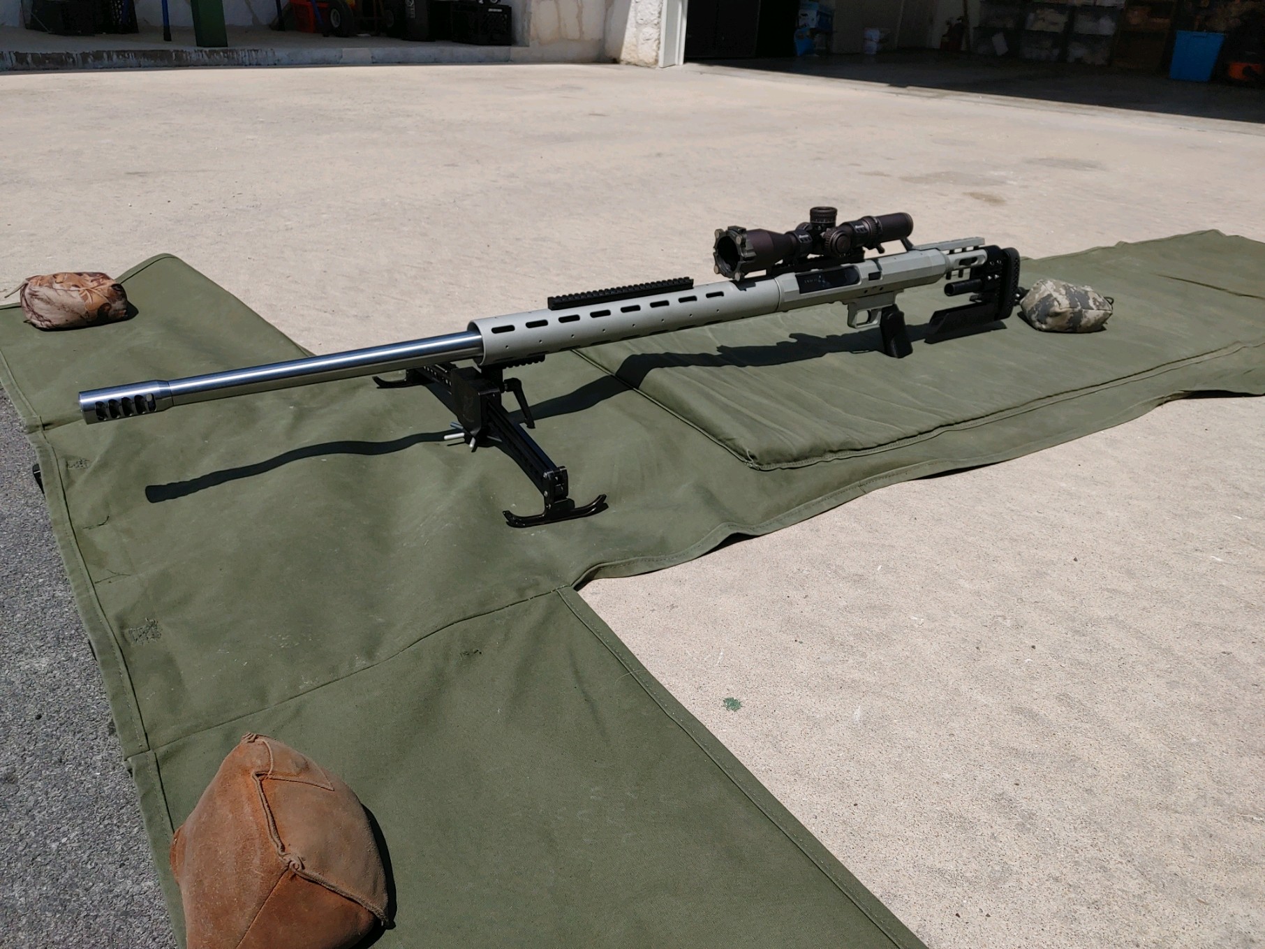

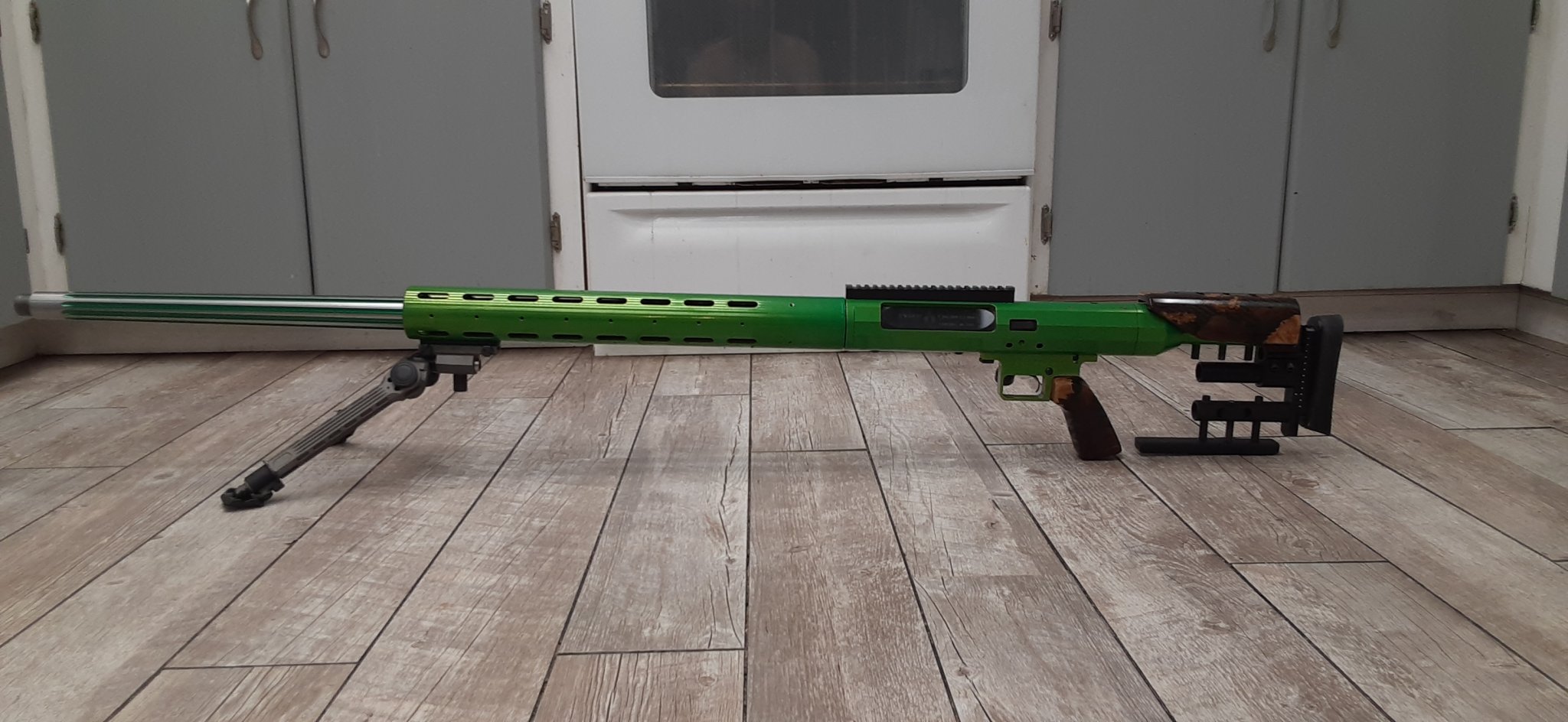

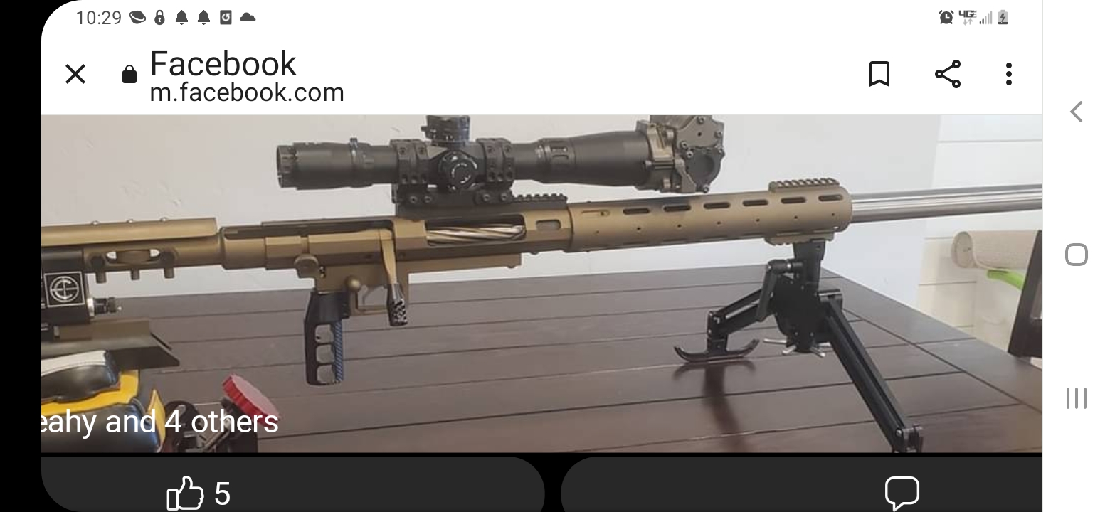

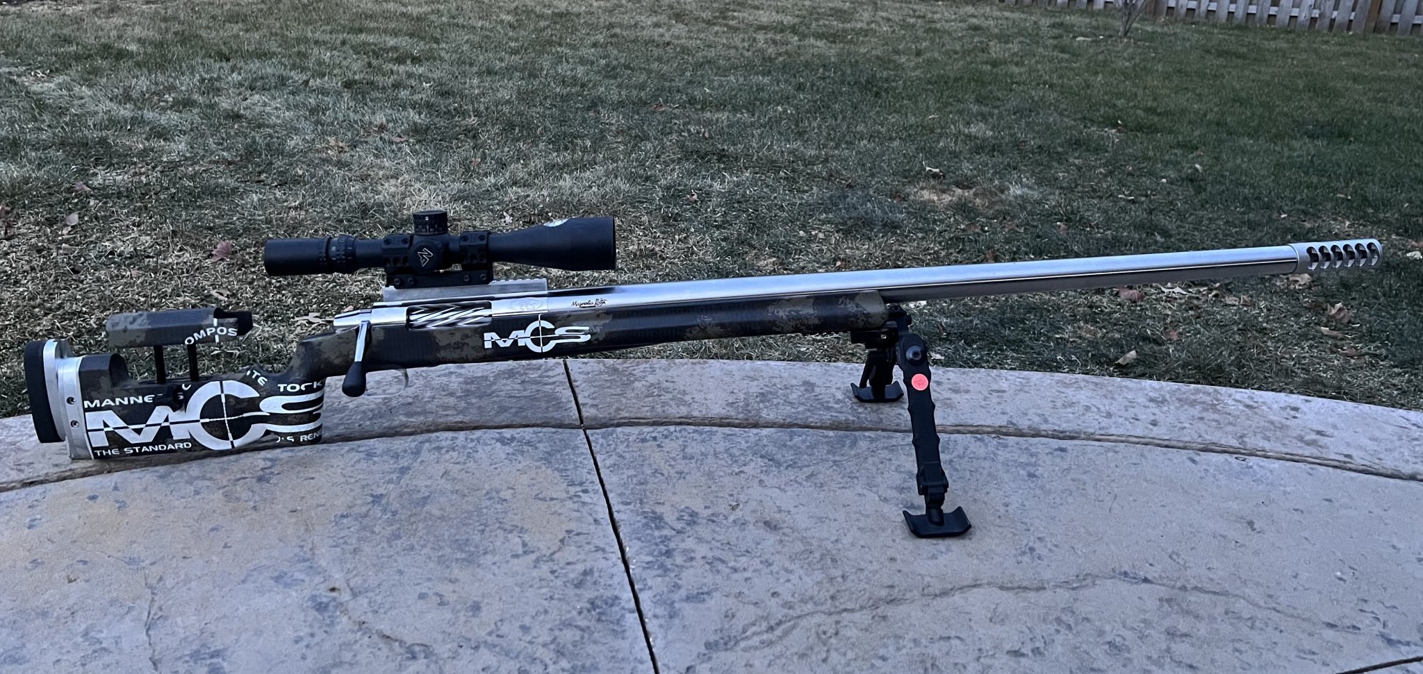

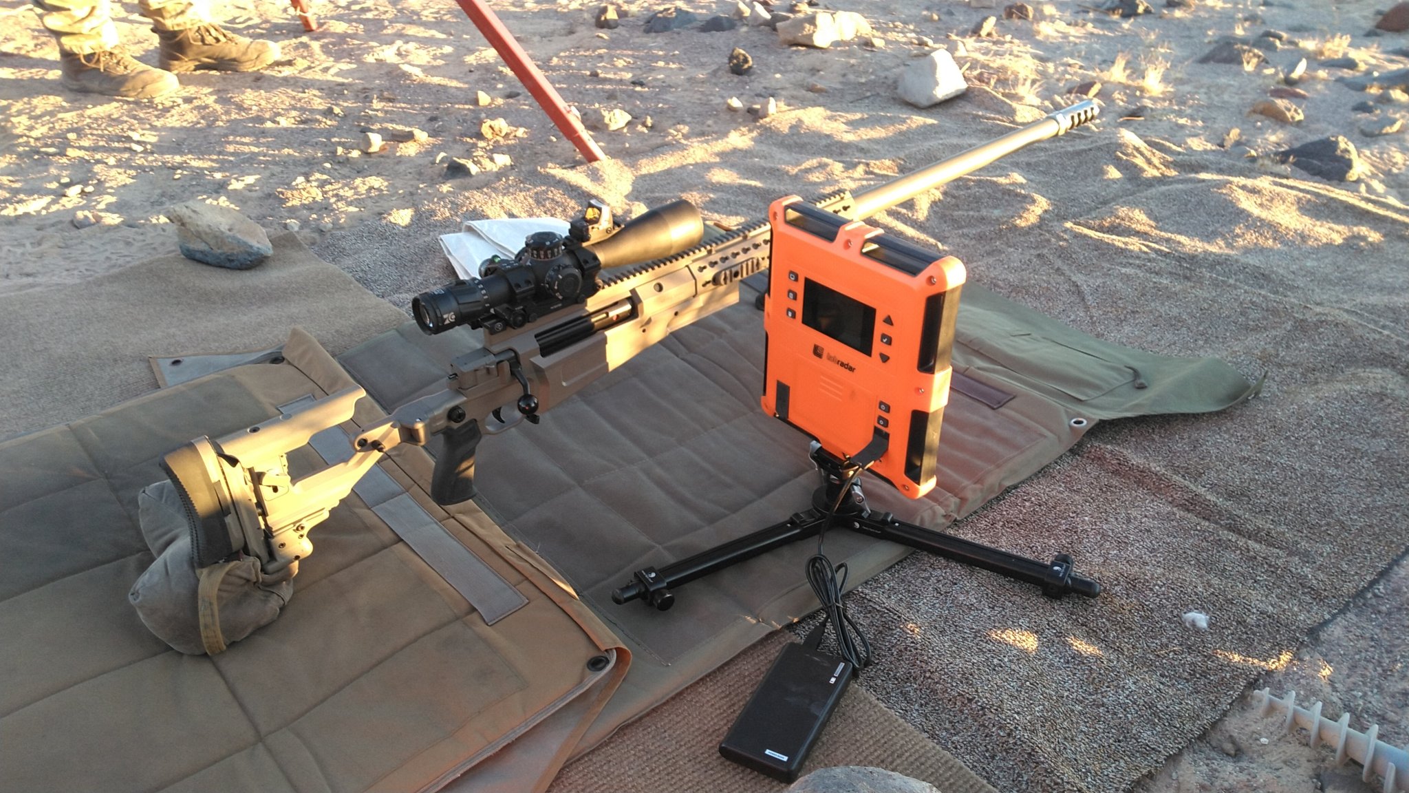

A bit over budget but I'm running the AI AX50ELR in 416B(not a fan) & 50 but can't wait for the Cheytac conversion coming soon (I hope).
Will be a multi-caliber ELR beast.
