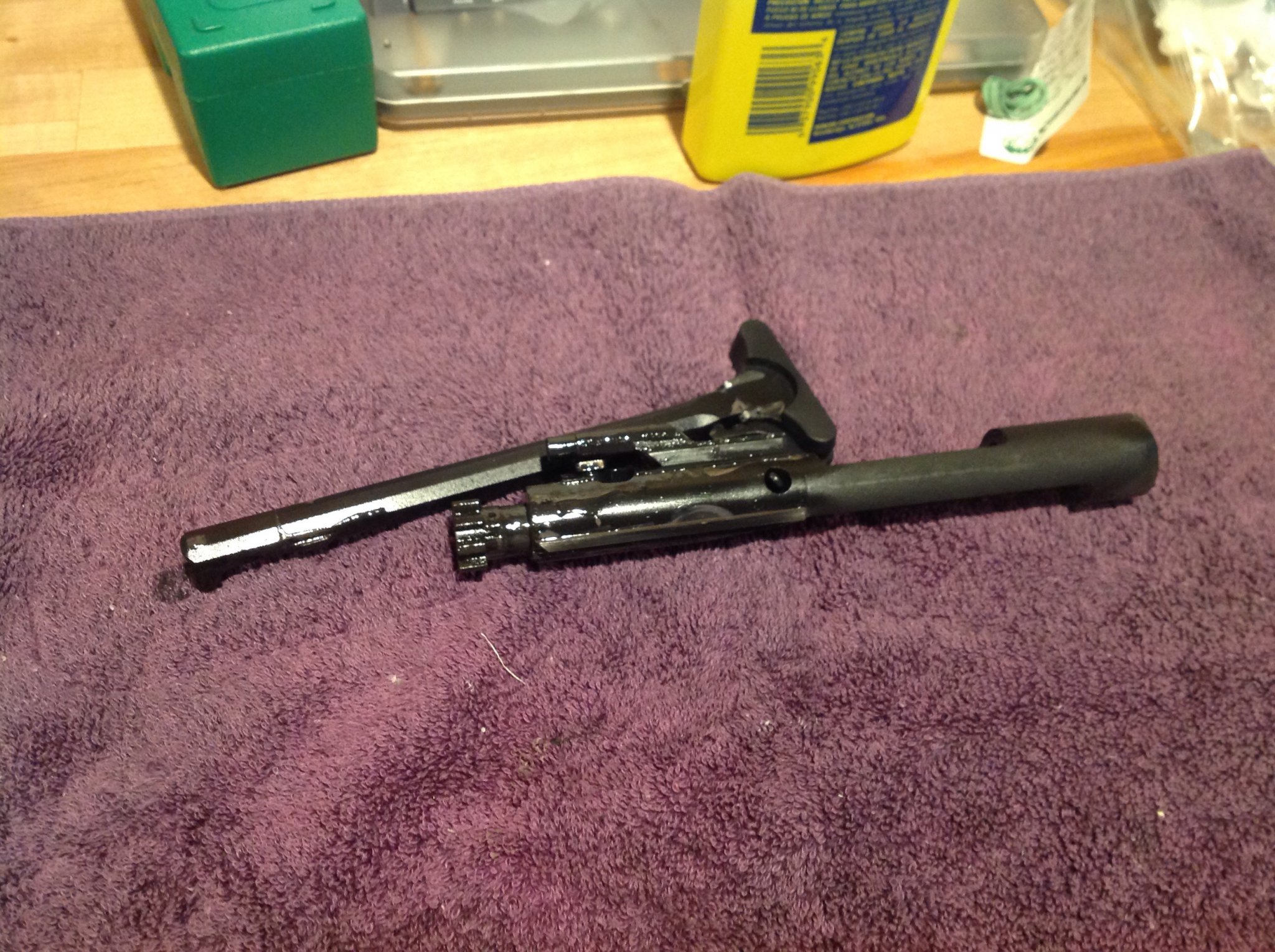

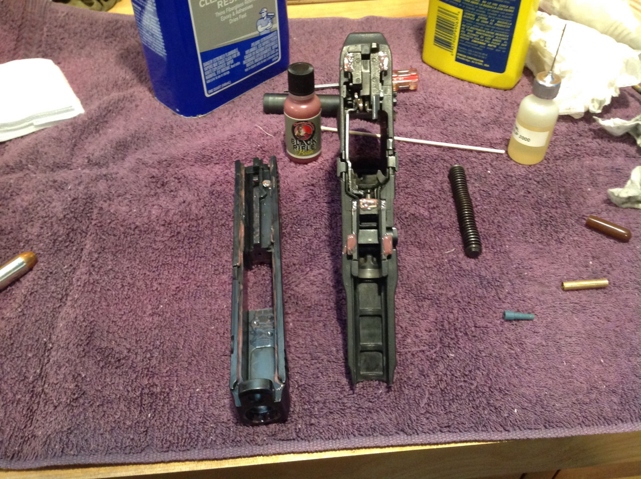

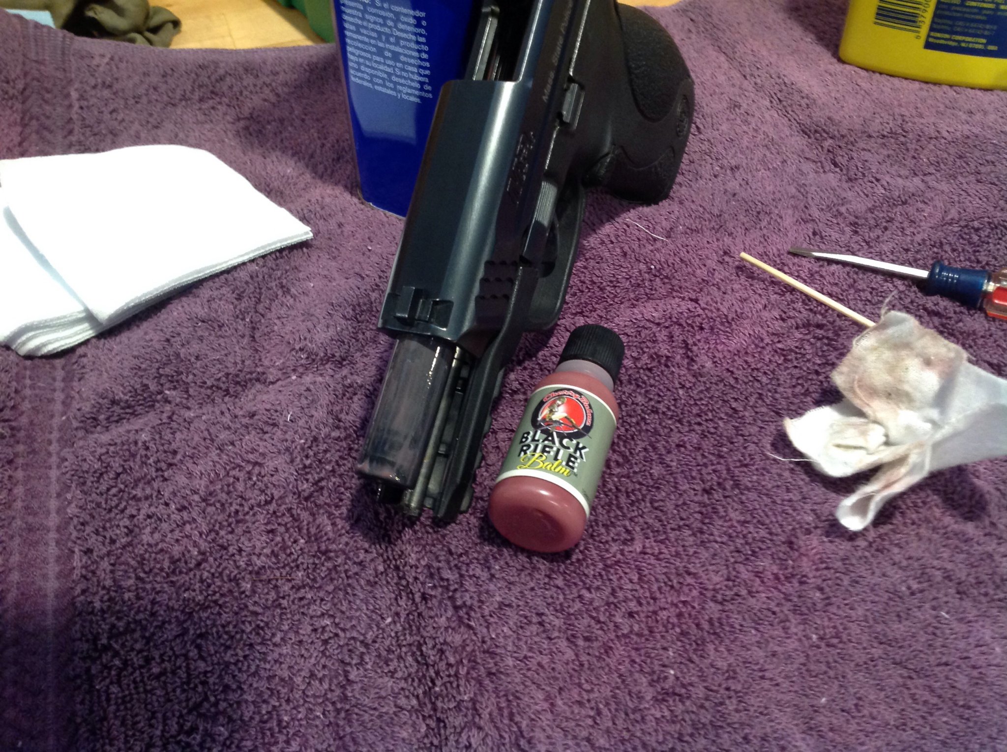

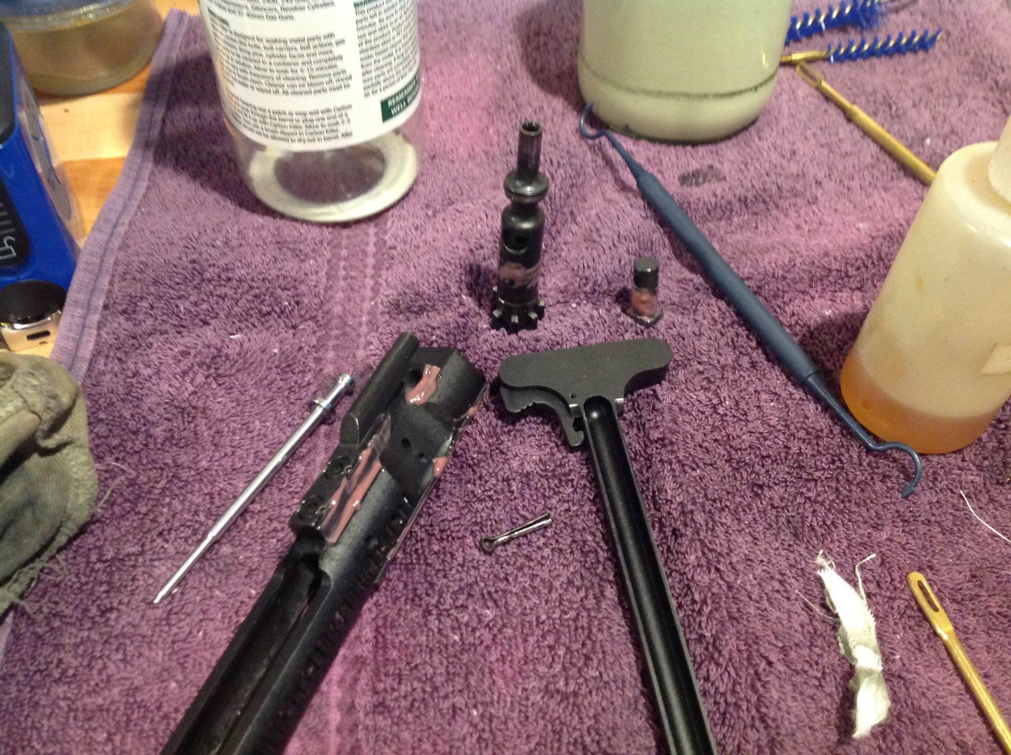

Was sent a bottle of Cherry Balmz to test out......
Lubed up the pistol, will lube the AR.....
First impression........it's lube.
Brush is kinda weak for getting the goo where I want it. I'm used to the injector on TW25B.
Heavy on the Balmz just like the video shows......

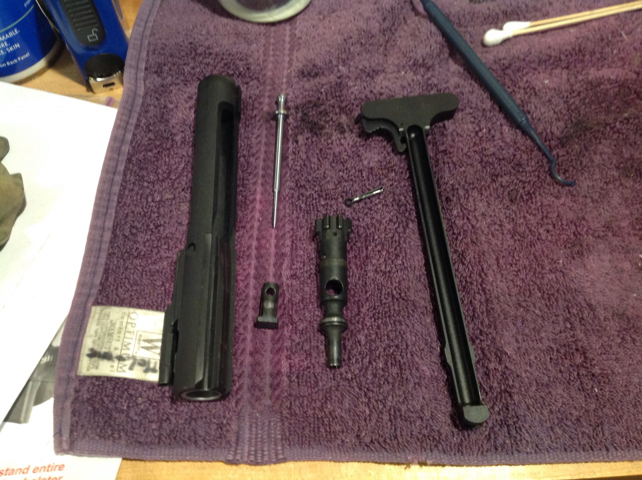

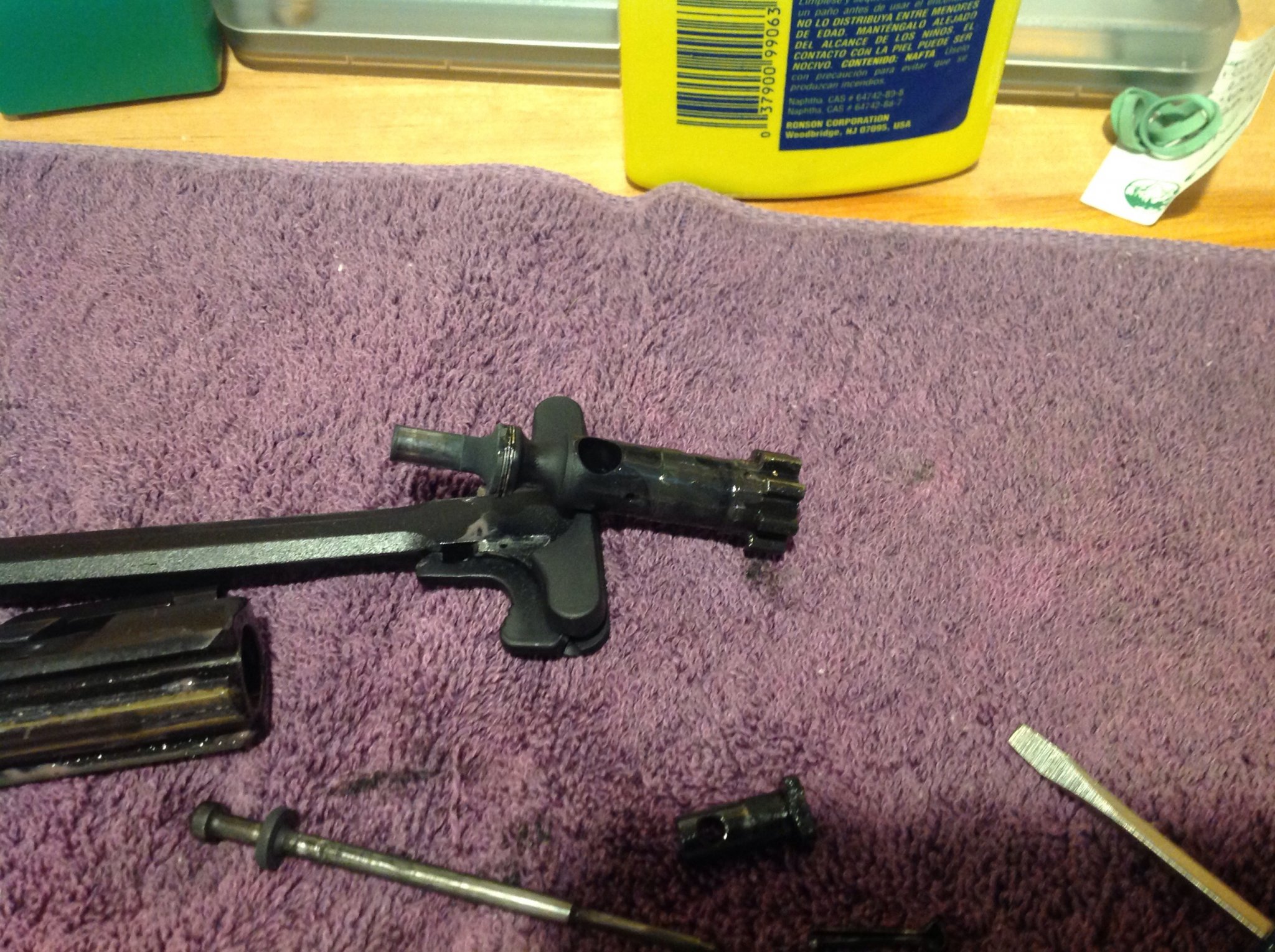

Had time to lube the carbine as per the Cherry Balmz video.
Removed my fresh TW25B :( and replaced it with Balmz.....
No issues on Friday.
Wiped and relubed bolt Friday night.
600 rounds no issues but not exactly a test either.

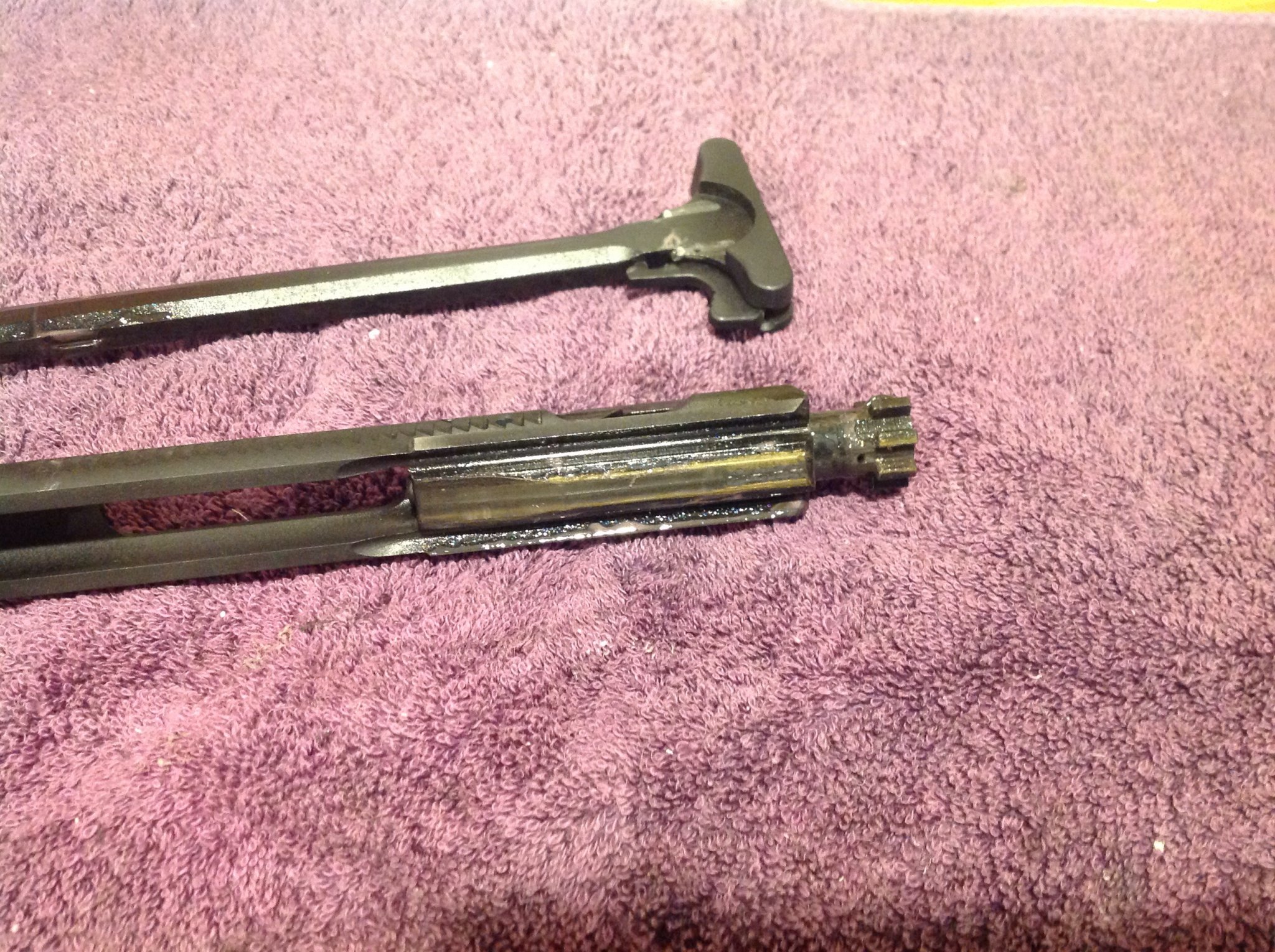

Little circle of metal I found in the goo at the front of the bolt stop, hmmmmmm......
Cherry Balmz works as a lube. One nice thing is it didn't fling oil all over my sight cap and face as is usually the SOP when I oil.

I got this stuff an thoroughly cleaned 5 auto loader handguns and 5 AR rifles.
I think I put to much on?
Everything went good so far but I think I can get by with a lot less!
The little brush is there for a reason.
It stays put for sure!
I'll run these guns till I have failures just to see how things go.
Still running it on a duty pistol and duty AR.
Stuff has stayed in place on both guns even when stored during summer heat in a vehicle and daily holster carry.
Still purple, still wet looking, no longer smells like cherries.
