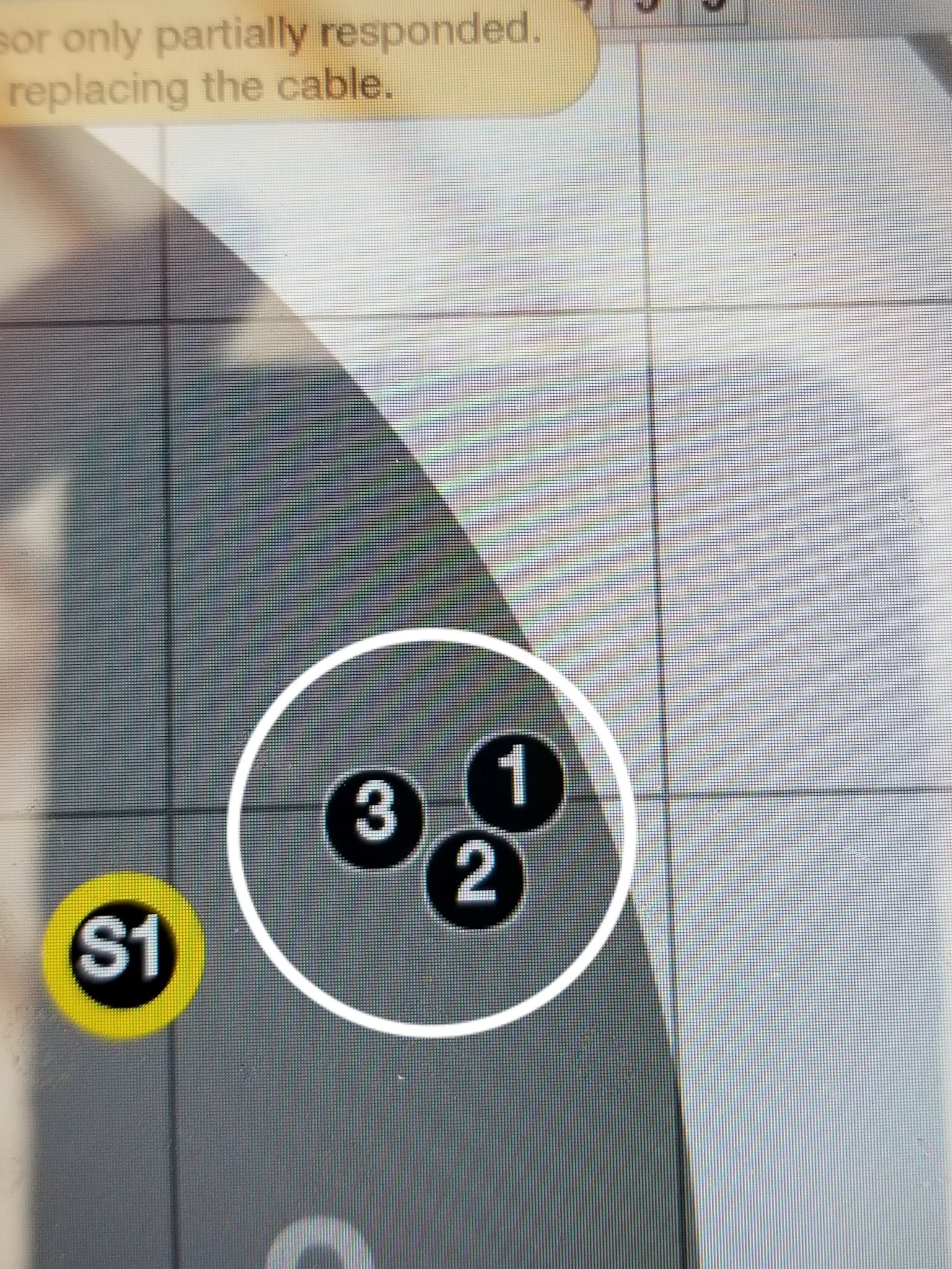

    After a few weekends of load development in my WinMag, I found a pretty decent load. 215g Bergers with 76.0g of Retumbo. Gave me a .29 MOA so far. The white circle around the group is a dime! My COAL is 3.745".... .025" jump seemed to be the magic number it liked!
