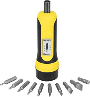

I have used a Fat Wrench for years and never any issues, also have a 1/4" drive click type conventional I use when possible.
The fix it sticks set that XLR sells I've been eyeing for a while now and may pick one up.
Go with the regular fat wrench, not the digital. Just another thing to go wrong. Mine just went haywire, now I'm going to go buy the less expensive model that doesn't beep uncontrollably at me for whatever reason. Not to mention, it doesn't stop when you get to your required torque, you have to tighten very slowly to make sure you're accurate.

I originally bought the digital fat wrench, stopped working after a couple months.
Took a chance on the regular one and have used it for a couple years with no problems.
Just when done loosen or turn the pounds down to zero, helps with preserving
the spring life.

+1 on the Wheeler Fat Wrench (non-digital). I’ve had mine for years as well. I use it quite a bit. Works great.

I have a Fat Wrench, which has served me well, but like 99.8% of the folks on here I have no way to test its accuracy. Considering the range that most ring, scope, action manufacturers give for torque I figure it is close enough.

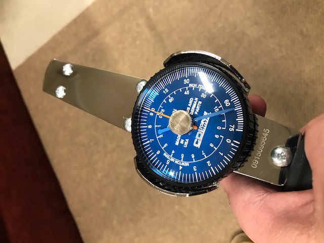

I've always had good luck with CDI; no affiliation with them or the seller but here's a great place to buy them.

Have a CDI like the one above. Think the most important thing is using with the same tool everytime
